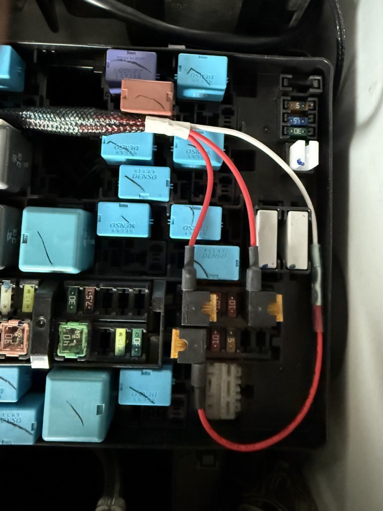

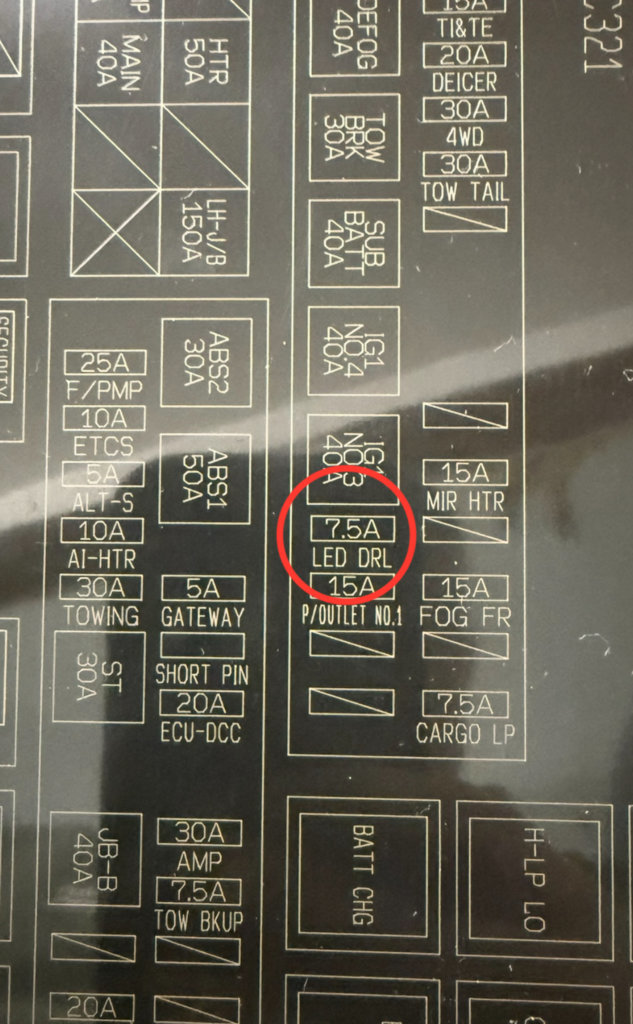

    Trying to figure out where to wire the backlight on my Baja Design 40" S8 bar light to. I'd like it to come on and off like the parking lights. I've already used the tail light circuit but it's already has an Add A Fuse, so it's not available. Started to look under the drive side engine bay fuse block and see that fuse #26 is for DRL LED. Can anyone confirm that indeed that fuse #26 is for DRL, if so I guess I can try adding a Add A Fuse circuit there. Any one have any other suggestions, thank!

    I actually did that and they still come on?

    This is the fuse I’m taking about.

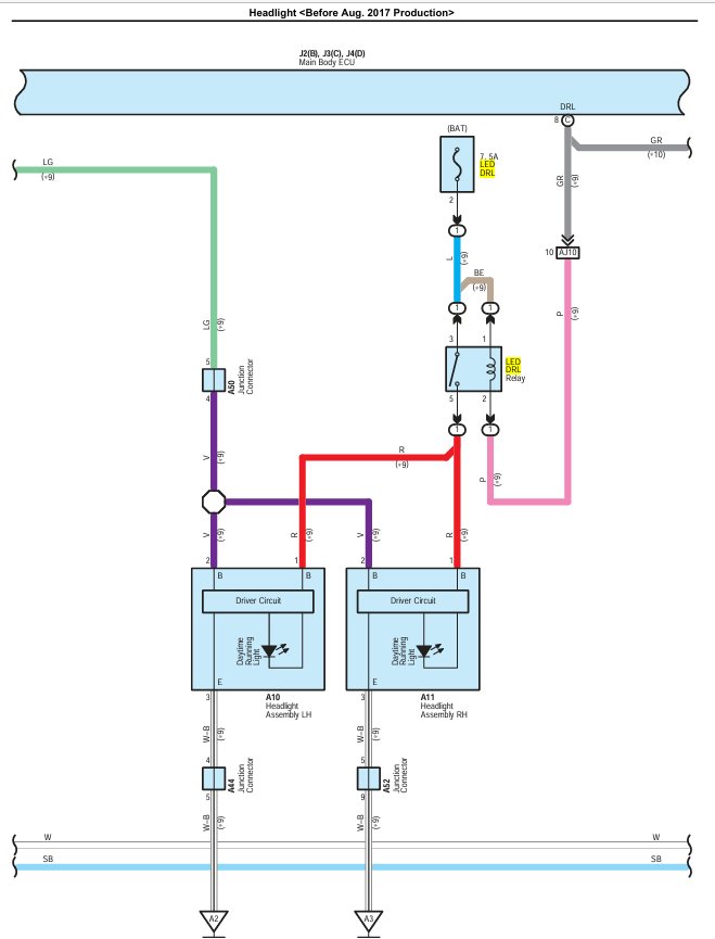

    What year is your truck and which headlights do you have, halogen, OEM LED?
    In a truck with LED DRLs the fuse is simply a BATT 'always on' connection.
    Then the ECU triggers the LED DRL relay to turn on/off the DRL lights.
    Besides that if you wired your light bar backlighting into a DRL circuit, they will only come on when the parking/headlights are off.
    Hence DAYTIME RUNNING LIGHTS..
    Let me know what kind of headlights you have and I'll try to help you more.

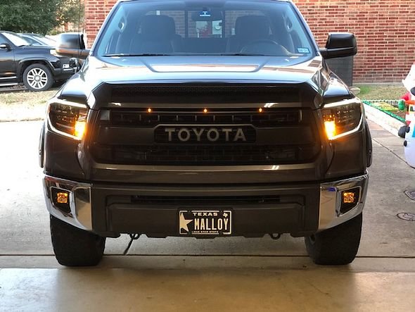

    If the draw isn't much in your backlight lighting, you could tap into the parking light circuit at the headlight.
    I did that for my TRD Pro grille lights and backlighting for my Rigid pod fog lights..

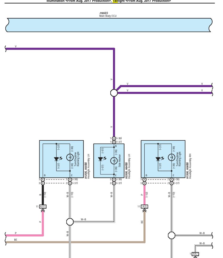

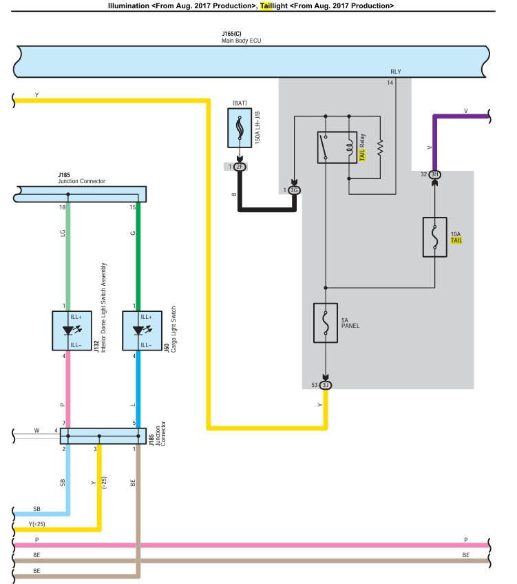

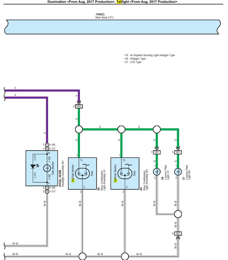

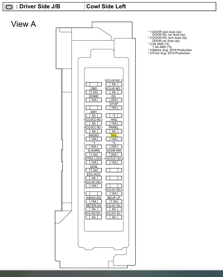

    Parking light fuse is the TAIL fuse under the dash in that fuse box.
    That circuit includes front and rear parking lights and license plate lights.
    upload_2025-3-31_14-31-47.pngupload_2025-3-31_14-32-39.pngupload_2025-3-31_14-33-2.png
