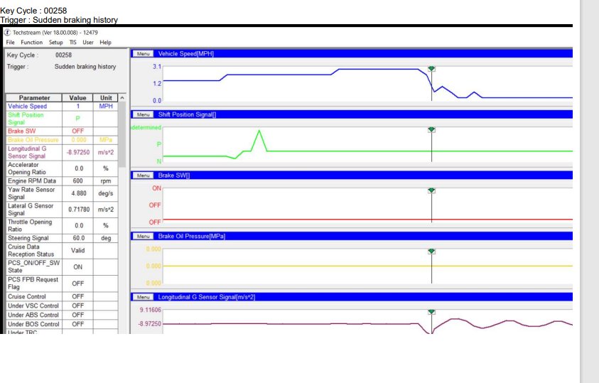

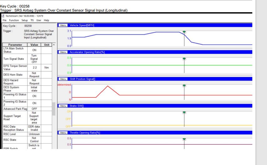

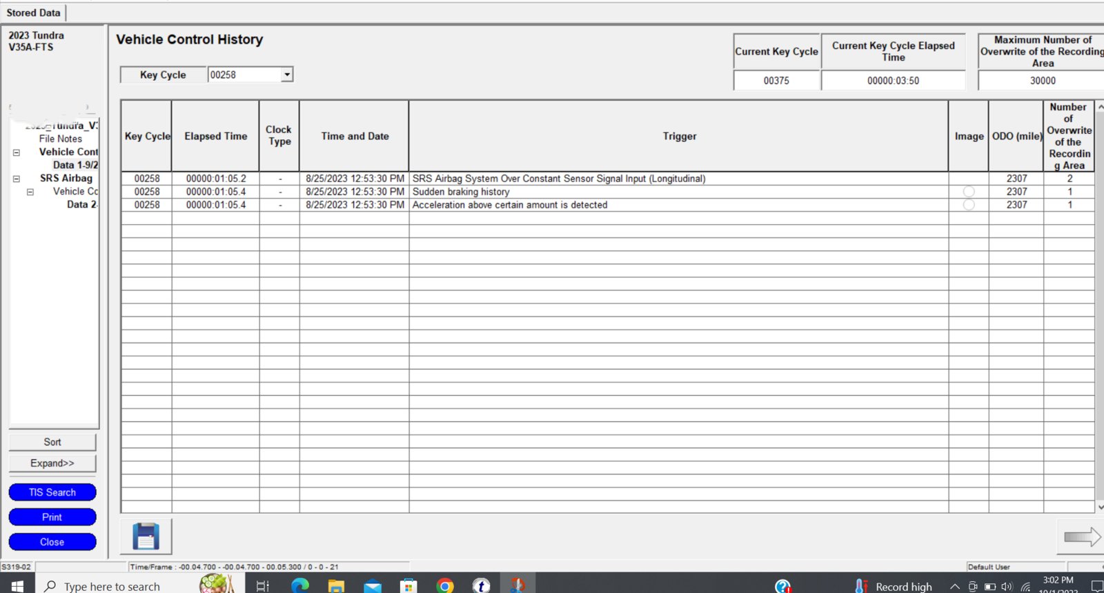

    I did end up getting a "real" interface cable along with a 2 day subscription to the real Toyota Techstream. I down loaded the Vehicle Control History, and it did show 3 events at exactly the time I had the issue.
    1) SRS Airbag System Over Constant Sensor Signal Input, 2) Sudden Braking History, and 3) Acceleration above certain amount is detected. These are essentially all at the same time. The graphs show the accelerator at zero, and the brake switch at zero. I'll dig up the graphs and upload. Also shows just before the transmission mode as undetermined.

    15,347
    Arkansas
    If it shows brake switch at zero, it’s just proving you didn’t hit the brakes.

    12
    2023 tundra crewmax 4x4 sr
    I'm sure that's how it seems. I guarantee I was stomping the brakes. So I guess the acceleration event also shows I was accelerating, even though the accelerator was not depressed....
