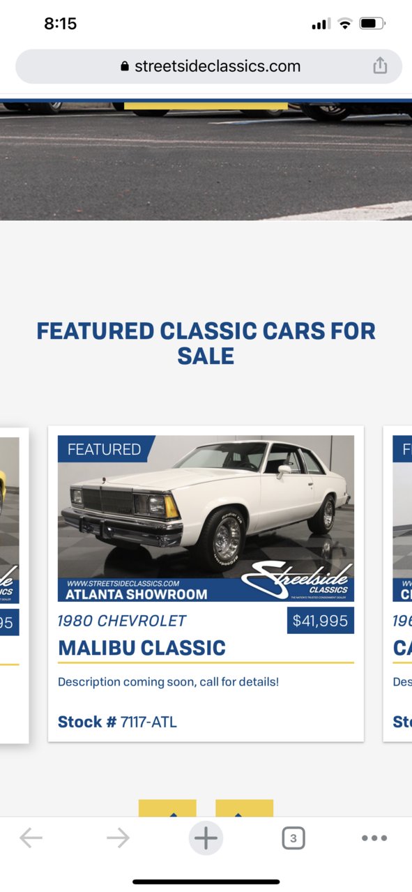

    That place wants $42k for $5k worth of g-body malibu. I'd say that tundra is a pretty good deal.

    It's ATL. Do you know how absurdly popular G-bodies are here?
    I have no doubt someone with more money than sense will get close to their price on it.

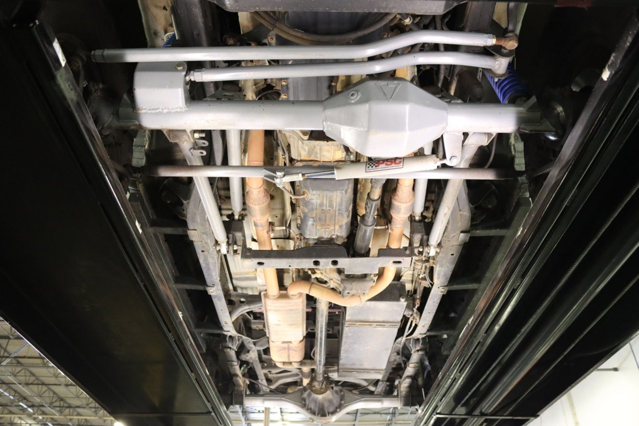

    If I got ahold of this:
    They already went through the trouble of putting glass on all four corners. Why not link the rear and do a bed cage? Get those shocks out of the danger zone and get usable flex from the rear. This is a purpose built rig tailored for more of the rock crowd. Sliders look ok and usable to protect the rockers. The back quarter panels are pretty exposed though....
    Undercarriage looks pretty clean. The ram assist is in a failure zone for rocks and you can see they attempted to limit that with the mount on the links. Probably didn't clear the transmission.

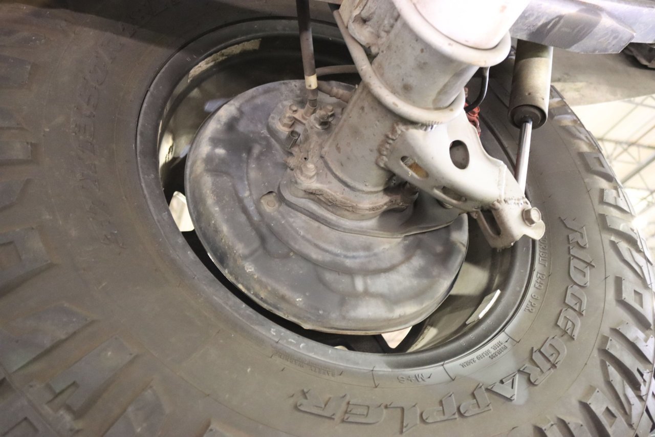

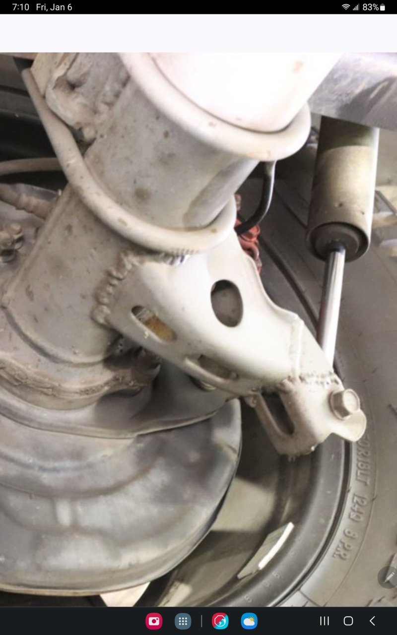

    So much booger welds on this build. I would be gouging and welding for a couple weeks. The axle shock mount ....damn. Guess they finally figured out the geometry.

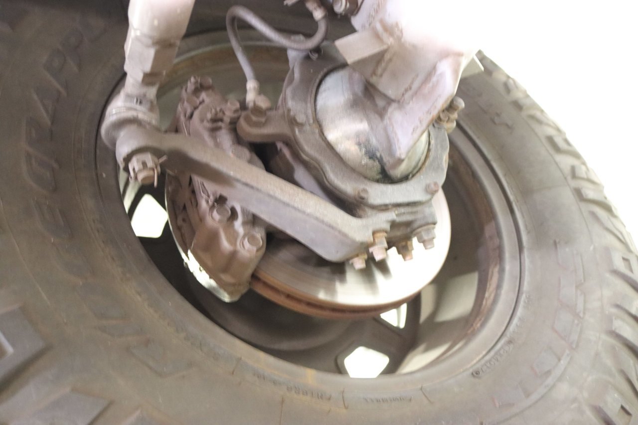

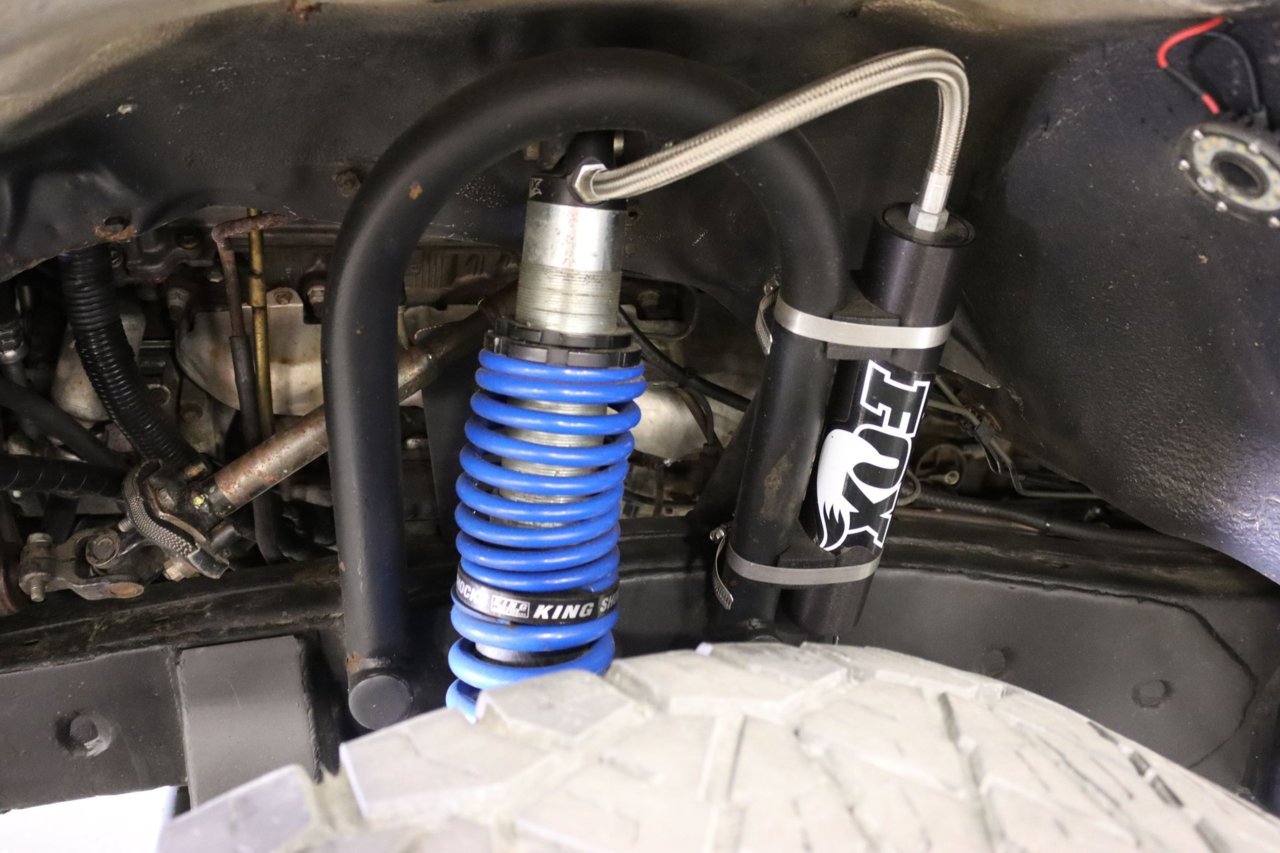

    This made me LOL. Fox shocks, King coil slider. Love that. Wrong secondary springs for this application. So plan on changing those out and can't even see if the secondary spring nuts are adjusted properly (obviously not) This probably rides like dog shit.

    Yeah those coil overs needs to be re-sprung.
    I think those are FJ-80 knuckles. So bigger than mini truck, but still use the same knuckle studs and I believe trunnion bearings.

    I remember back in the day watching a show called "trucks". Stacey David was the host. He took a long bed chevy and put a short bed on it. As long as they did a "Z" cut on it, it should be OK.
    On the other hand, seeing those shock mount welds that TJ mentioned, I doubt that it was Z cut or welded properly.
