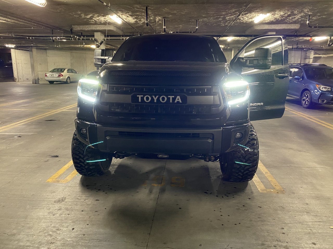

    I took advantage of free shipping via @Roman (Toyota of Cool Springs) on black friday. The upgrade was well worth every penny.
    id recommend doing the dimming option because the DRL is very bright at night.

    Lookin good there @vegas4x4 , thanks for the input.
