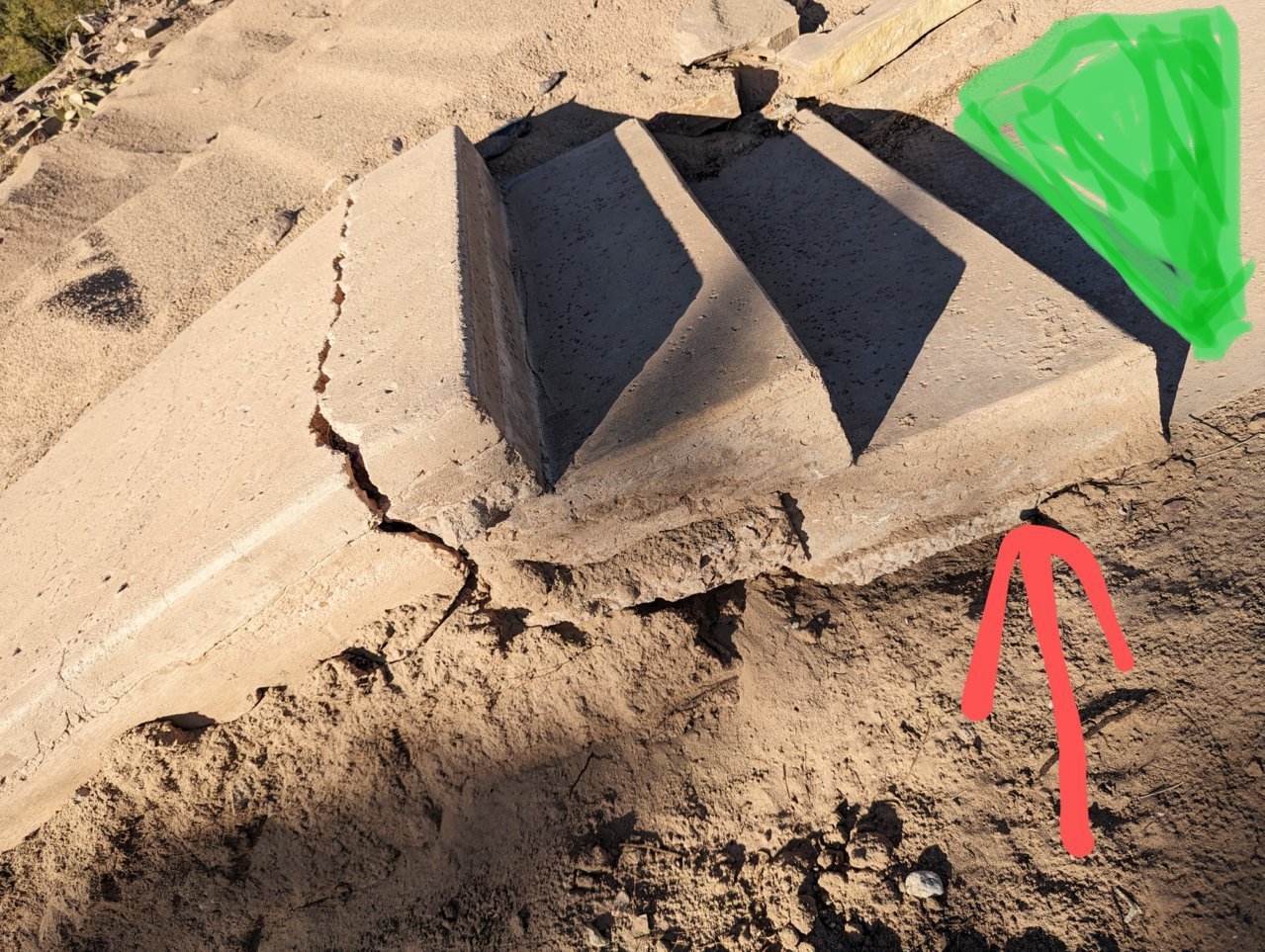

    I'm pretty handy when it comes to home improvement stuff, but for some reason this potential project has me second guessing myself. Any tips, tricks, or advice on how to fix my concrete steps that have settled over time and cracked?

    Seriously, this is not anything to fix. Bust it up into manageable sized pieces and get rid of it. Then do it right.
    Compacted fill
    Edge turn down at least 16”
    Reinforcement
    Tread edge guards

    I'm far from an expert, but that looks more like damage from erosion. My guess would be removal, correct drainage, and re-pour.

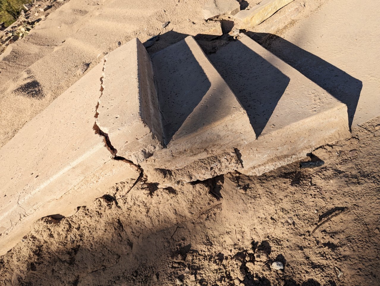

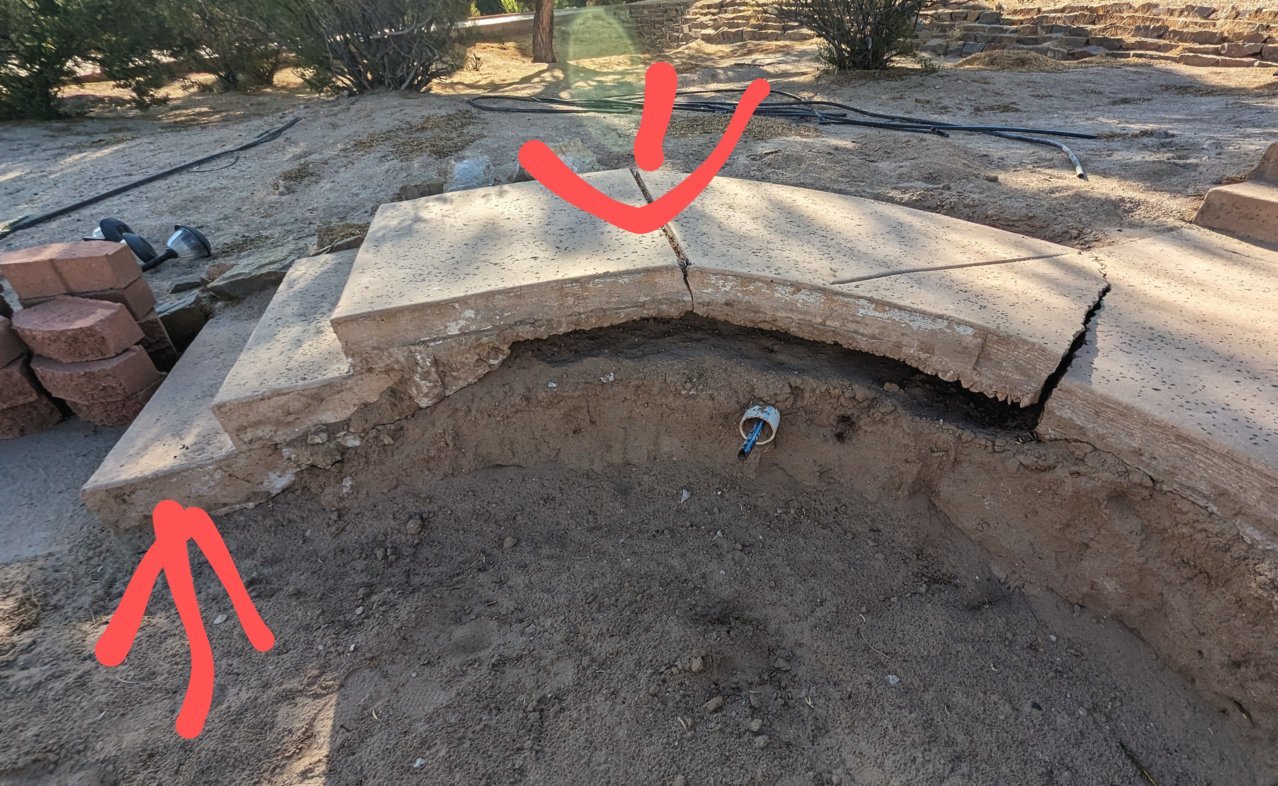

    Trying to further my knowledge not doubting you. But what makes you say this is unfixable? This damage was done over 15 years time, that's what makes me think it's not a huge deal. I'd like to know your thoughts though.
    Erosion was a bit of a factor and the drainage issue has been fixed. I removed all the dirt that filled this semi-circle to evaluate the damage. Also removed most of the dirt you see missing from underneath the concrete to get a better look if they were reinforced or hollow steps.
    I should have snapped some before pictures to paint a better picture of what truly happened. I just thought it would be a simple fix so I removed all of the dirt between the two sets of steps and the when I evaluated it that's when I got cold feet.

    I'd also recommend busting it up, compacting, and a new pour. You can make up your own forms and have a yard of concrete delivered for less than one might think. Scree with a 2x4 then get hand trowel it.

    Fair enough;
    I can see in the pictures that there is no reinforcement, no thickened edge and no “decent’ sub grade.
    You can patch it, you can slide the pieces back together, but why? You just end up with a patched, broken poorly made piece of bad work

    I appreciate your thoughts. Would it be better to talk about each set.of steps individually? Or do you think it's the same diagnosis for both? The top picture where the crack is closest to the steps looks like the easiest to fix to me. In both situations it appears to me that the steps settled/sunk/whatever you wanna call it about an inch or so at the bottom step. I went into this project thinking I could lift them up, add some support underneath (whether it be more dirt, concrete, or rock) and then set them back down. Thinking this process would eliminate/close the crack up and all that would be needed then would be a patch/seal job. The bottom picture I was thinking by lifting from the bottom step it would then have an opposite action on the middle of the slab above it and push down effectively closing the gap up top on the far right

    It’s all about the ground underneath it. It should be tightly compacted, stable, and have erosion control / drainage. Then the concrete merely becomes a veneer. Lifting and trying to fix the ground beneath it will be an exercise in futility in the long term. Removal, remediate, then redo the concrete. Not sure how long those steps have been there, but most modern concrete has fiber in it now to resist cracking and add strength. Many will not use mesh or rebar for smaller jobs like this anymore if they did before.

    I’m with the majority here; bust it up, get the fill right, pour new material.

    Take out the entire sidewalk and do the whole thing correctly or else you run the risk of fixing this piece and then when the dirt freezes and moves your going to be fixing another piece. Best to not go through the expense of renting a plate compactor, hammer drill, and having redimix delivered multiple times.

    Failed subgrade. Demo out the concrete and remove 24" of dirt below, recompact to 95% compaction with jumping jack whacker, and reform/repour steps. Put 4" of sand below the steps or base rock prior to pouring.
    Like everyone said - tear it out, do it right.

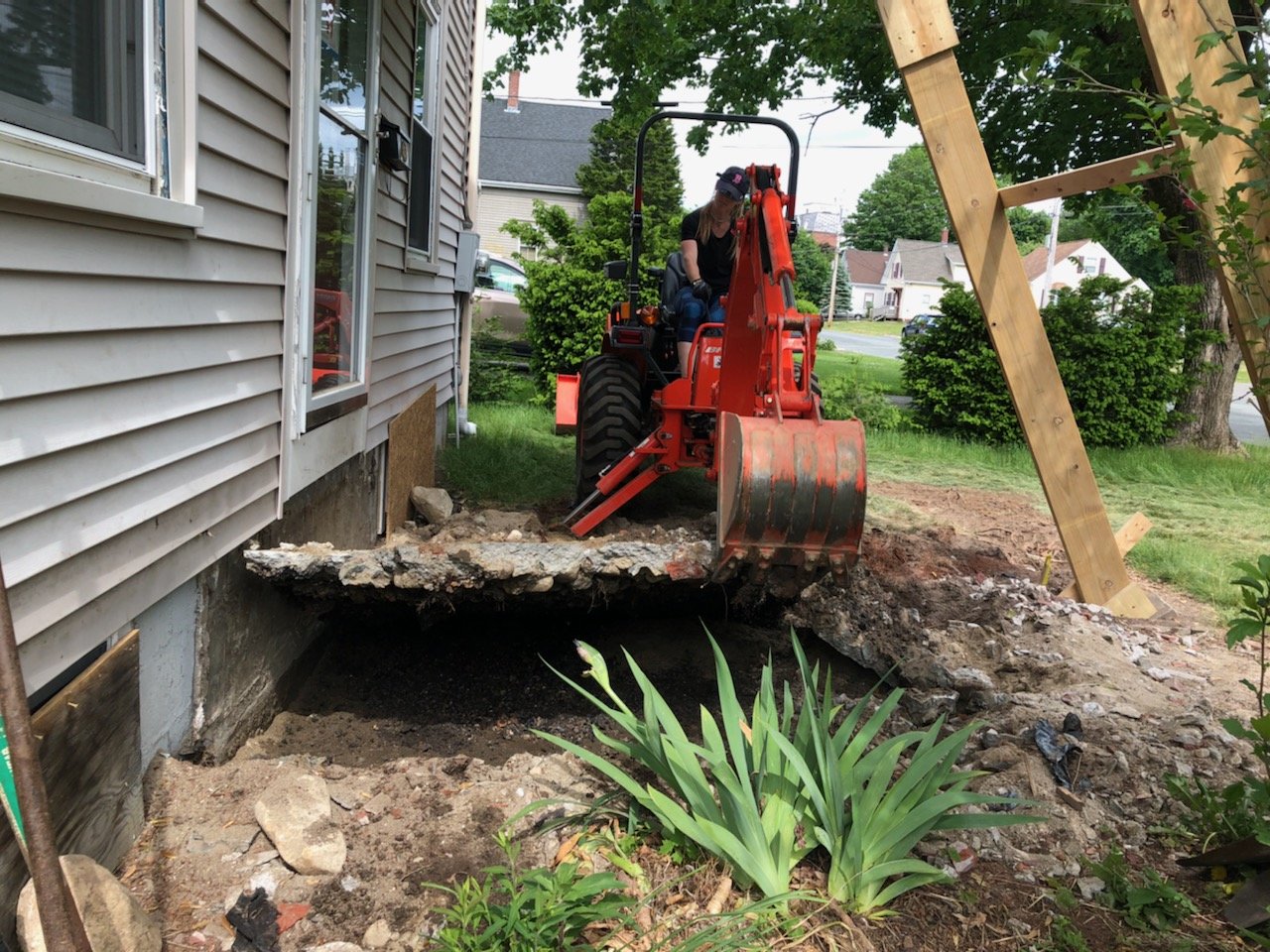

    Gonna echo chamber: rip it out and do it right.
    I helped my husband rip out his old concrete half-assed porch and slab from the prior owners that had cracked and sank towards the foundation. It was the first thing you saw walking into the house every day and we’re both builders so it was absolutely maddening. Rented a masonry saw and hacked it into managable pieces that my tractor was able to haul out.
    If youre doing a huge landscaping project having a patched uneven walk and stairs is going to most likely stick out like a hammered thumb. If youre going to do it, do it right.
