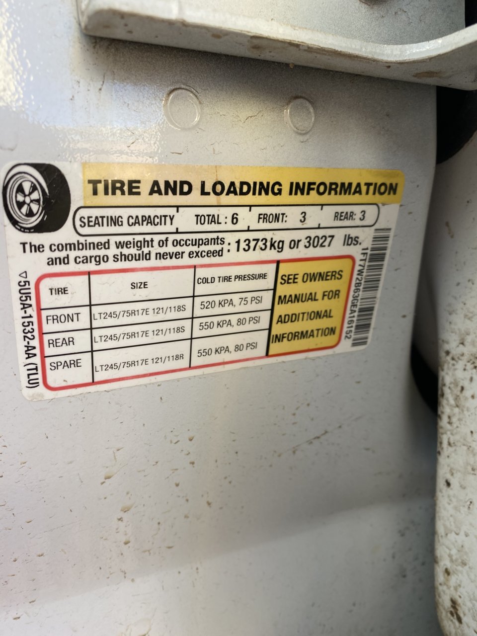

    Glad you have a tongue scale. These help out with all the calculations.
    So I have some questions:
    -What does the sticker say inside the drivers door sill say for capacity? I know the owners manual says one thing, but the sticker rating the truck is the actual capacity. The 1580 lbs sounds a little high for a CM 4x4.
    -Do you have a yellow sticker inside as well that reduces capacity for options? Toyota is good about that.

    You are looking for this sticker for the capacity rating:
    This one is for my 2015 F250 CC work truck. The capacity of this truck is 3027 lbs.

    mine says 1520
    I’m assuming I have to factor in the fuel too... still exact. Lol.

    That is pretty good for a CM. Most are a bit lower than that. Take a picture of it and post it.
