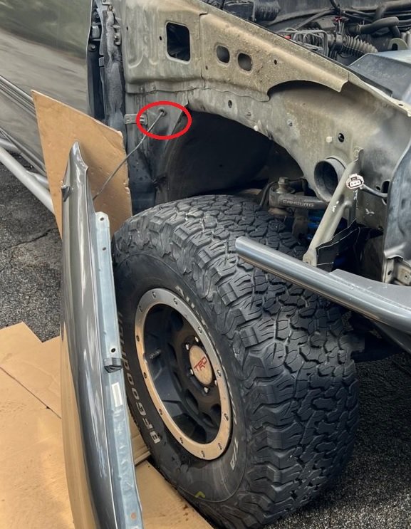

    Not much help but when removing previous owners CB radio antenna, the trucks radio antenna was accessed by removing radio as @tvpierce mentioned. Then further access was via glovebox removal and it then heads thru firewall in the finder area, circled below.
