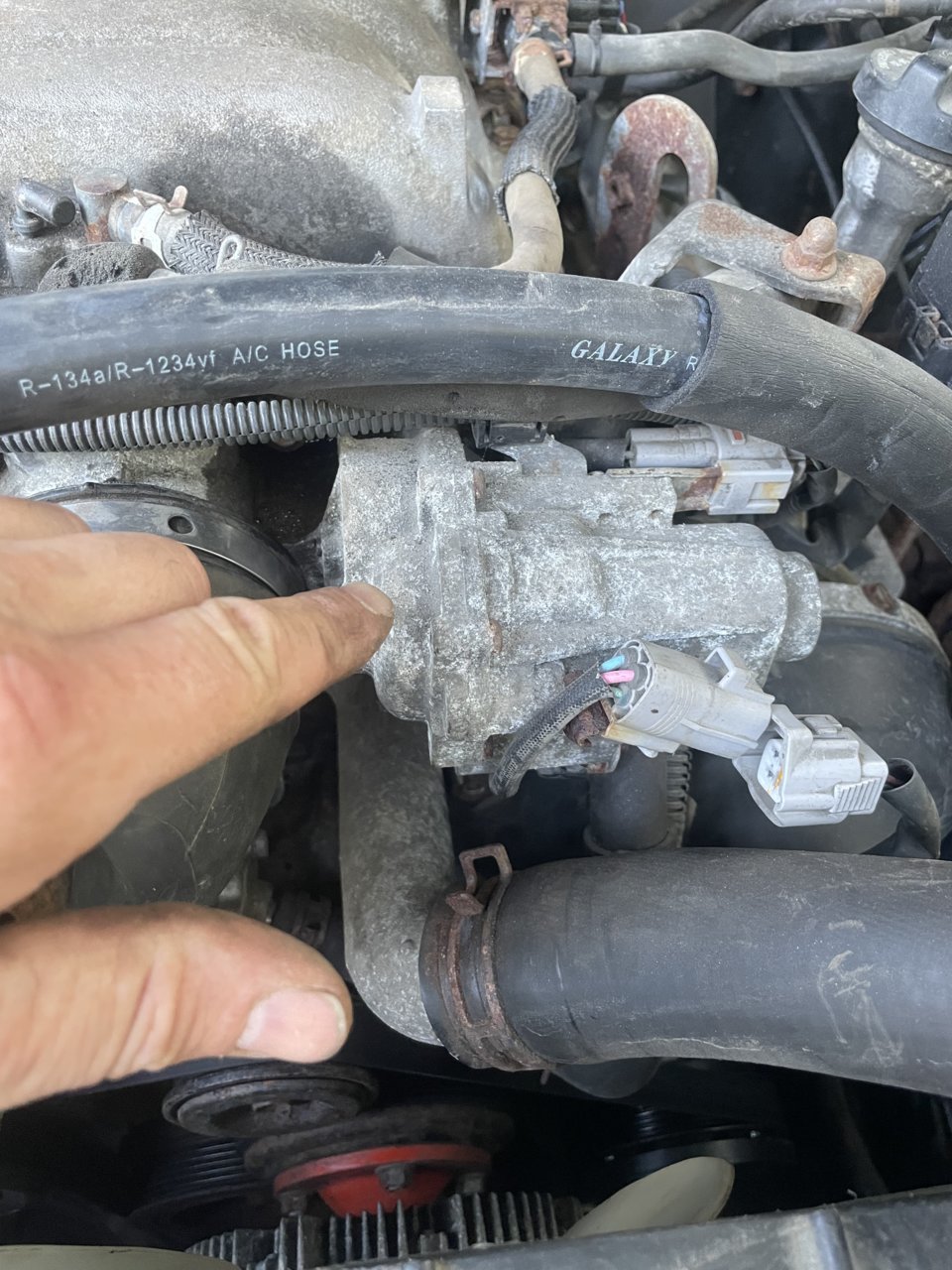

    This think is making a whine noise after it stalls out with the key in the on position, stops when I unplug this plug

    Jake that item your pointing to on post 8 is the throttle body motor or actuator. Perhaps it is starting to go on ya. It's part of the throttle body assembly. The motor inside can be replaced. RockAuto has 2 different models but they are not cheap. I have found a video for a cleaning process that might get you by. Good luck.

    thanks, it doesn't make the noise anymore with the new fuel pump.
