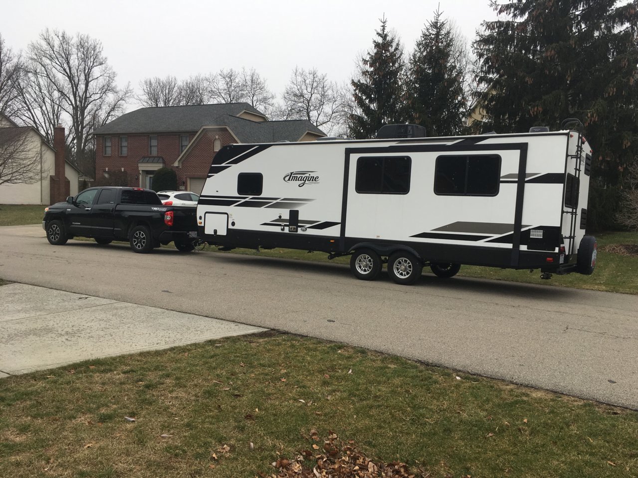

    I am pulling a 32' TT with a GVWR of 8500 lbs (current actual 7800 lbs) and a claimed hitch weight of 726 lbs as built/680 lbs per the sales literature (current actual 1,000 lbs). I have LRE tires on the Tundra and the trailer and, as Chad said, it helped a lot. I am running RAS instead of air bags which also helped and am using an Equalizer 4 point WDH. I am careful with the loading of the trailer, don't haul much of anything in the truck besides my wife and I and the two dogs and maintain my speed at 60-65mph max. Have towed over 8,000 miles on some very long trips with significant grades and I'm happy with the performance. Strong, gusting cross-winds can be a challenge (think west Texas). I plan my travel times to avoid the worst of it and reduce speed. So it can be done safely but you need to manage the details.
    EDIT: I didn't think to mention it but I always run with all tanks empty. If all tanks were full, that would add another 1500 lbs.

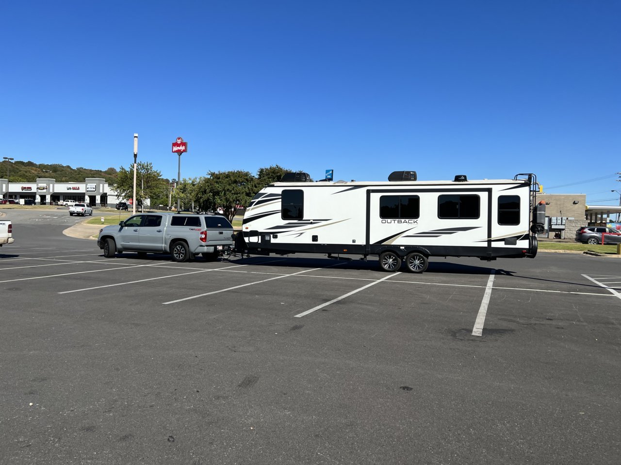

    Just gonna drop this here:

    You ever pull that thing through the mountains out West? How does your truck handle it?

    Pulled it up and down Petit Jean mountain here (mountain is a stretch, maybe 1000' of climb) pretty steep and windy. Truck did great, better than my buddy's 5.3 GMC which really struggled to pull his trailer of similar size. Braking was good too with engine braking and trailer brakes adjusted. No serious out west mountain ranges, wouldn't have bought this truck for this trailer, or this trailer for this truck if that was my use case.

    What you say is true for many people that don't have the inclination or ability to understand and manage the details, however, blanket statements like this don't help anybody. Why? Because someone else will always say....."Hell yes, you are good to go!" Again, without providing any detail or context. We need to help people understand the implications of what they are proposing and the resulting limitations. Just saying it's against policy or the famous "you'll be over payload" doesn't clarify anything. They already know that. They are looking for practical reasons why it won't work.

    I take the CAT scale weights and verify rear axle against max. Regarding brakes, when you are towing a heavy load, you need to downshift when appropriate and approach the grade at the correct speed. If you are going downhill with your foot riding the brake, that's a problem. Your brakes will be smoking at the bottom. I also keep a close eye on my pads, rotors and fluid from a maintenance viewpoint. If you aren't into that, you definitely need a bigger truck. In fact, there might not be a truck big enough.

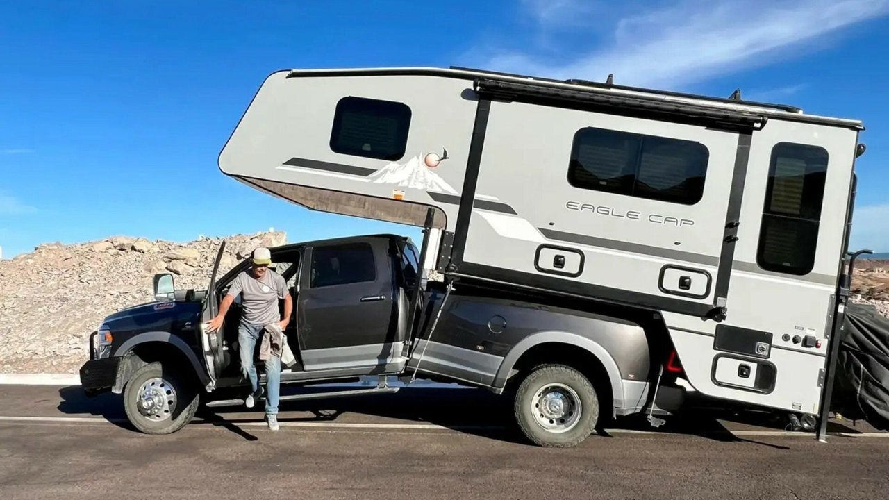

    Here's your clarification on "you'll be over payload." He had 25000 "trouble free" miles until he didn't. It won't be obvious or glaring, and that's how everybody justifies it. Doesn't help you when the bill for going beyond the posted limitations of the vehicle comes due.
    That's a dually one ton, and he was over payload.

    Yes, I've seen that picture on the interweb....haven't talked to anybody that knew this guy. What are the details?

    This scenario gives me so many more questions than answers. Exactly what truck was this camper made for?? And what's up with a 5th wheel trailer without wheels in the bed of a truck? I read the story, If there's a model of that truck with that payload rating, it likely rides on the same or similar frame setup. His featured truck has eaten his payload up and he is likely as much as 1000# over. But his frame broke at the fulcrum point after off-road driving this bo-hemeth likely inducing more dynamic load and stress than on-road use would have. Again, this is an extreme setup, did not drive it smart. Just assumed he was good with the numbers (He wasn't as he used the advertised and not his door sticker) and sent it. IT'S BACK THERE PEOPLE!!! Don't pretend it's not.
