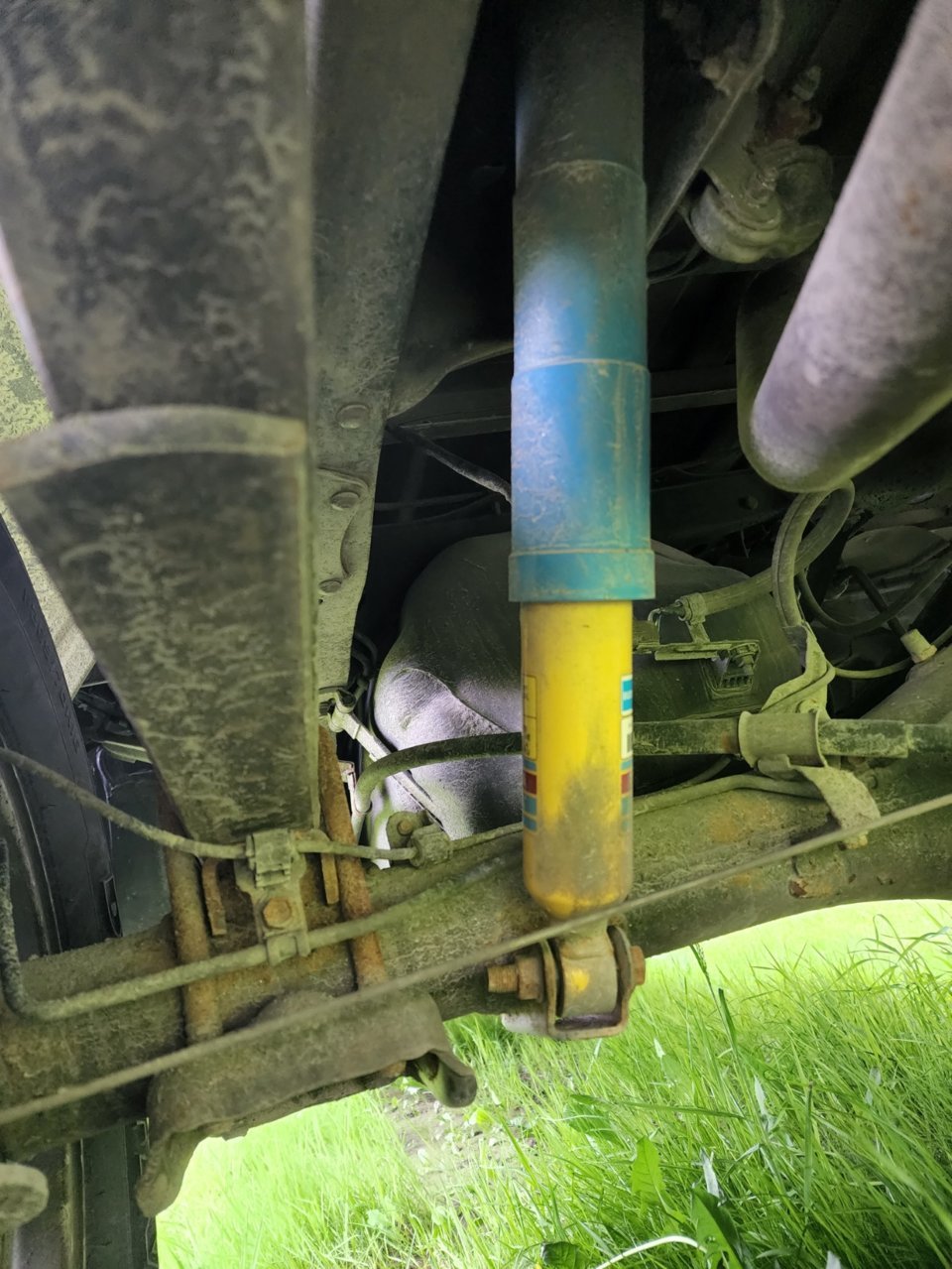

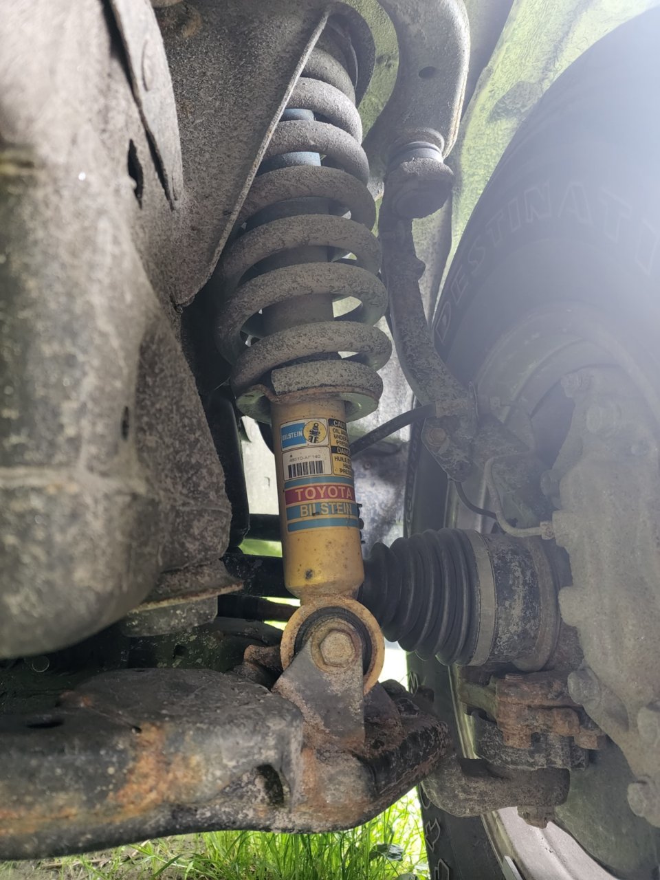

    @tdrich7 do you have a picture of what's on the truck now?

    @NickB_01TRD Here's some pictures of what's currently there

    If those were put on in 2015 then they should be in great shape. Though I'm not sure they were. Unless the dealer had some sitting around for 10 years I doubt new bilstein shocks for a first gen would still have Toyota stamped on them. Think that was just an OEM thing. I could be wrong though. We're you the one that had them switched out previously or was it PO?
    If your truck is a TRD then that means you have the TRD coil springs in the front which is good.
    If you think these are too rough/stiff I definently wouldn't go with 5100's as they are stiffer. If you're just wanting to try something new for the heck of it I'd just go with another set of 4600's and roll with it. Otherwise I'm not sure of a great brand suggestion that would be less stiff but also not cheap crap.

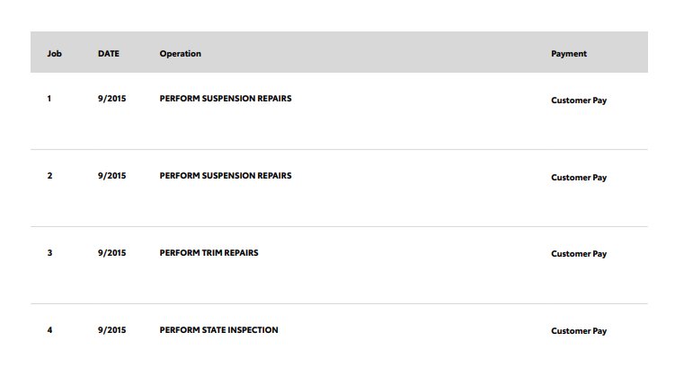

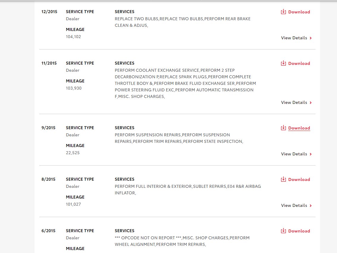

    Well, this is interesting. I swear I had gotten the information that they had been replaced from the Toyota service history using the website feature. I have a whole Excel sheet typed up with the service history of the truck, based on both that and the Carfax provided when I bought it. Unfortunately that Carfax was texted to me in screenshots, and I have since replaced my phone, with my text history falling just outside of that range. I know for a fact I had referenced part #s which came up as OEM Bilstein shocks, but I can't seem to find the same information now. And for some reason the service showing up as suspension repairs on 9/2015 (exact month/year I have written down) is showing up as having been done at 22k miles (which doesn't make sense either). Here's screenshots of what is showing on the Toyota service history website. I'm not sure what's going on but I know in the past I was able to see more details on the website/PDF downloads than this, such as the part numbers listed in the details by the dealer. Perhaps a call to the dealership this was serviced at could clear this up, but it still seems most likely to me that 4 struts were replaced in September of 2015 based on the year/date, my notes, and the list of 2 suspension repairs (front/back?).
  12. Jun 10, 2022 at 9:06 PM
    tdrich7
    tdrich7 [OP] New Member
    Apr 11, 2021
    #61659
    87
    2006 Tundra DC 4wd SR5
    Then again I'm now realizing I had struts/shocked listed as being replaced two different times within 3k miles of each other so something screwy may have been going on from the start. There is nothing corresponding to the 6/6/15 date in the Toyota service history other than this: "*** OPCODE NOT ON REPORT ***,MISC. SHOP CHARGES,PERFORM WHEEL ALIGNMENT,PERFORM TRIM REPAIRS,"
    6/6/2015 99,289 Shock Absorbers/Struts Replaced
    6/6/2015 99,289 Wheel Alignment Done
    8/15/2015 101,027 Airbag replaced
    9/30/2015 102,254 All 4 Front and Rear Shock Absorbers Replaced (OEM Toyota Bilstein)
    11/21/2015 103,930 Spark Plugs Replaced
    11/21/2015 103,930 Trans, Brake, Coolant, Power Steering Fluids
    12/3/2015 104,102 Rear Brakes Cleaned and Adjusted

    Your pictures of the front shocks show the lower shock mount bolt in the opposite direction of how they are installed at the factory. Usually the nut is on the front side and the bolt goes in from back to front. It seems a lot of people have trouble replacing the bolt in that orientation and just replace it from front to back without any issues. That alone tells me they may have been replaced at some time in the past

  15. Jun 11, 2022 at 3:33 PM
    NickB_01TRD
    Jun 16, 2021
    #64346
    2,701
    Nick
    KY
    01 Tundra V8 4X4 AC SR5 TRD
    Good eye! Think you're right
