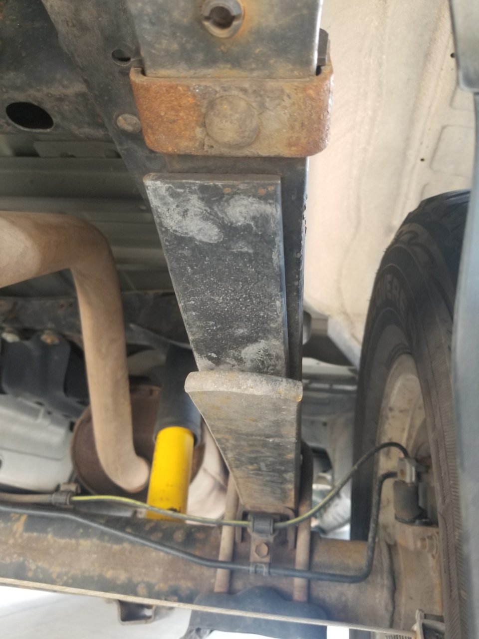

    OME shocks with a low lift (883) coil up front, and I recently added AALs in the rear. The AAL on only the passenger side works its way out of alignment with the leaf pack (see picture). I've tried resetting it and re-torquing the u bolts, but it has returned to the same location. Not sure if this is related to shimmy issue but its worth mentioning
