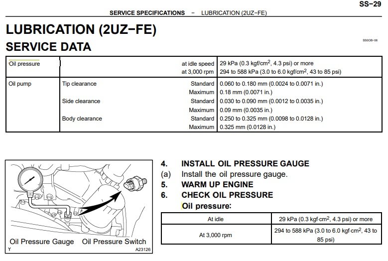

    IMHO, your simply seeing normal oil pressure numbers. The FSM shows the below readings one should expect @ idle and increased RPM's
    You could also consider installing a pressure gauge for testing if you question what you're seeing.

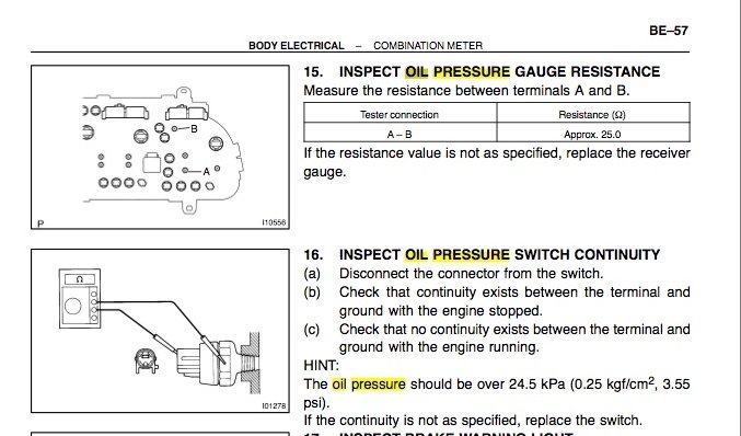

    I've been trying to locate exactly that info in the version of the FSM that I have and can't. Last year, before I swapped out my sender, I did see a pdf of that page and remember testing mine. I'd definitely be grateful if anyone could post that info.
    Other option is to go swap it at my local NAPA since it is still under the 12 month warranty.
    edit: found it. Attached to the combination meter. Just a simple continuity test at the sender end though.
