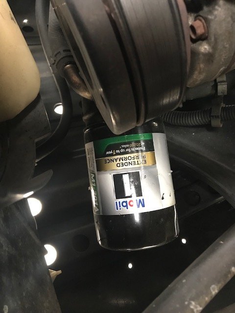

    I'm using Mobil 1 synthetic with a Mobil 1 oil filter (M1-301A) which is twice the size of the oem filter.
