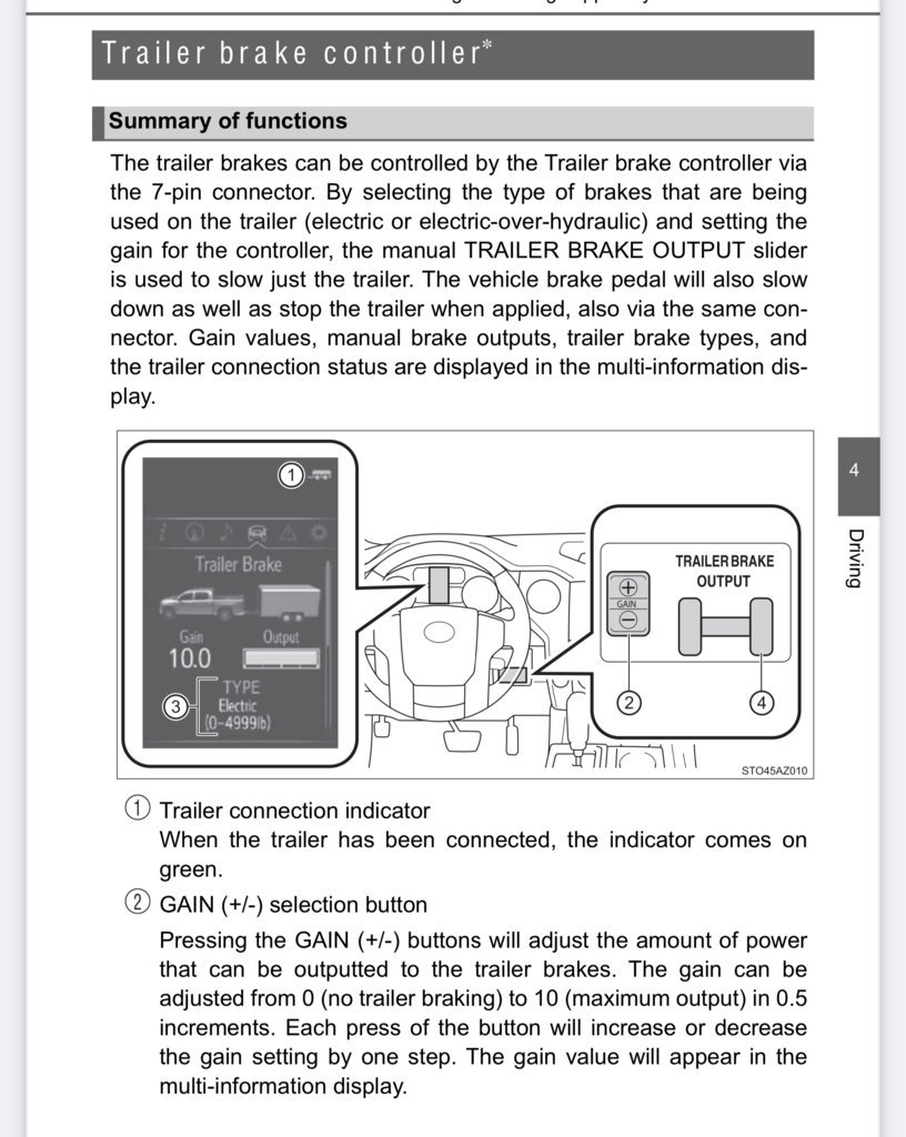

    I have a 2021 Limited and tow a travel trailer that weighs around 7k, I can't seem to figure out how to change the setting for electric brakes from 4999 to 5000+ anybody know how to do this ? The manual was not helpful.

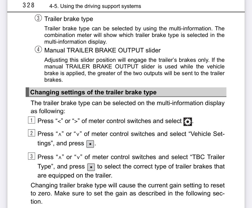

    Use the steering wheel controls and select the gear icon. In park, engine on.

    ^^^ what he posted
