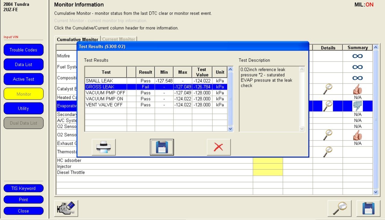

    What makes me scratch my head is the techstream data and if anyone could shine a light on what is going on here I'd be grateful:
    To me it seems that (a) a GROSS LEAK test value could mean a leak just about anywhere. And (b) the -128.000 kpa test values showing PASS seem a little odd. Presumably the test value is the value the system got about pressure during the test. Am I getting that right? Which leads me also to (c) the fact that the difference between the GROSS LEAK threshold and my result is something like .04 psi. What kind of insane person created a system so sensitive to hang underneath a damn truck?

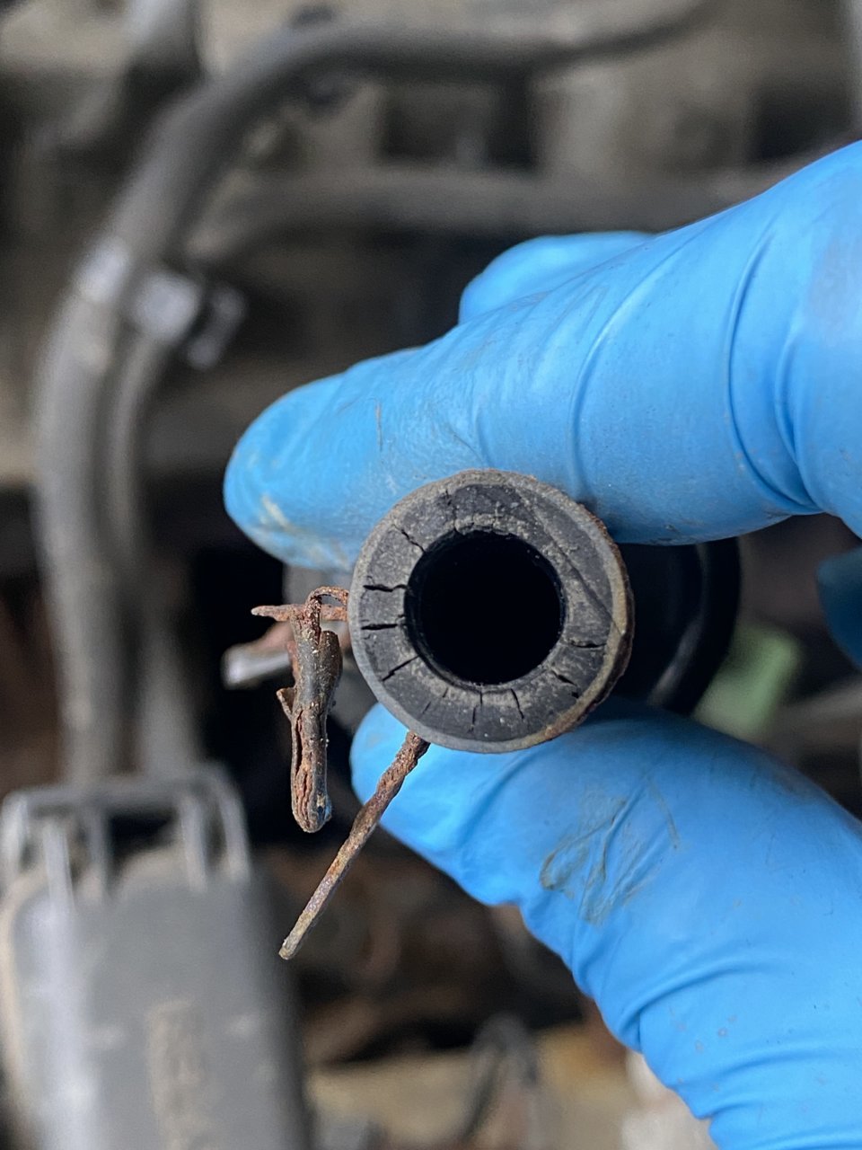

    Yeah, I ordered a $30 version off Amazon. This fluttering goes on for a lot longer than 5-10 reps. Who knows, could be fine. I sure can't find anything else obviously wrong with various hoses though. A few that look like the below, but I bet that can hold the ~18 psi the system needs and I'm not getting a leak code.
