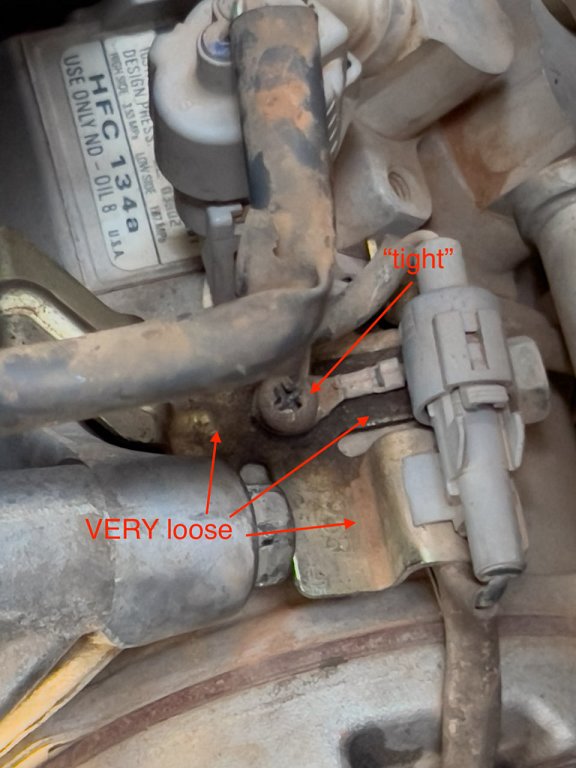

    Not necessarily. Soem folks on here had a flashing light like that because the ground/its plate I'm circling here was loose; someone reinstalled the wrong length after doing the timing belt, and the plate didn't sit flush and create proper ground. Basically the "very loose" plate was the issue, because the "tight" bolt was too long.
    But @KNABORES is right, you really should hit a well-rated HVAC specialty shop and have them diagnose. Others on here have stated their light was flashign due to over-pressurization and under-pressurization. A/C is difficult to diagnose on your own unless you have and know how to use gauges.

    I don't have a panned out picture and not in a place to shoot a pic. Note the "143a" coolant sticker on the compressor. Note to the right of that in the photo, the larger multi-wire harness. Also, the "ht" in the word "tight" is on top of another 2-wire or 3-wire connector. Chase the wires to the compressor, and you'll find this, if it's the same setup on your truck.
