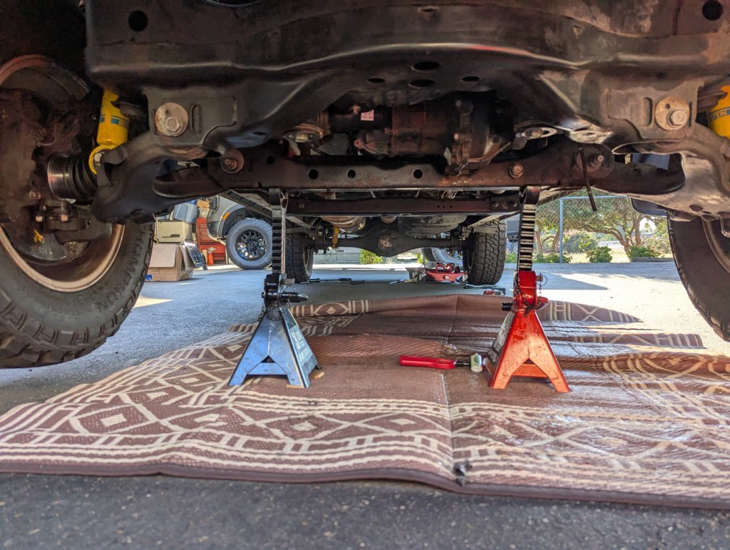

    Anyway, it was a long term goal of mine with this truck to be able to do some offroading and maybe rock crawling so I set my sights on a 4wd conversion. The process took five days for me personally, about 8 hours a day but someone more skilled than I could do it in probably just a weekend. For some background info I just started working on cars last year after paying mechanics my whole life. No lift although it would be nice, jack stands are all you need for this.

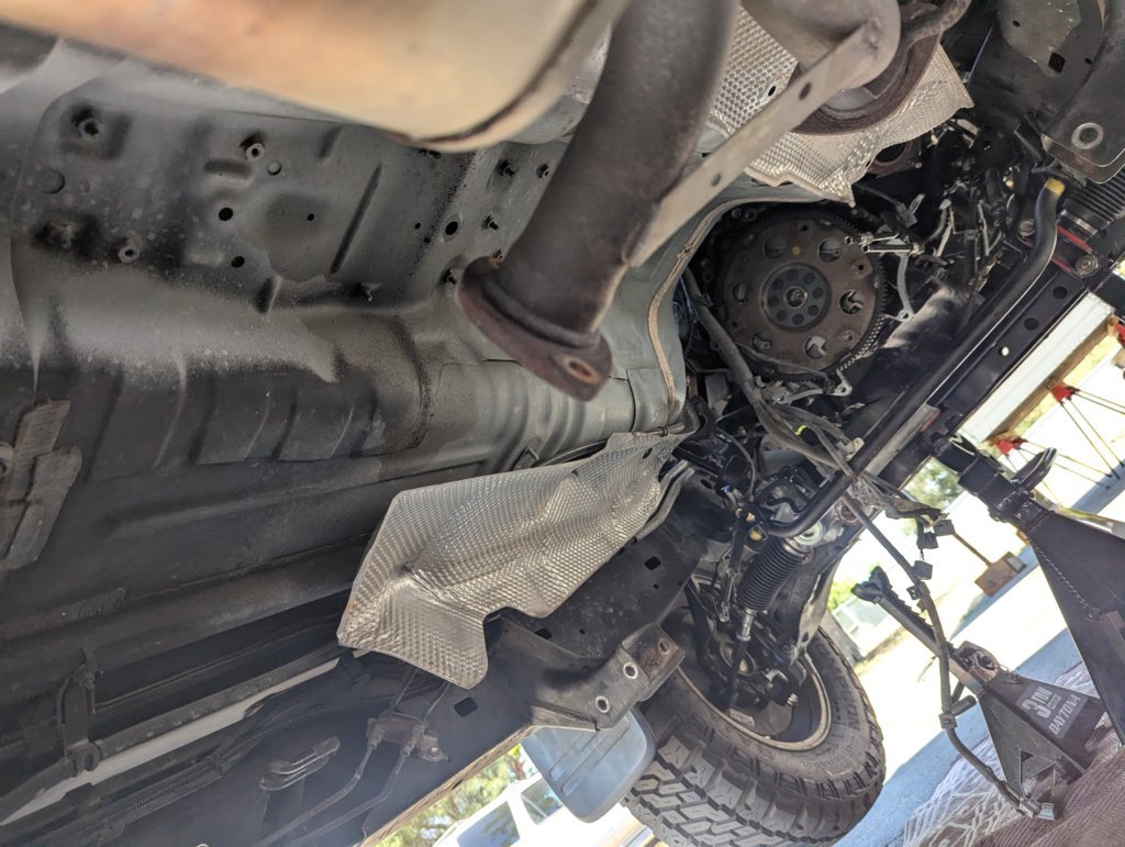

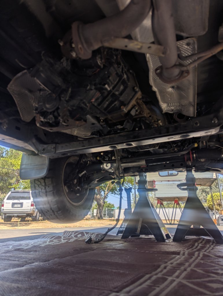

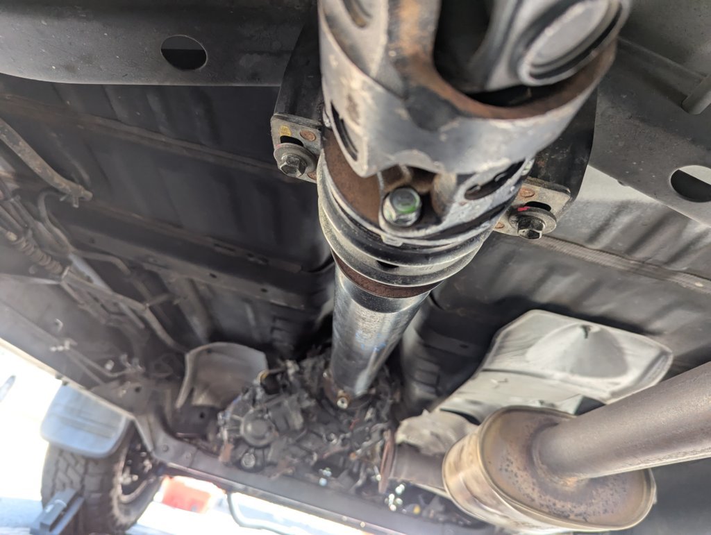

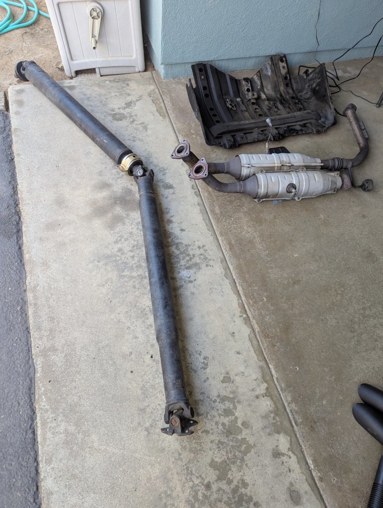

    Step 2: Drop l&r exhaust pipe, remove rear driveshaft and skid plate.
    • Pretty straight forward (if you don't live in the rust belt I guess), definitely want to soak the bolts/nuts in rust penetrant beforehand. I was lucky enough to not need a torch but I did snap two studs on the exhaust. Just follow FSM procedures for this and the driveshaft. Only thing I'd say is try to only use hand tools on the exhaust hardware, at least mine was super brittle.PXL_20250811_204517546.jpg

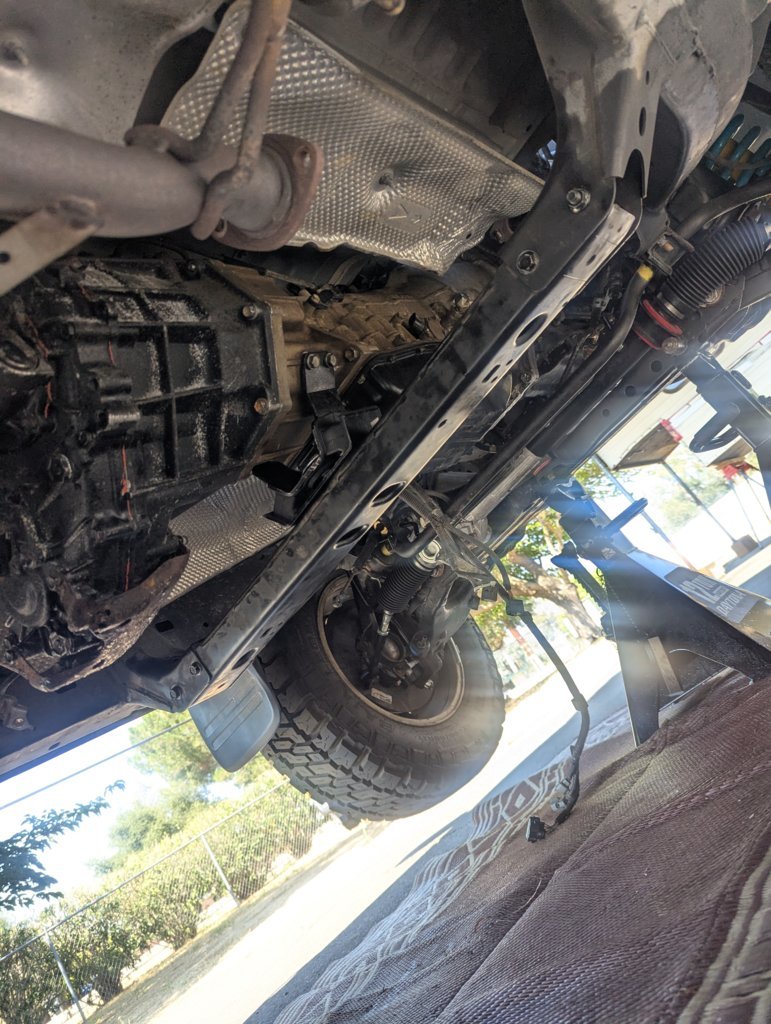

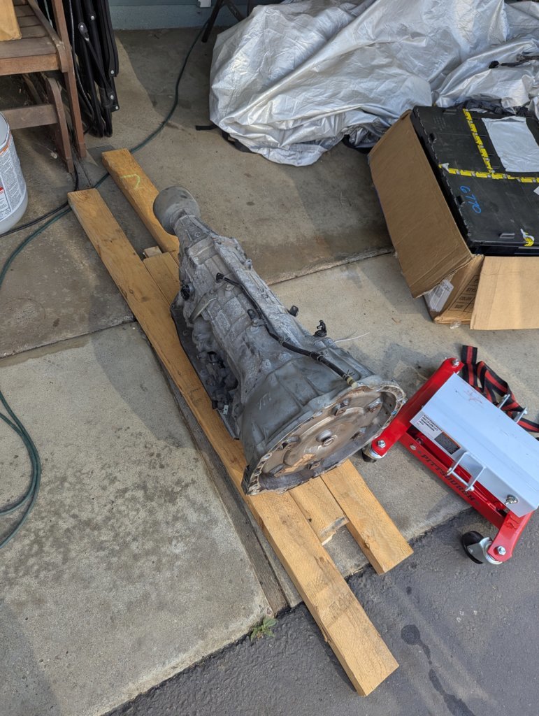

    Step 3: Pull A750e and install A750f and transfer case, don't forget new trans mount too.
    • I did this before the front diff on the recommendation of mrdirtjumper. Was the first transmission I pulled/installed. Honestly not too bad but you definitely want a dedicated transmission jack. Not sure how you would do it without it. Transfer case has to go in at an odd angle the jack doesn't like (or rather gravity doesn't like) your only option here is to pick it up and lift it onto the extension housing (if you didn't install it to the transmission in the first place like me anyway).

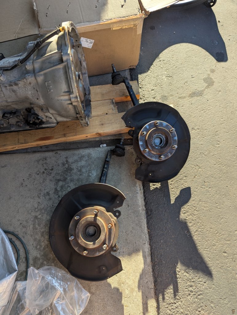

    Step 4: Install front diff, then swap knuckles for 4wd ones, then CV axles can go in. Lastly do the front driveshaft.
    • Front diff was harder than I expected to get in. Maybe a skill issue. Had tremendous difficulty with the rear mount, for some reason the stud spins on my brand new one around the nut. Can't find a place to hold the stud, as it's recessed so I've just accepted it for now .Definitely do new OEM upper ball joints with the 4wd knuckles. Currently on TRQ cv axles and will spring for OEM when they inevitably shit the bed. I noticed a little too late that my front diff has some dirt compacted on the inside. I wish I tore it apart and cleaned it but it was already in and I didn't really want to pull.it again. Hoping a few drain and fills will get the debris out. Part was from an AZ junkyard.

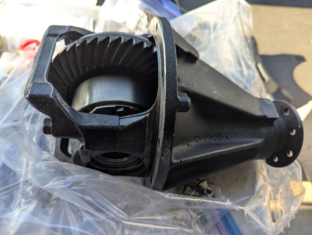

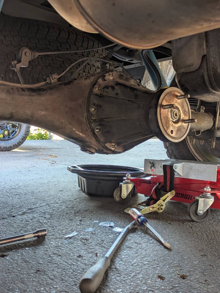

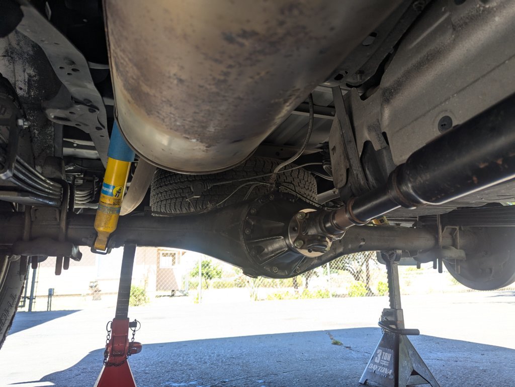

    Step 5: Install new 3rd member, then rear drive shaft.
    • Easiest part of the job for me. Drive shaft didn't have match marks (thanks scrapyard) so I just kind of put it together in a way that made sense and it works good so far, little to no vibration introduced. I got the rear diff built by ECGS, because my previous rwd one didn't have a gear ratio that matched the front diff (of 3.91). New rear diff has a locker that I'm excited to try.PXL_20250815_010519119.jpg PXL_20250815_010526410.jpg PXL_20250815_011656320.jpg PXL_20250815_184447921.jpgPXL_20250815_184454610.jpg

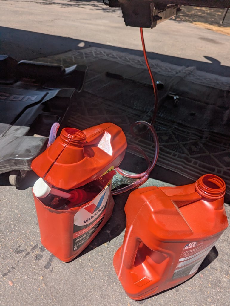

    Step 6: Fill everything with fluid, reinstall exhaust and skid plate.
    • Opted for Lucas dino juice in the diffs/t case and Valvoline max life ATF instead of WS after speaking to a few people at a transmission shop. Was way cheaper than WS too. Sadly one of my studs is kaput and will need replacing. Currently right hand exhaust pipe is held up by 2 nuts instead of 3, but no exhaust leak yet. Will definitely fix soon.

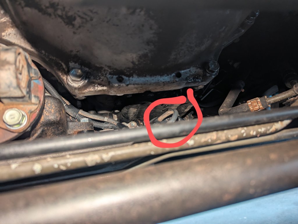

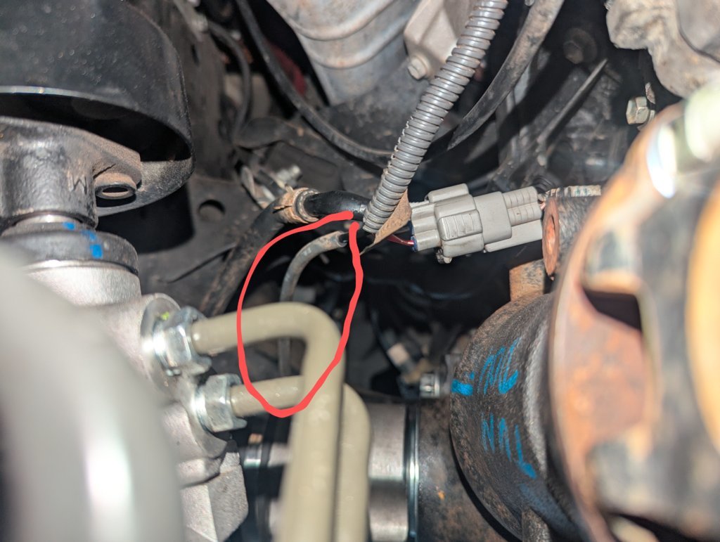

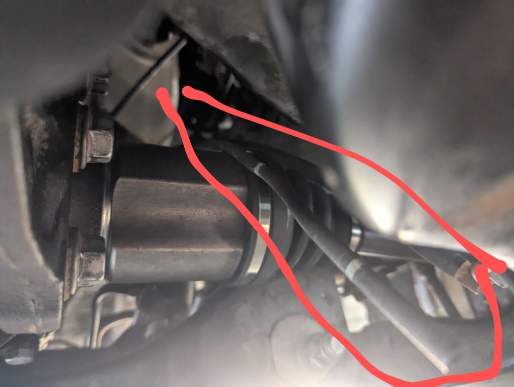

    I did have a question for members of this forum, does anyone know where the thin breather hose from the front diff is supposed to plug into? Currently it's doing a good job of dangling above my driver CV axle.
    whodatschrome likes this.

    I saw the plugged one resides below the brake booster in some picture but it looks like the smaller one should be plugged into... something. Somewhere. I'm yet to find that somewhere.

    Thank you. That solves the problem of the thicker one with a plug. However I am still unsure where the thinner one plugs into. Any ideas? It originates from the front diff. Pics attached.

    Not sure on that, can't tell what it is, but it shouldn't be sitting on the CV axle like that. In the 1st pics, is it plugging into the actuator? I can't tell what the round cap is that it's touching.
