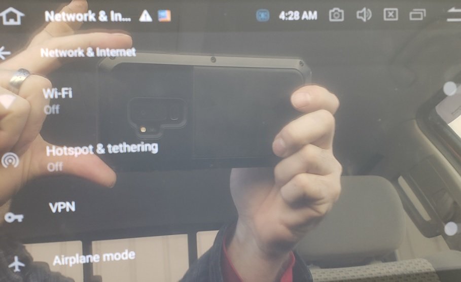

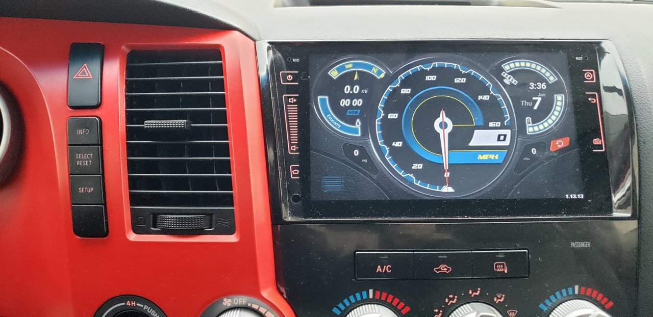

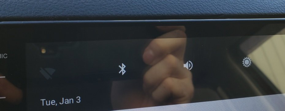

    I have a Secaine Android 8 headunit. Its the 4gb x 64gb octacore unit for the 2nd gen tundra. It has been great for almost 2 years with absolutly no issues. I use my phone hot spot to wifi to the headunit for internet. I turn on hot spot on phone and press wifi and wala. 4 days ago the wifi button would not turn on. i click it and it goes imediatly back to off. So i tried a few things. reset network settings tried to connect= nogo. disconnected battery for 2 minutes to allow discharge=no go. So then i tried to usb and bluetooth teather = no go. Radio will connect via bluetooth and usb but no hotspot from phone.
    i am thinking that the internal modem in the radio is dead as it acts as the network adapter.
    I have ask around if the usb modem and router dongles will work around this issue. I DO NOT want a sim card for the radio especially1.jpg 2.jpg when i have the phone that used to work. But im thinking or maybe hoping that it could act as the network adapter and allow me to hot spot the phone to it and fix the issue.
    Help Guys..
