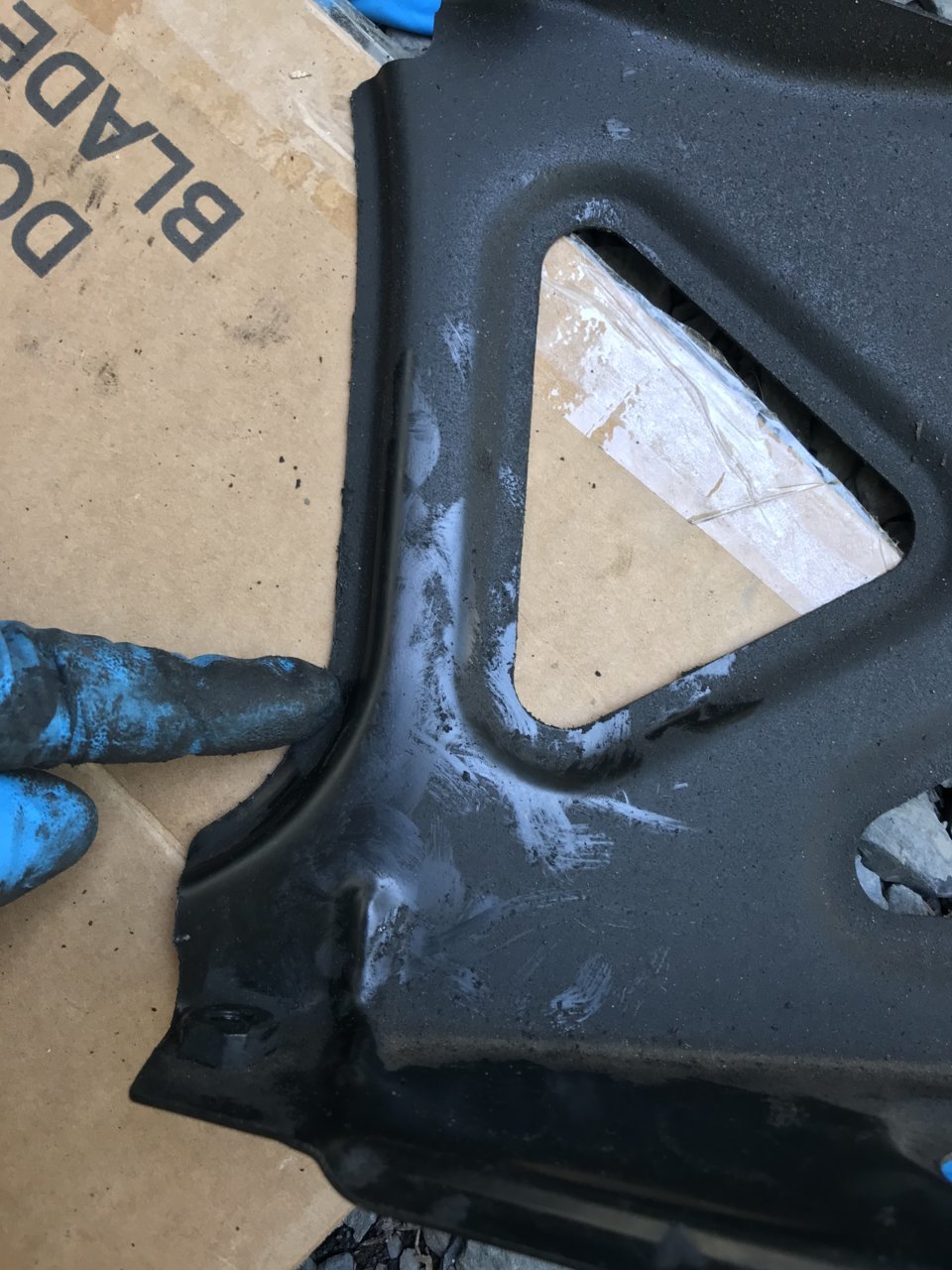

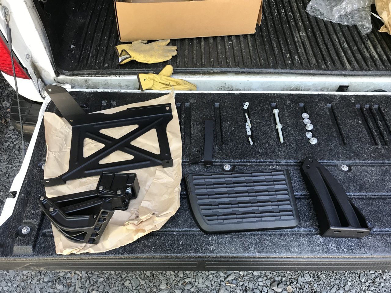

    Bought my amp/Toyota step threw Roman and I figure I would show a few pictures of the process since I replaced the bracket.

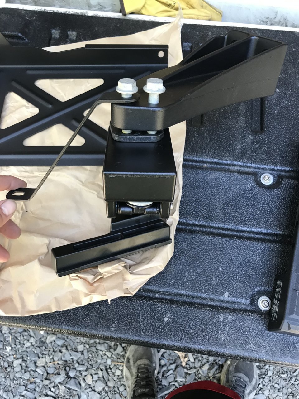

    Here is everything in the kit
    This is the first step joining the kick out bracket to the arm that will bolt to the tow receiver

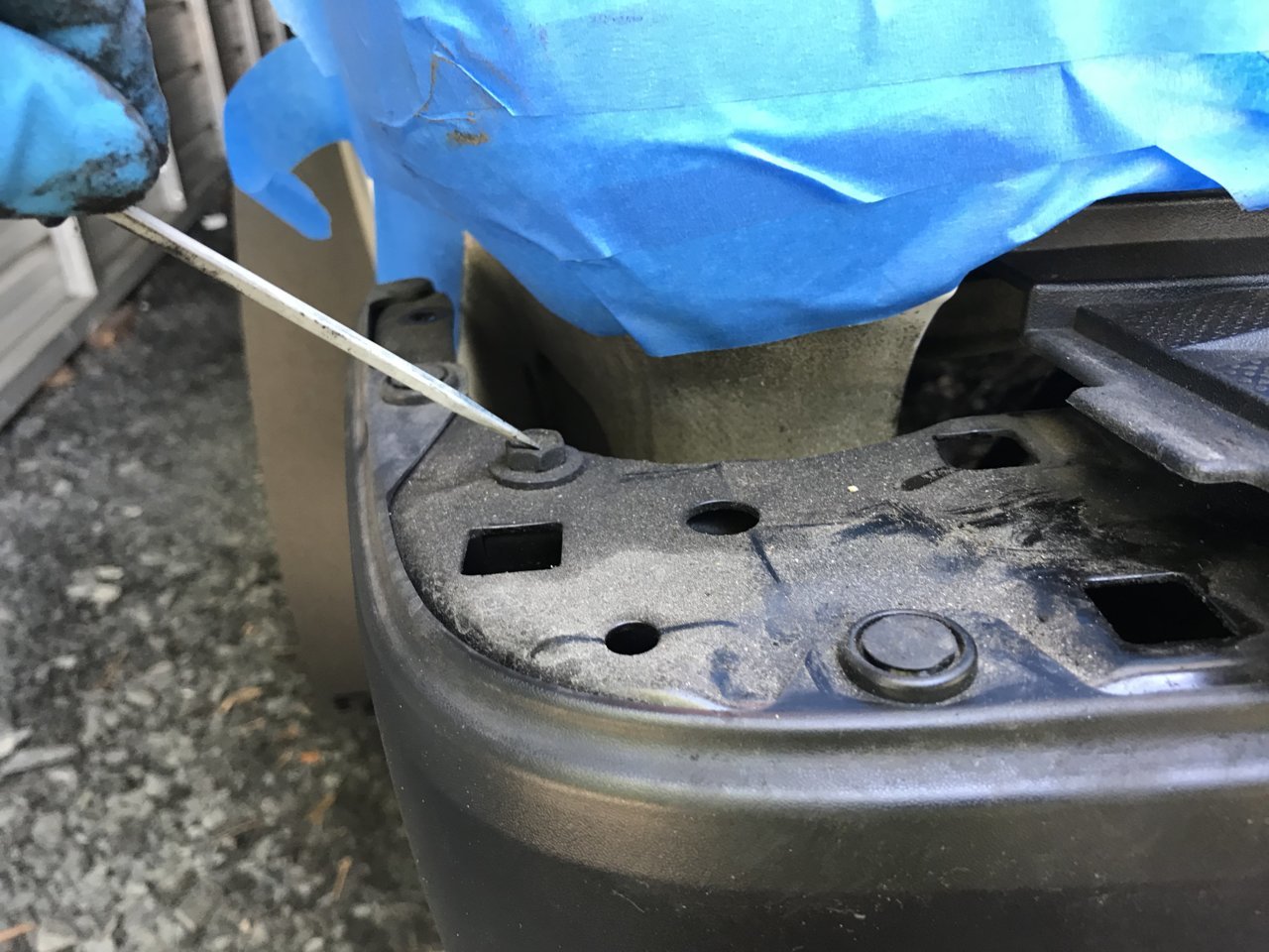

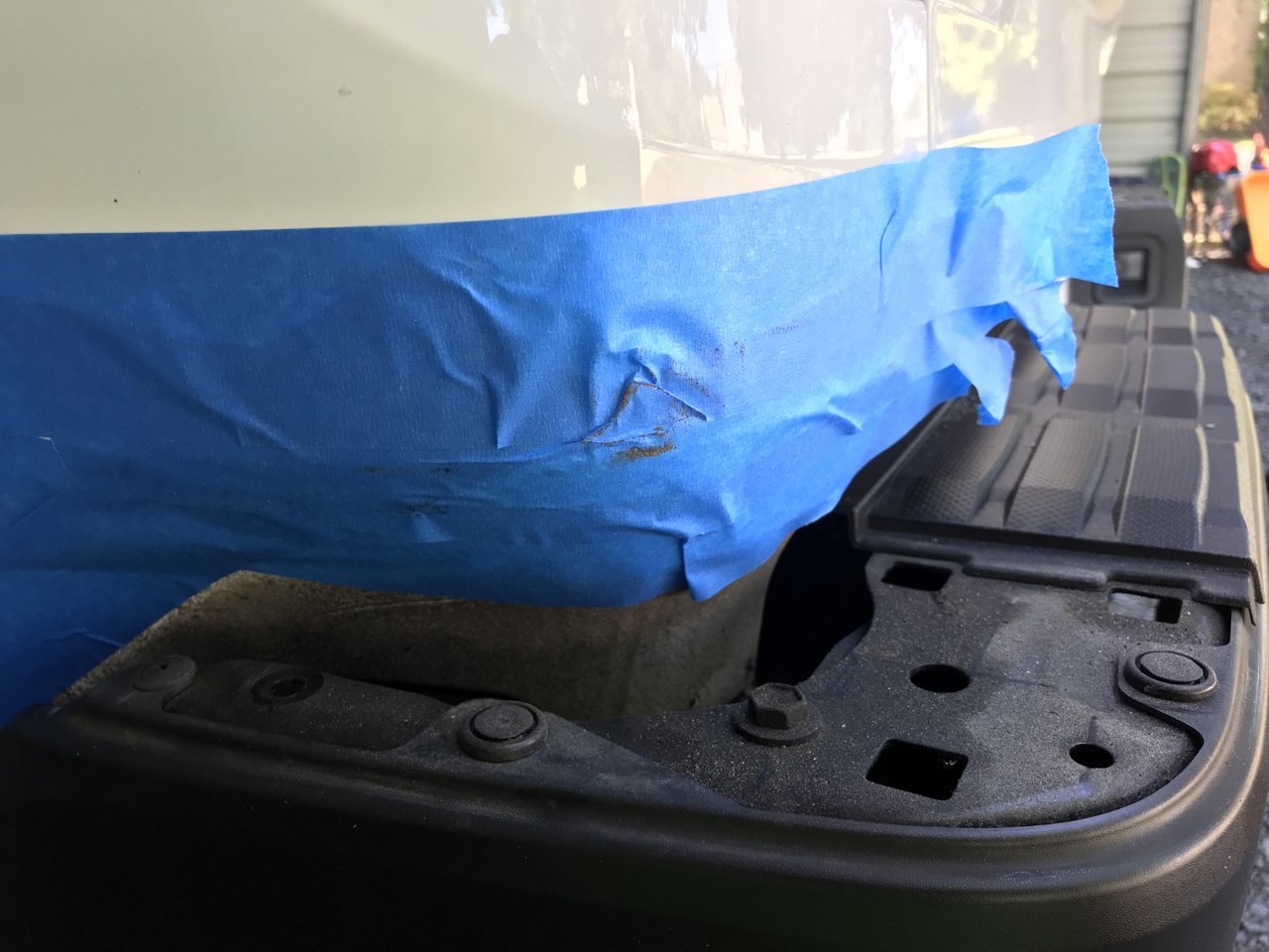

    Next is to protect the paint with painters tape and remove the bumper cap

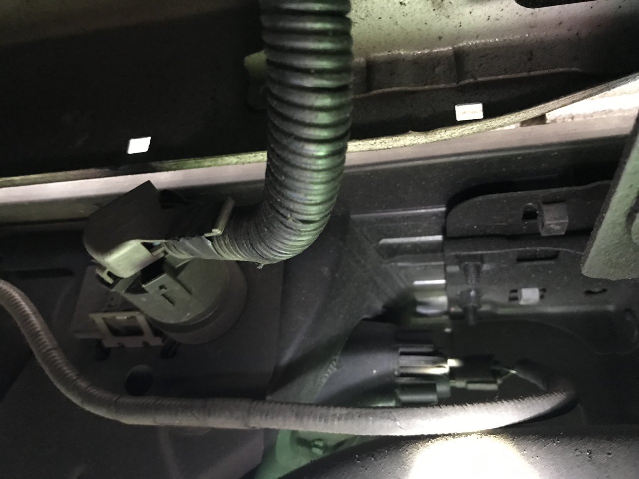

    The 7way plug and tag light need to be removed

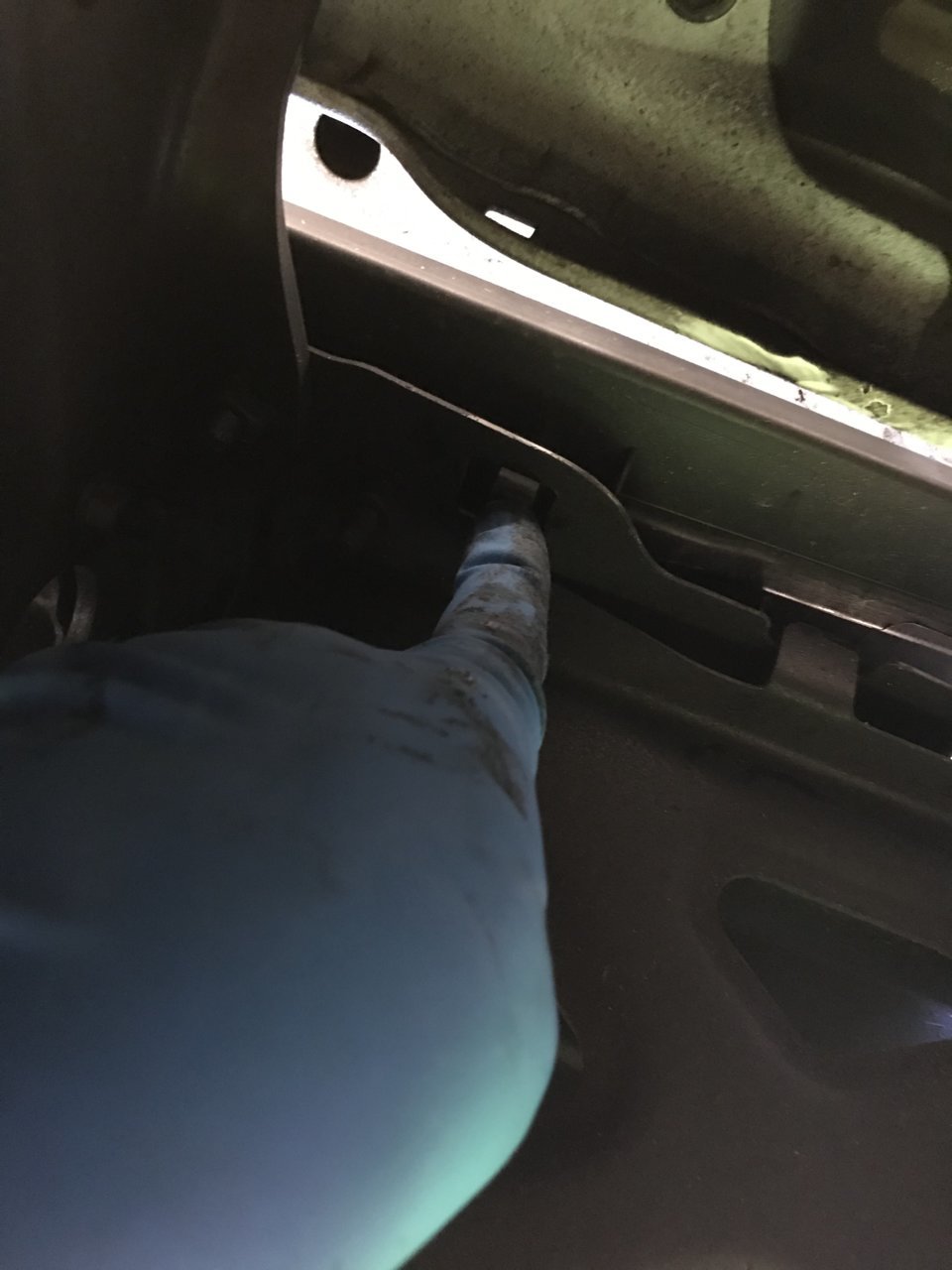

    This clip that holds the bumper/license plate cover is removed
    Gently pry the covering up ( try and pinch the clips so they don’t break). I did end up breaking one

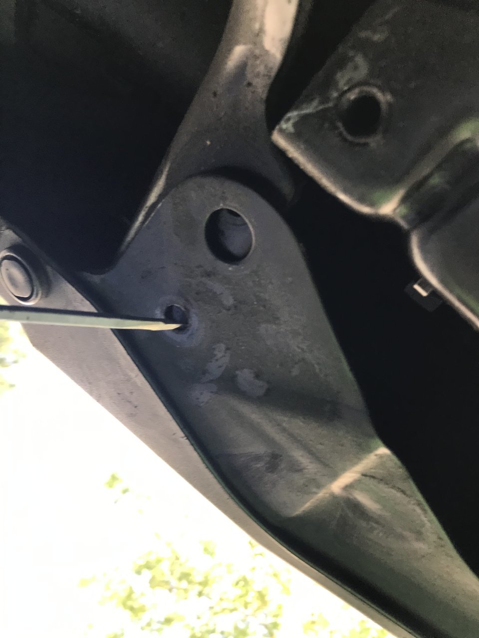

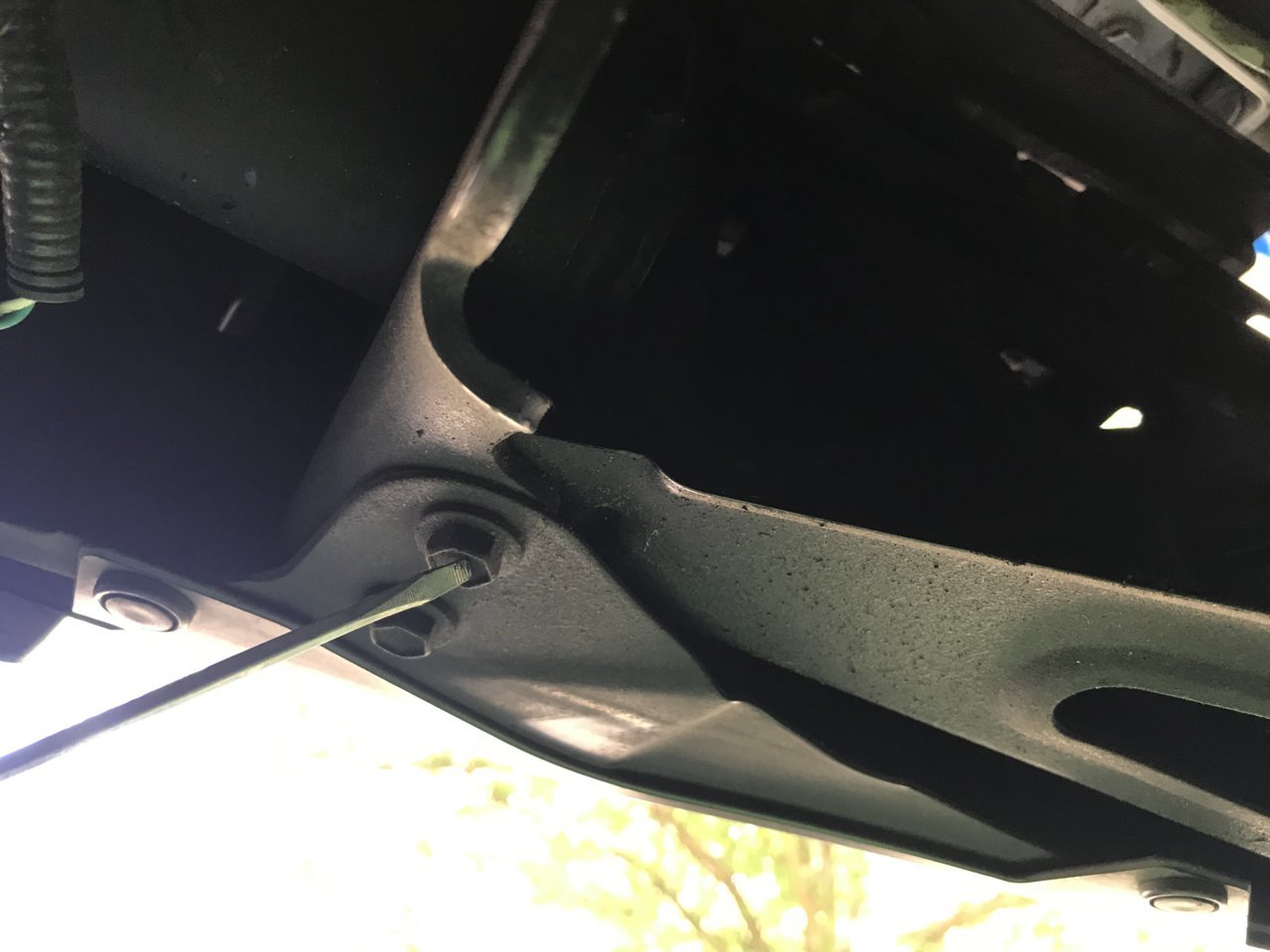

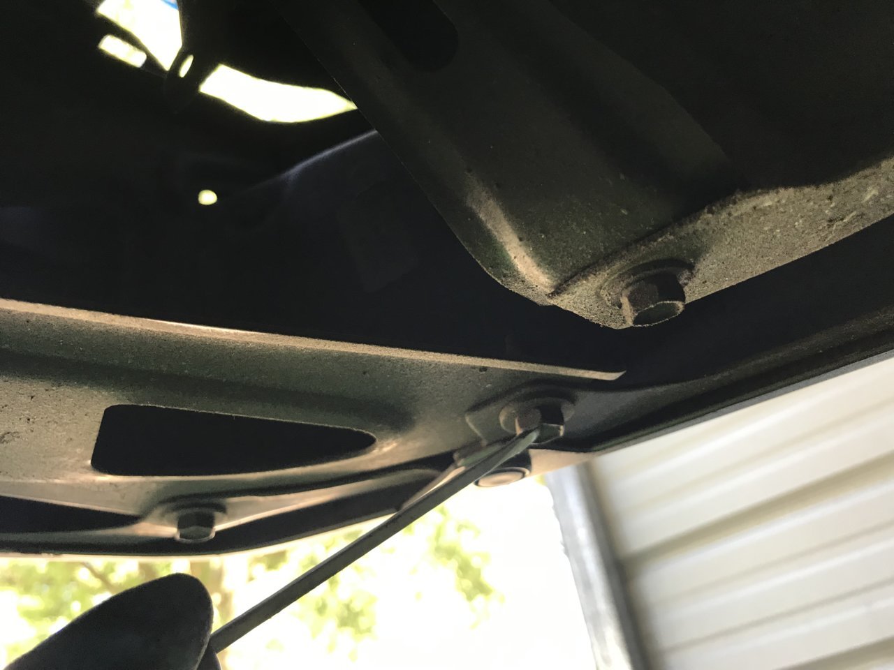

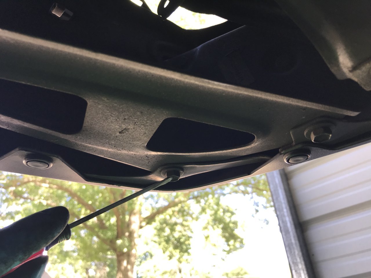

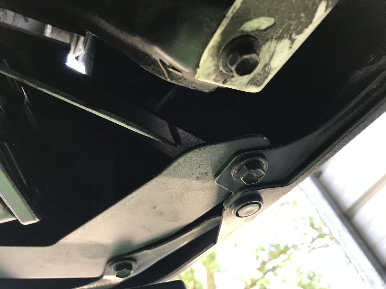

    The five bolts that hold the bracket in

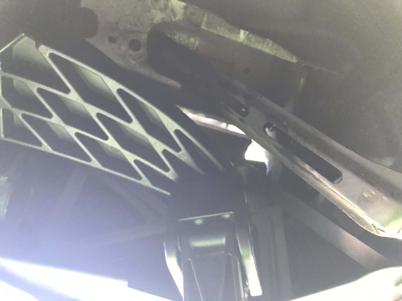

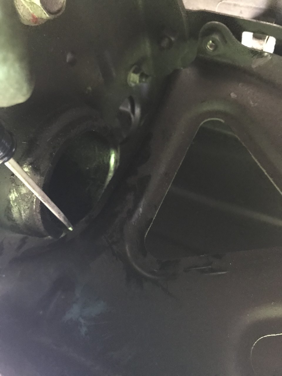

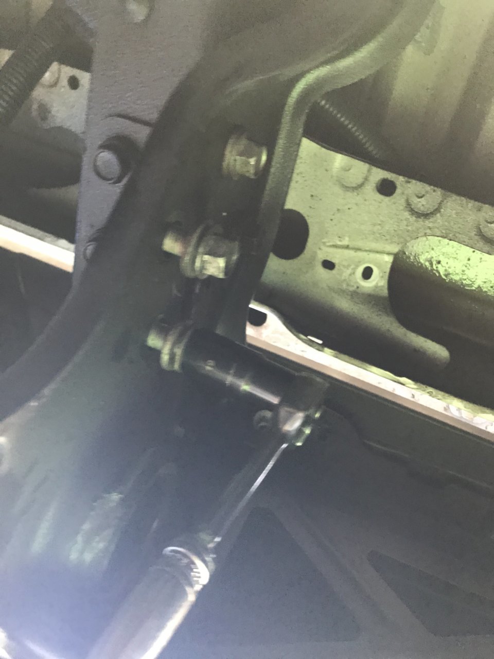

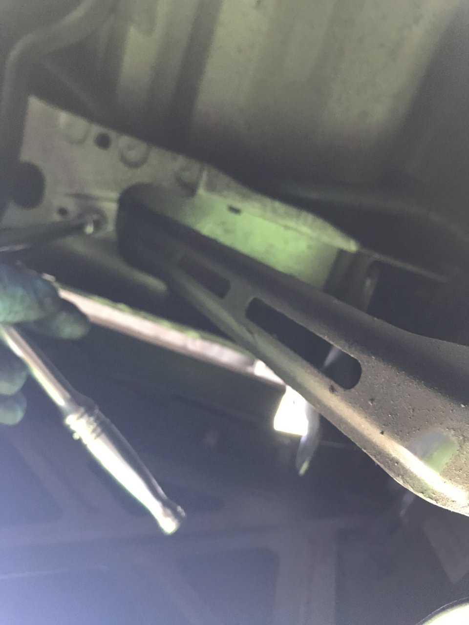

    It doesn’t say in the instructions to remove this bolt, but I did so I could have a little more play to remove the bracket and it still hit the receiver trying to remove it.
    This is where it will get hung up coming out
    This is the spot that will hit coming out

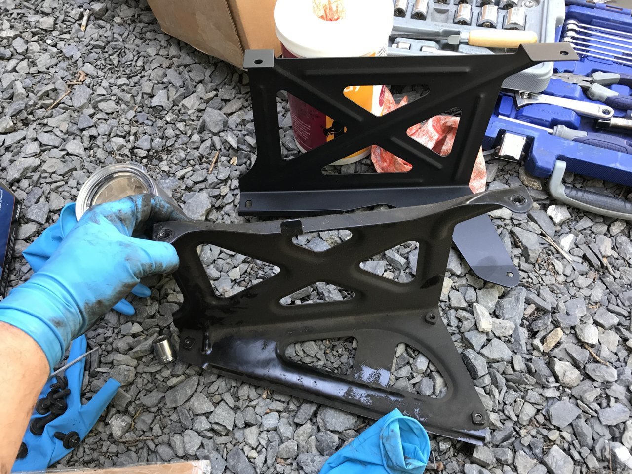

    New bracket in the back stock up front.

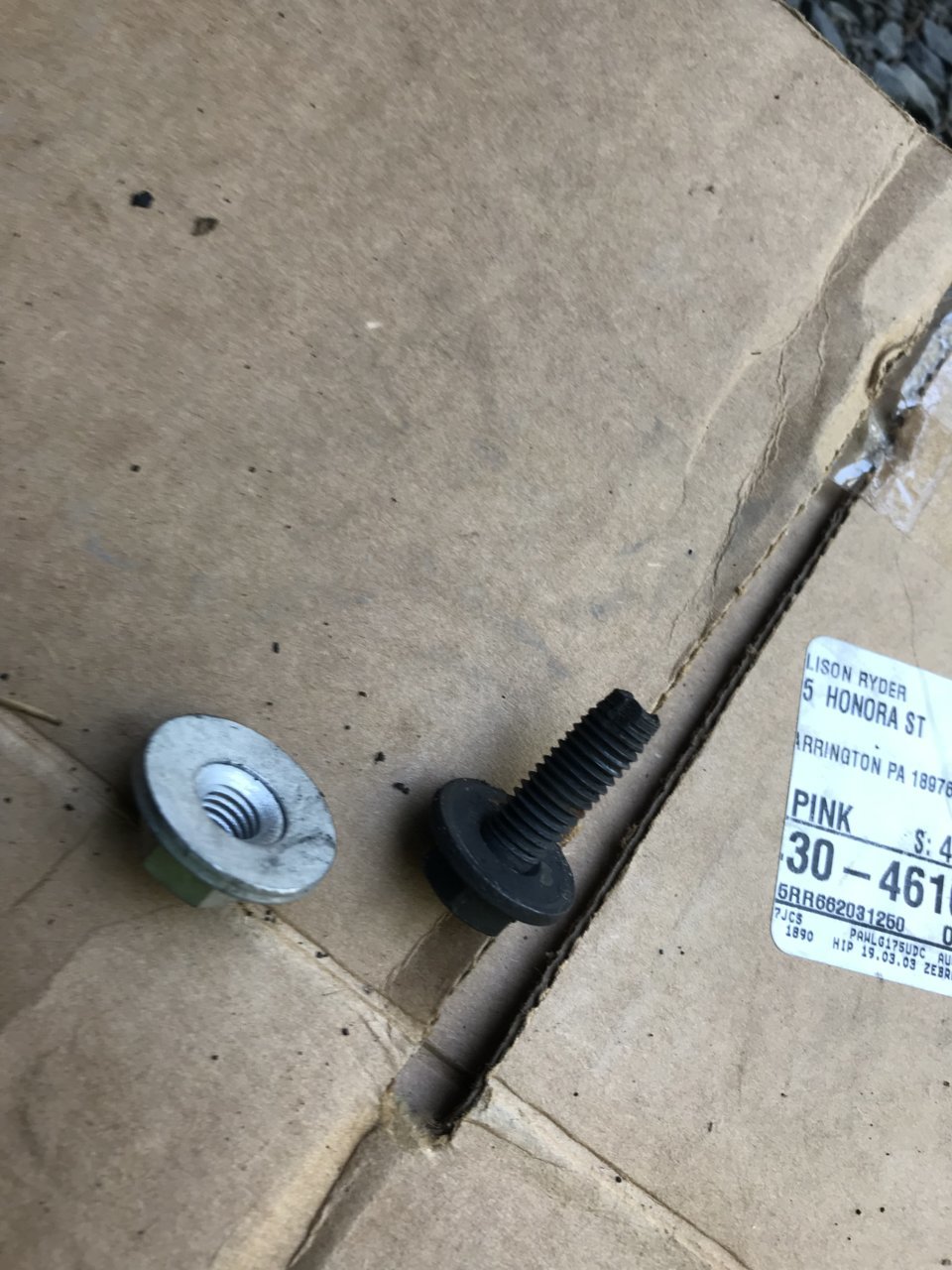

    The new bracket doesn’t have welded nuts on it so these are provided

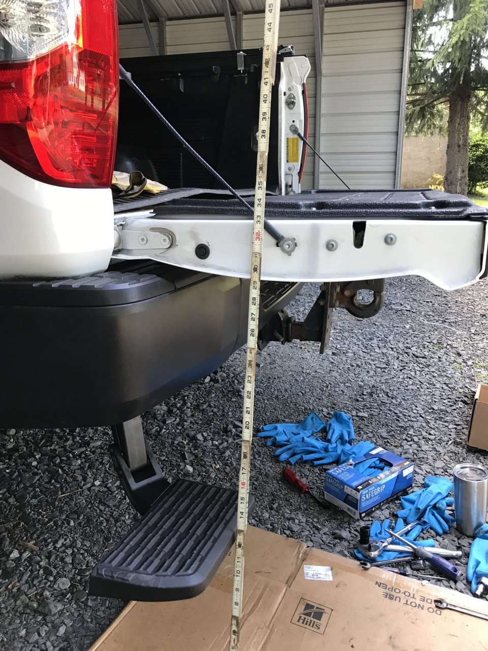

    This needs to be removed so you can torque the amp

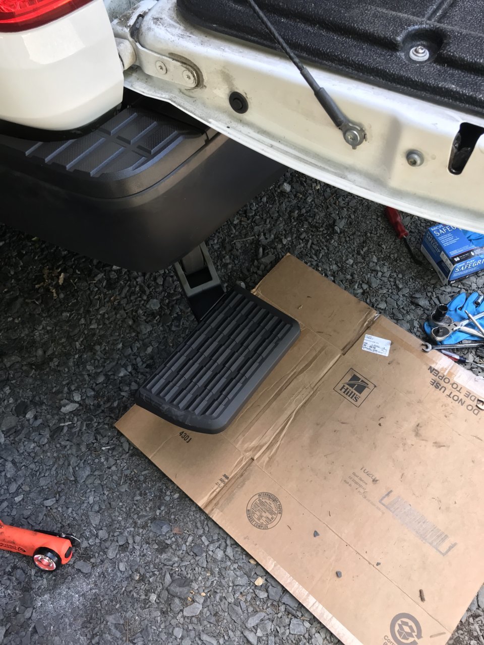

    Step to the truck
    Install the bracket and tighten bolts but leave the one next to the bed out (not like I did)
    Remove these 2 bolts
