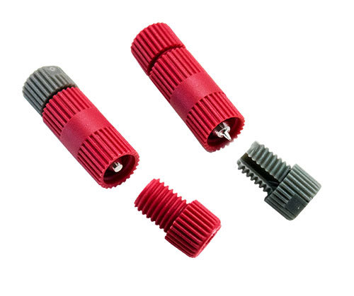

    I just recently installed a set on my '18. The wiring is very simple. You'd need to remove a couple of the inside panels on both the driver and passenger side to access the wiring for each door where they are most likely spliced in with posi-tap style connectors. They look like little red capsules. You can probably just snip the wire where you see the posi-tap or just unscrew them. There should be 4 total. Then just follow the wiring to the control module that should be in the back corner near your fuse box under the hood and unplug everything from it.
    Are the steps in good shape? Motors functioning properly? Sell em on OfferUp or Marketplace if they're in good shape.
    Good luck
    Here's the posi-taps

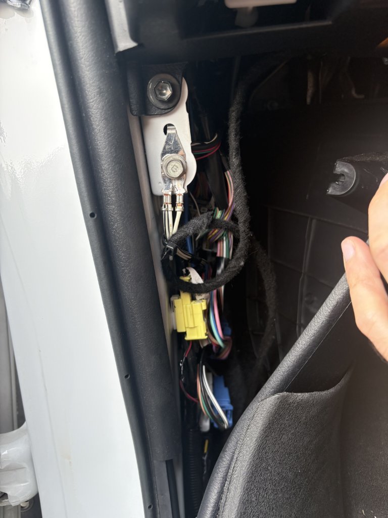

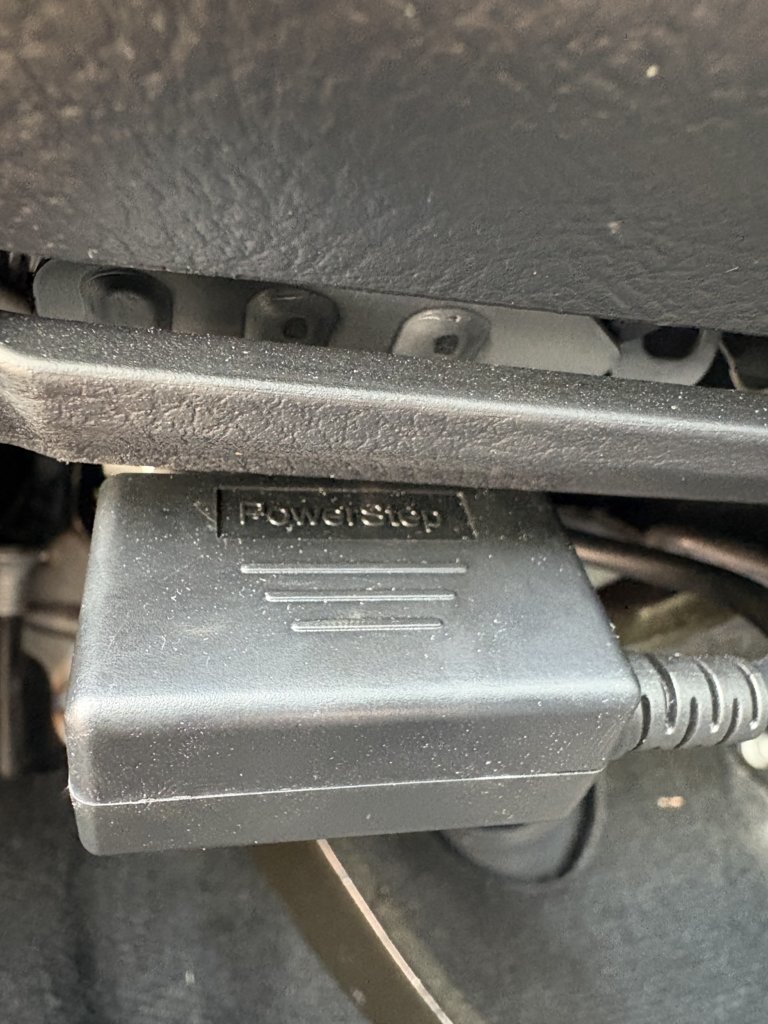

    If I am understanding correctly, it looks like the prior owner used the OBDII port connection method. I see a "powerstep" currently plugged into the exposed port under the steering wheel. Additionally, I do not see any colored (i think purple or red usually)/labeled/spliced wires behind the kick plate on the driver's side. However, I do see that fuzzy black line that was zip tied in (no idea what that is tbh).
    So does this mean I got off lucky from an uninstall perspective? I simply disconnect at battery terminal first (as suggested) and gradually trace the cables related to the system down to the running boards, unplug/unbolt everything and carefully snake them out from the heatshields, etc.? The OBDII method basically controls/calibrates everything with the doors and lights? Seems like OBDII simplifies both installation as nothing from the factory is disturbed?

    Hmm that's even better if it's connected by OBDII. I didn't think it was possible for our gen tundras to connect via OBDII buy yeah, I'd just have the cables like you said and see whether it leads you to(hopefully the power steps). As for that fuzzy wire loom, that's definitely not what AMP sends with their kit.
