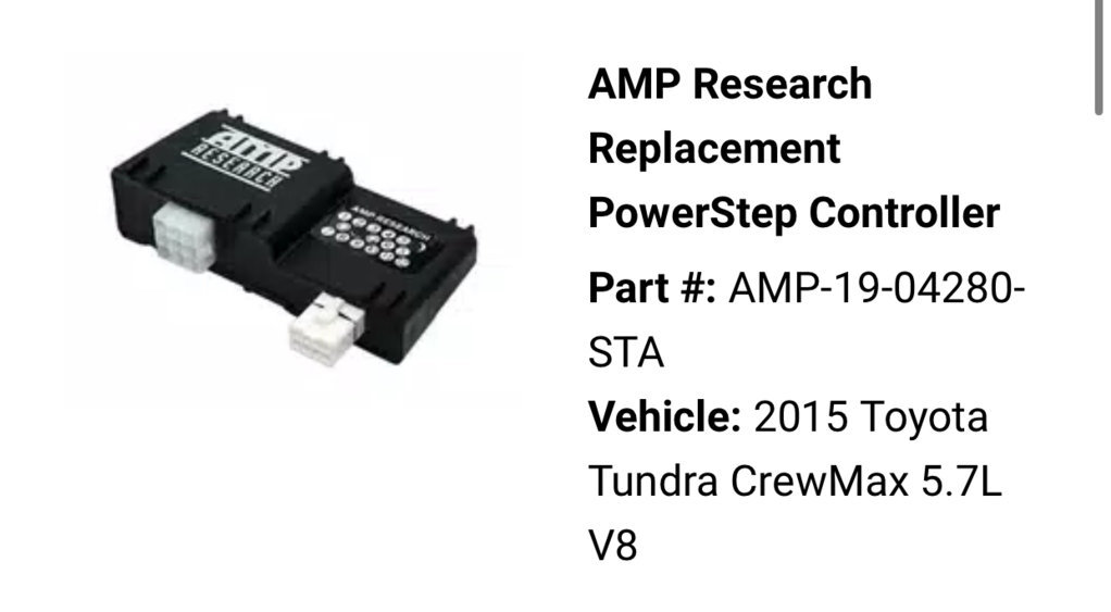

    Did amp confirm the control module is compatible with the motors? Might want to see if you're able to switch to the OBD plug. Wiring on that was really straight forward, 2 wires.

    I could switch to the OBD Plug, but I'd need to buy a whole new harness. They aren't that expensive, but I'd like to not re-wire the whole thing. I bought the control module from Real Truck and their techs assured me that the module was the correct replacement for my model. Those control modules are pretty universal.

    I used this one.

    Looking over my receipt, that is the one that I ordered and the one they sent me they sent to me.

    This is the shipping details they sent me when I received my controller.
    Official Amp Research Shipping Center, ElectricStep<webmaster@electricstep.com>
    Fri, Mar 15, 12:16 PM
    tome
    Order ID #151273 - Shipment Completed
    Please Note: this shipment completes your order. According to our records, all products have been shipped and should arrive shortly (delivery time changes depending on the shipping option you selected when you placed your order). If you do not receive one or more of the items that you have ordered, please contact us.
    List of shipped product(s):
    ( STA ) 19-04280-STA Controller | A-04 / A-06 Replacement - Qty:1

    That's all appears to be the same. I got mine second hand, had to end up replacing the motors because the gearbox portions were seized. You can disconnect the motors and put power to them to see if it would spin. You can also manually spin the gearbox to see if that's the issue. I ended replacing pretty much everything but the hinges and boards.
