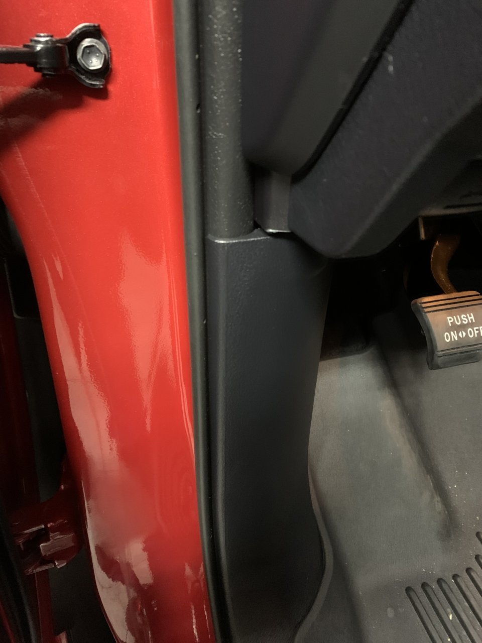

    No matter what I do, this part never sits flush. It's so annoying.

    There are white clips that may need to be removed from the removable kick panel, inserted to the clasps where it mates to, then push the panel back on. Might take a few trials and errors to get it flush or some variation of where the clips sit first.

    Are you sure you don’t mean to remove them from the body mounts and reinstall them in the panel? That’s what always happens to me. The white clips stay on the body mounts. I remove them and put them back in the panel and just reinstall. Pretty easy.

    Yup, from my experience the clip gets stuck on the frames fender side and will need to be removed and seated into the black panel in order to get that panel back in flush.

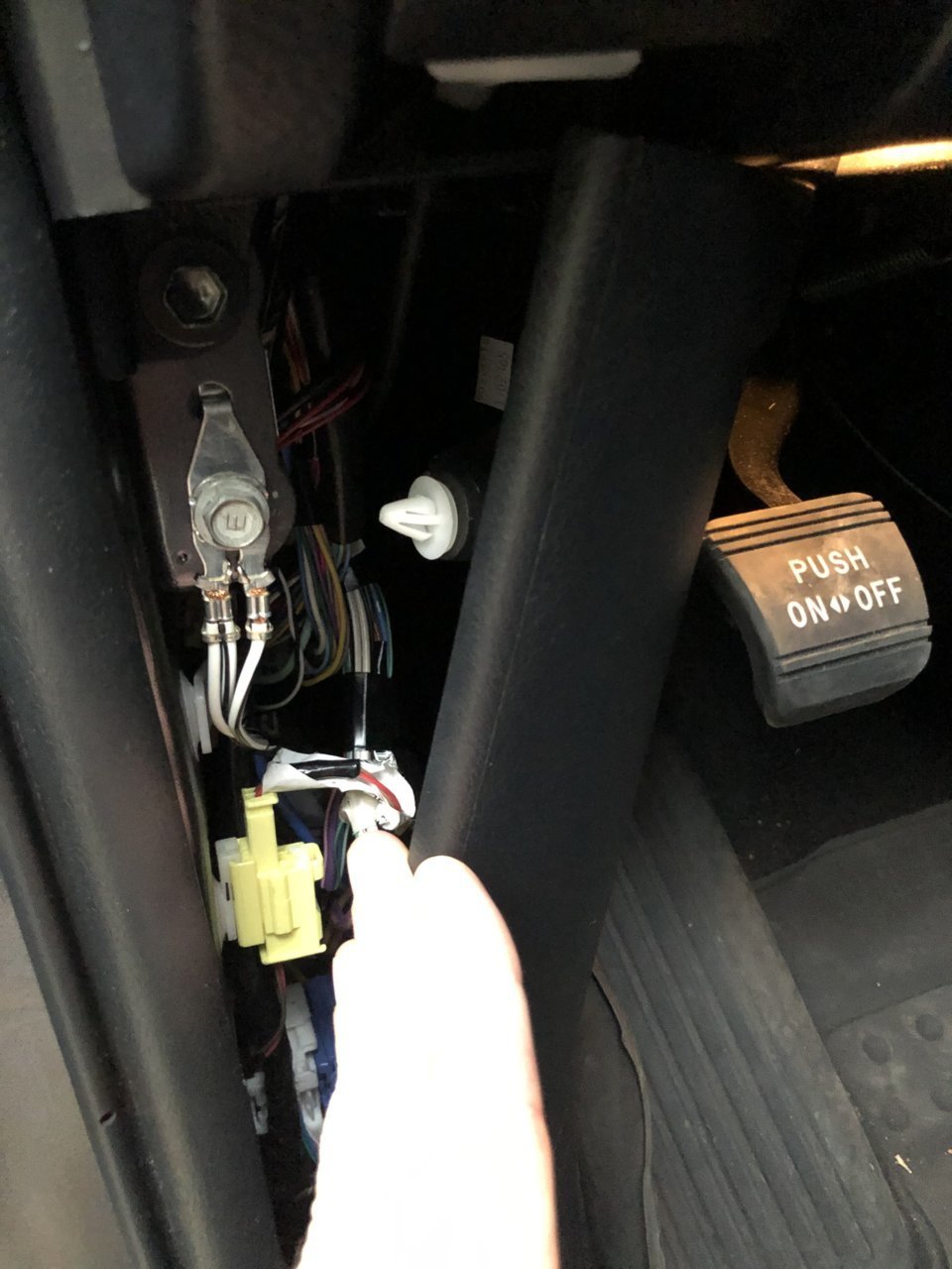

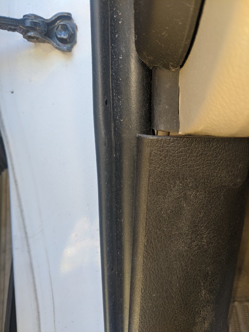

    There are 2 clips on those. When the panel is removed, 99% of the time the clips pop out of the panel and stay in the mounting hole as seen in pic 2. Just pop it out and slide it back into the panel and you will be good to go.

    Yup. Some careful application of electrical tape can help keep these in place while you re seat the clips. This drove me crazy

    Every. Single. Time. Pull clips from body, insert in panel, reinstall panel as stated above. Cumbersome but will sit straight again!

    The upper clip needs to be removed from the truck and attached to the panel. The lower one works best in my experience if it stays on the truck and you attach the panel to it while reattaching the panel.
    I’ve had mine off so many times I can get it back on fully in my sleep.
