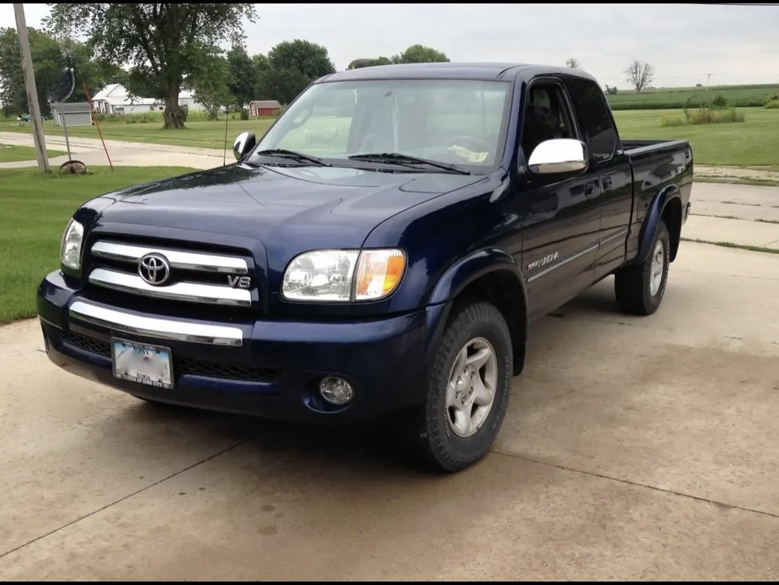

    Here is the 04’ when I washed and waxed it up when it hit 200,000 miles…around 5 years ago. It will hit 300,000 miles next year. I’m trying to put as many miles on it as I can before it gives up the ghost. It had a rough year due to a incompetent mechanic…it spent about 2 months in the shop…which is why I finally broke down and bought it’s replacement. It has never left me on the side of the road…never gotten it stuck.
