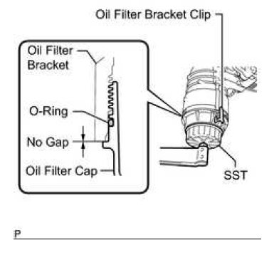

    Correctly installed, the o-ring seals on the bore of the filter bracket. Lubricate the o-ring liberally with clean motor oil to prevent damage when you screw on the cap. Intuitively, most people want to install the o-ring on the filter cap flange where it says "no gap"...it won't seal there.

    Oring was installed installed correctly.
    No leaks at idle, but after a couple of 5k rpm runs i checked and there was oil again. Too bad, it looks like a nice machine item.

    If the o-ring was installed properly in the groove, then try lubricating the o-ring and filter bracket bore well with some of that super-slick Amsoil before screwing on the filter cap.
    When I did my last oil change, I noticed a slight resistance as I screwed on the filter cap. This was after I smeared fresh motor oil on both the o-ring and the inside of the bracket bore. If you encounter resistance when screwing a dry o-ring into a dry bracket bore, that resistance is friction that can lead to the o-ring "rolling" in the groove and causing damage to the o-ring.
    IIRC that aluminum filter cap is cast, and machined surfaces are minimal. It's an economics of manufacture issue. Even with a minor machining error, o-rings still have a few thousands "forgiveness" (compression) that permit them to seal if the dimension is within tolerance.
