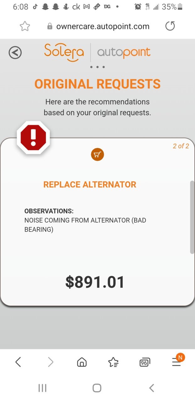

    Thank you so much for your help! But I even called the parts department and asked them how much their alternator was and it was around 300 and I went on a toyots website and found it even cheaper for about $230 which is about $700 dollar in labor which is outrageous

    Thats what I'm saying i would do the same thing in just thinking of options on what I can do. Like its outrages the part on a toyota website is about $250 dollars and they are trying to charge me more than $700 dollars in labor. This is the messaged picture link they had sent me
