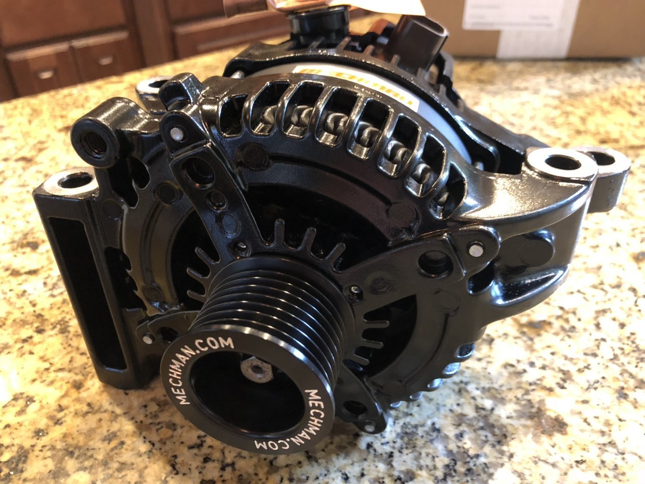

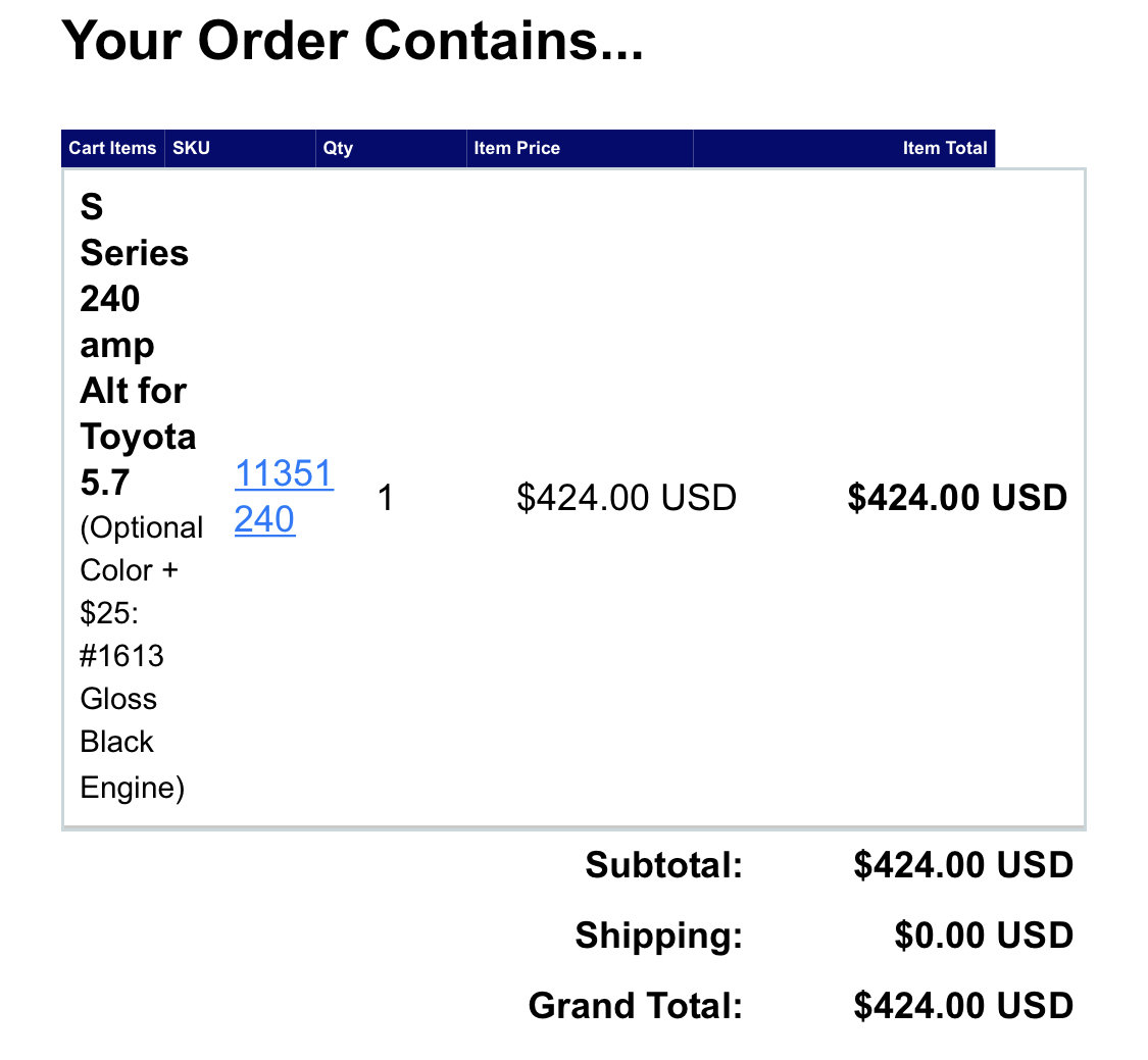

    I went with the Mechman 240 amp alternator. It has been great! Here’s the exact alternator and 1/0 wire kit I ordered.

    295/70R18 Nitto Ridge Grappler Method Race Wheel NV Bronze Rigid Industries Radiance Pods Morimoto Xtorch 36” Light Bar SDHQ Pillar Light Mounts
    Where you order that from?

    @1UPPER @Grey Wolf just saw they have color option (pretty cool) what color did you guys get yours, curious how they looks painted.

    My OEM alternator is still good. If I were to replace it with a Mechman it would naturally be gray.
