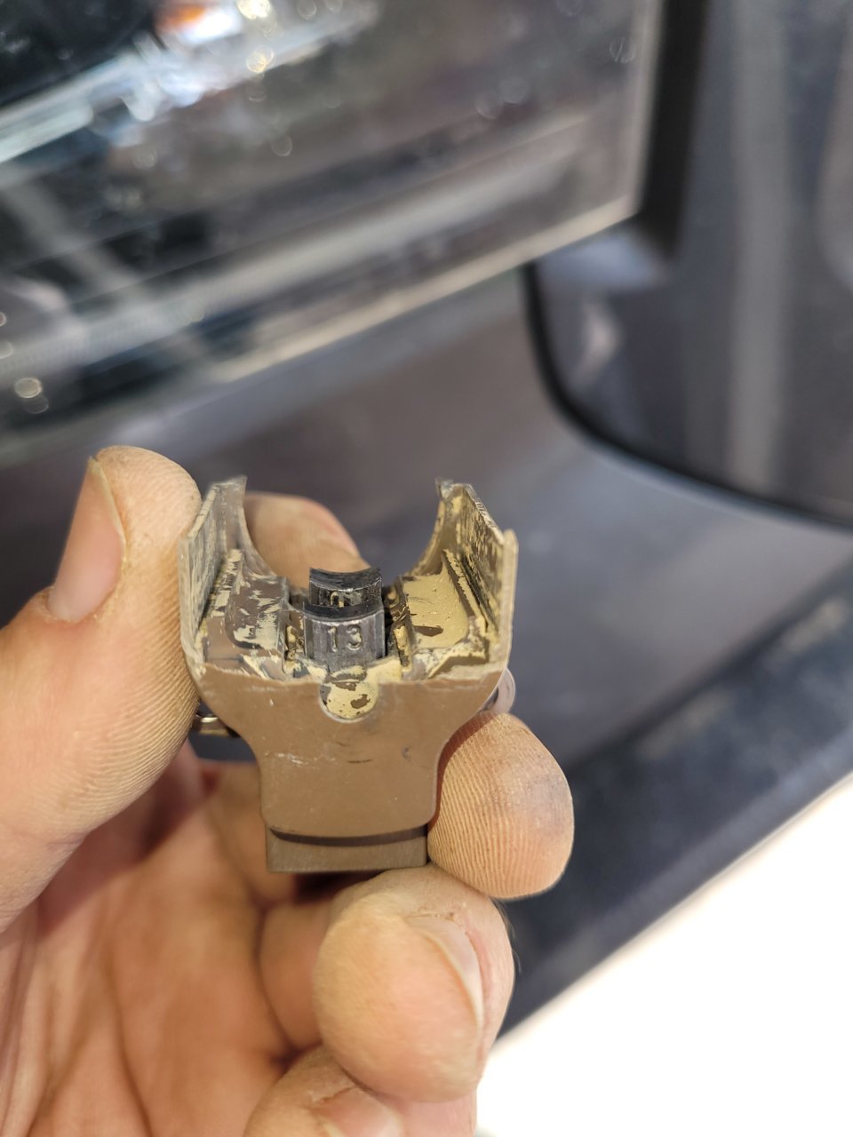

    Here is a picture of my brushes at 240k when my alternator got completely submerged in a mudhole, the alternator was actually still good, but the brushes got stuck into place from the mud and couldn't extend to the armature. Once that was clean it was good to go, but I replaced it anyway. I believe with plenty of patience and an inspection mirror the brushes could be replaced without removing the alternator if you needed a quick fix for some reason.

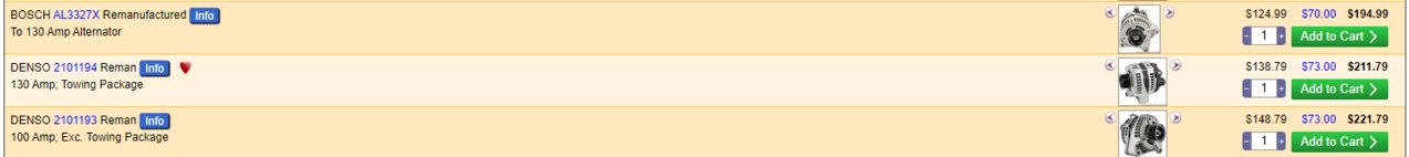

    Rocko9999, you are looking that the original price. You have to send them your core like any other parts place that sells remans.upload_2022-12-28_8-48-46.jpg
  18. Dec 28, 2022 at 8:30 AM
    Rocko9999
    Rocko9999 New Member
    Dec 30, 2020
    #56832
    951
    Ah, you are right. I wasn't reading that correctly. Thanks. Looks like mine is $182.79.
