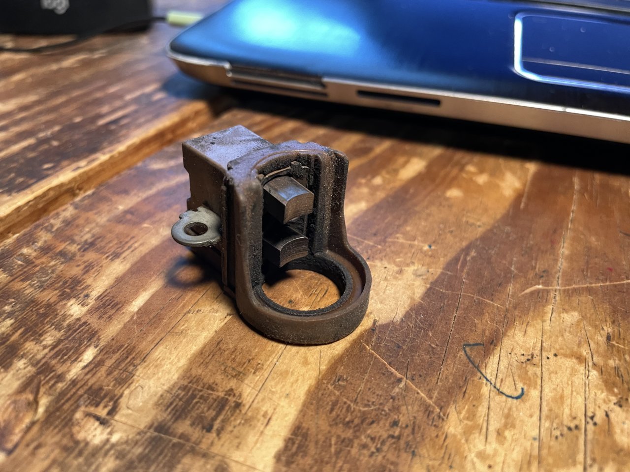

    Given the age of your truck (and I'm going to speculate 125,000 miles) I would replace the brushes inside the alternator. Not the alternator itself. The $15 brushes that are the wearing component on the inside of the alternator.
    Here's the brushes from my 1997 Toyota T100 trucks.

    231000 miles. I had the alternator put on the bench and tested and it passed?
