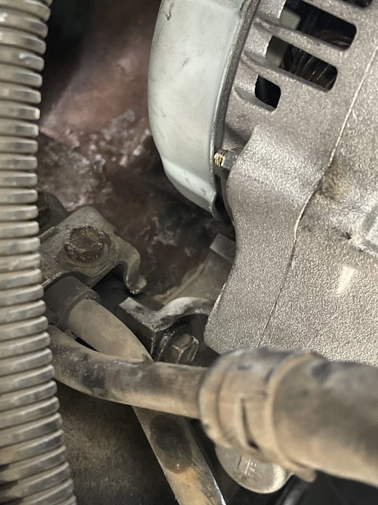

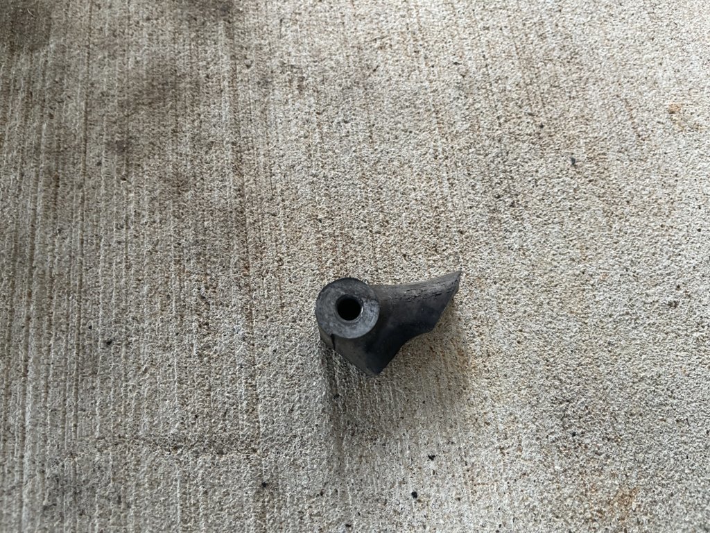

    Alternator finally gave out at 450k. I go to install new one and find the bracket has broken off. Does anyone know what the front plate is that I will need to fix this? Guess I’ll be doing a timing belt change since I’m going in.. IMG_4550.jpg IMG_4549.jpg

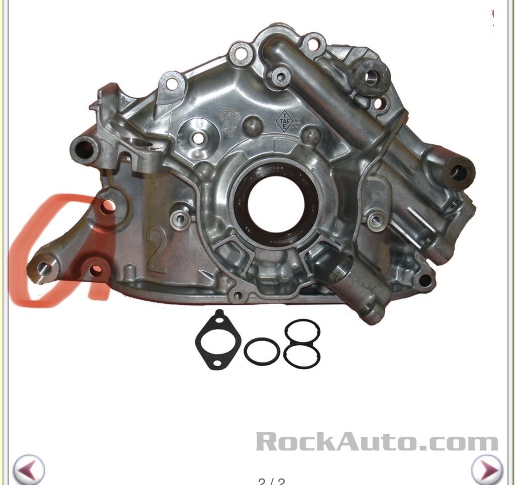

    I found it, oil pump…

    It’s the oil pump I’m pretty sure.

    Both pans must be removed on the 2UZ to remove the oil pickup tube which is attached to the back of the pump by two studs.

    Damn, dude. That corner broke off? Talk about poorly casted metal. Well at least you got to 450k miles before it happened.

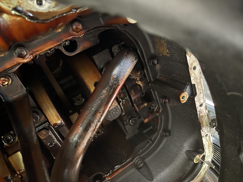

    I dropped the bottom pan today, much easier than I expected. It looks like I can get to the bolts to remove the pickup tube and the bolts to remove the pump. IMG_4566.jpg

    Wow. I wonder if that’s typical of what the bottom end looks like on our trucks. For 450k, it doesn’t look too bad. A wee-bit sludgy perhaps.

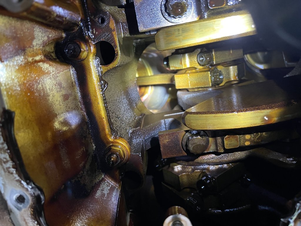

    i think it looks pretty clean for over 450k. good luck...mean that in a positive way
