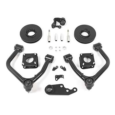

    So that's a ready lift kit that's just spacers and a uca pretty much for almost a grand.
    I'm not arguing getting a full suspension upgrade that's my plan, I also already own the wescott kit. Just curious about what's being done out there. Tundra_69-52310_Product_Image_400x400.jpg

    Funny how the ReadyLift and Rough Country kits have a diff drop with them but no one else has a diff drop kit.

    I have thought the same thing, but damn do those diff drops look flimsy.

    If the diff drop is anything like the older trucks, it won't help that much with CV angle. It only rotates the pinion up

    That would make a lot of sense in this case. I kept looking at the RC instructions, trying to understand how it dropped the diff...but it doesn't.
    ReadyLift says their kit includes a "diff drop bracket" while Rough Country states it's a "diff relocation bracket." The two designs are nearly identical.
