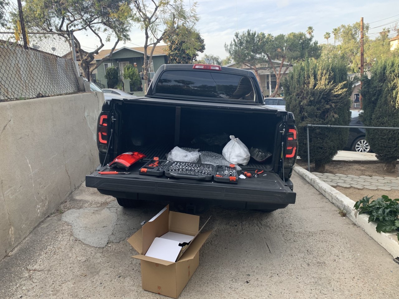

    Put mine in this weekend. This was in conjunction with a set of Morimoto headlight assemblies. Tails went in first, no hyperflash. However, once the fronts went in, they all hyperflashed, even though the Morimotos were supposed to be plug and play with no resistors needed. Did some reading, and it looks like the Morimotos don’t play well with non-resistored LED tails. Got some resistors on the way to hopefully resolve the issue.
    I do like the way they look, though.
    B732AEB0-D67C-4AA2-A9A0-3581EE7A890D.jpg 18275DCB-BEDD-4A6B-9DC6-3BE93BB9B3ED.jpg
    mtndds98 likes this.

    Got the resistors wired in today - all four turn signals now function as they should. While I had the tails out, I went ahead and dropped in some GTR Ultra reverse lights. (That’s my only knock on the Alpharex - they don’t include a reverse light, making you reuse the factory incandescent bulb.) The GTR’s are a big upgrade. Very happy overall.
