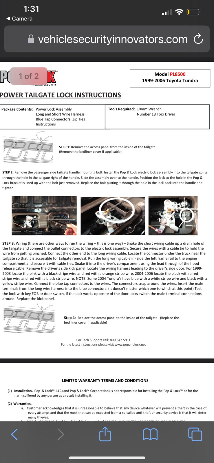

    so I have the installation done other than connecting to the correct wires apparently
    their diagram says to connect to the red wire with black, and the black wire with red. This is behind the drivers kick panel on the wires going to the driver’s door
    while we have not eliminated that the motor is not working I believe they feel it’s just a matter of connecting to the right wires. Thus far their tech-support and I’ve only traded Voicemails
    anyone had this problem on a 06 Tundra DC?

    Sometimes the wire colors do not match what’s expected. They do not stop the assembly line if they run out of a color. There are also multiple bundles of wires that may share the same color wire. Best to get a light tester or multimeter and test these wires for the appropriate action when locking and unlocking.

    the problem was I was having to test wires because the pop and lock documentation was wrong so I could not disconnect the battery

    it should not been a problem. That’s on me. But it was frustrating - trying to get in touch with tech-support for three days and then them giving you totally different wires than what was on the instructions

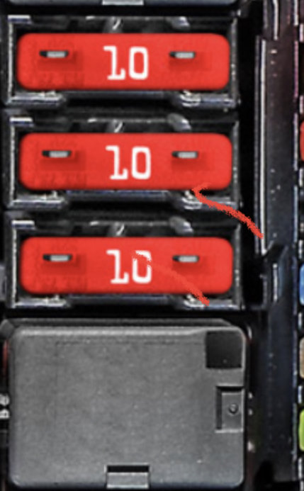

    I checked all three of the 7 1/2 amp fuses inside the cabin and they all appeared fine
    I wasn’t sure which one it was in the engine bay but I did test the cigarette lighter, the auto light shut off (assuming we’re speaking of headlights, but it could’ve been cabin lights) and the tail lights since they were all listed for the 140 amp fuse and they were all working
    I will recheck all fuses in the interior in the morning with better lighting,

    If you indeed have a meter, all of the little fuses can be checked by hooking meter black lead to gnd and touching the pos lead to the metal piece on each side of a fuses rating….should see 12vdc on both sides. Saves from having to pull them in case you can’t see em good.

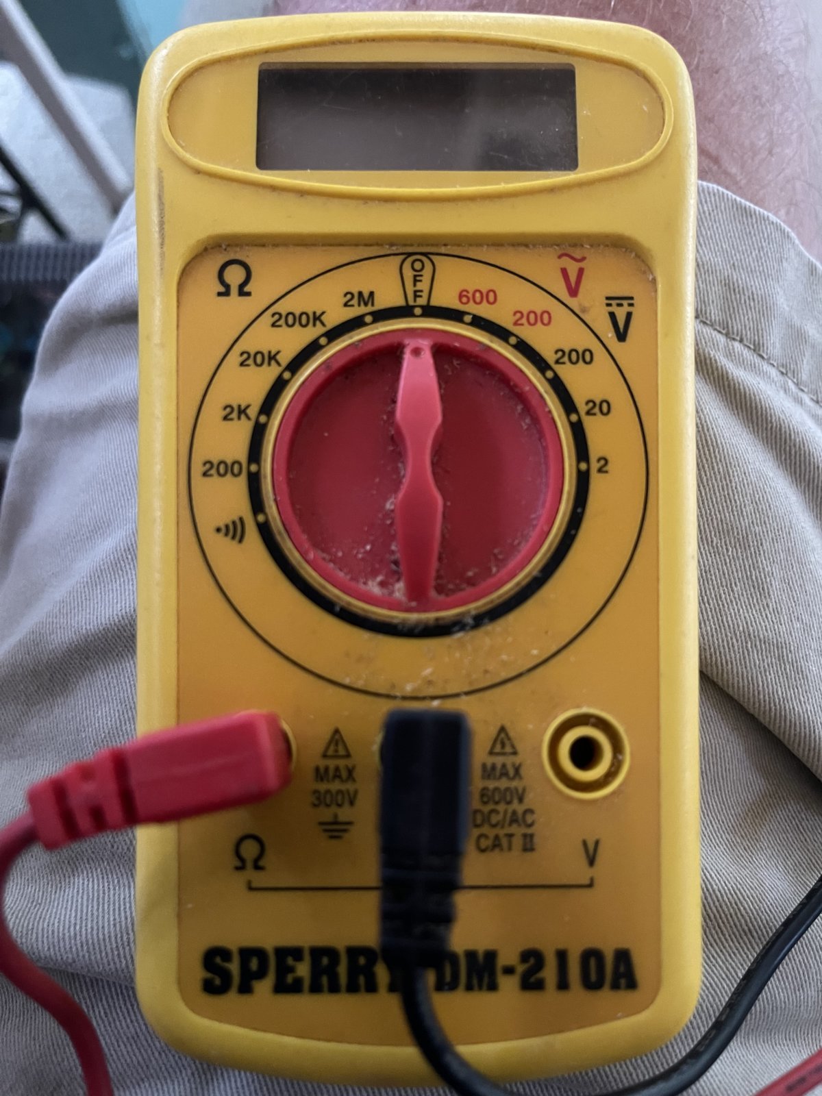

    I did have this meter from many years ago and it is still working. Trying to read up on the proper settings, but everything so far is for a different type of test

    it did turn out to be one of the 7.5 amp fuses, but it was under the hood not in the cabin

    You may know already but put red lead on other side where it says V. Turn knob CW to the black 20 black V which is a DC symbol.Then you can read any DC voltage under 20vdc

    I never would’ve seen that this fuse was blown until the test confirmed it. Then I could see the smallest break without any black
  30. Oct 6, 2023 at 6:47 AM
    #30
    shifty`
    shifty` In South Dakota Trouble ain't hard to find
    Jun 20, 2020
    #48239
    28,625
    ATL
    '06 AC Limited V8/4WD
    Yeah, any time you see multiple circuits out from the cabin rearward, it's quite often under the hood IME. Especially if it came after one sparky event.
