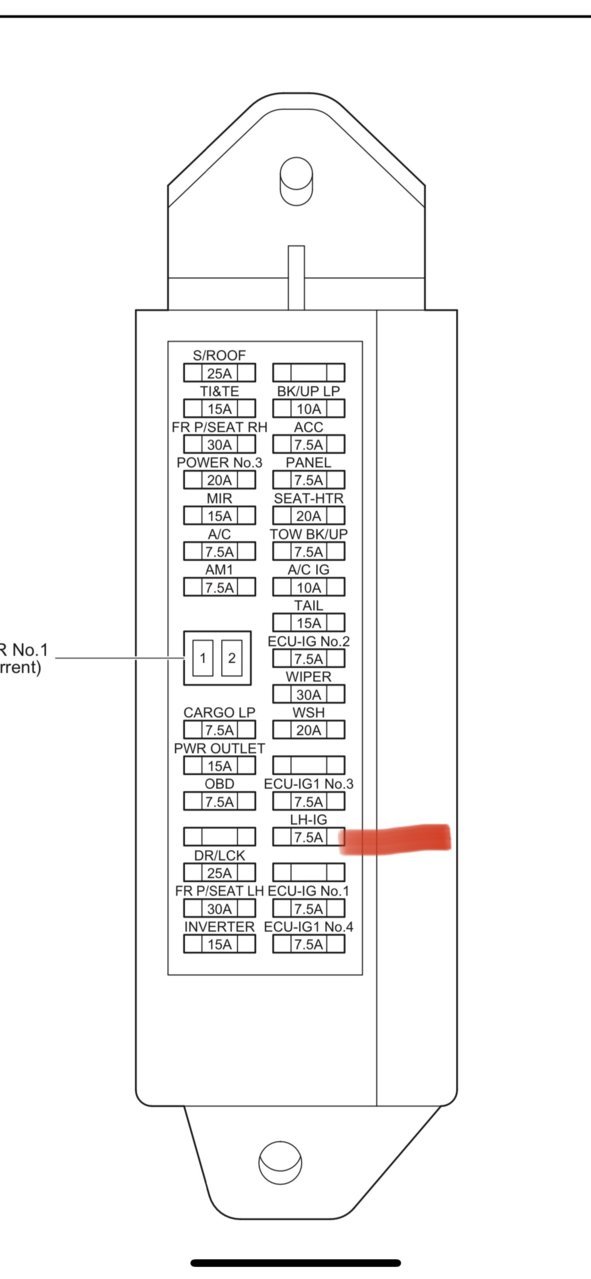

    Make sure the 7.5A LH-IG fuse is good. It powers the voltage regulator when key comes on. It’s in the interior fuse box, drivers side under dash.
    Also a 5A Alt-S fuse in the engine fuse box. Would check it as well

    Oh fire I'll check that QST thing in the morning and post what I find thanks

    Sorry took so long finally got to it fuses are good this is crazy is there is no way it's a bad battery right I can't keep truck on and take leads off to see if it pumps.out correct voltage truck turns off when disconnect battery
