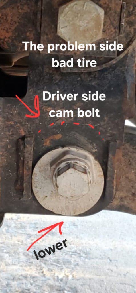

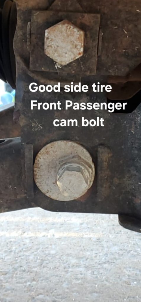

    I been having problems with driver side tire wearing from inside. I have fox 2.0s with 35x12.50 R20 Nitto ridge grapplers and this is 2nd time buying tires and have taken them to inspect alignment issue and all they keep saying are tie rods I've replace twice BDS 6" but after alignment shop and after 4 months I keep getting same problem driver side wearing from inside so i started inspection myself and I spotted something looks strange. Maybe someone who knows more about alignment cams might be able to see what I see and hope that is a pointer for my problem. I will post pictures

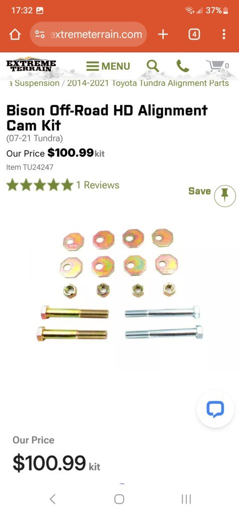

    I been researching and came across this kit "Bison HD alignment cam lock "
    I will be installing new upper and lower control arms. My guess is driver side lower control arm Bushing are worn out.
    But please let me know what you think and if you had similar issues
