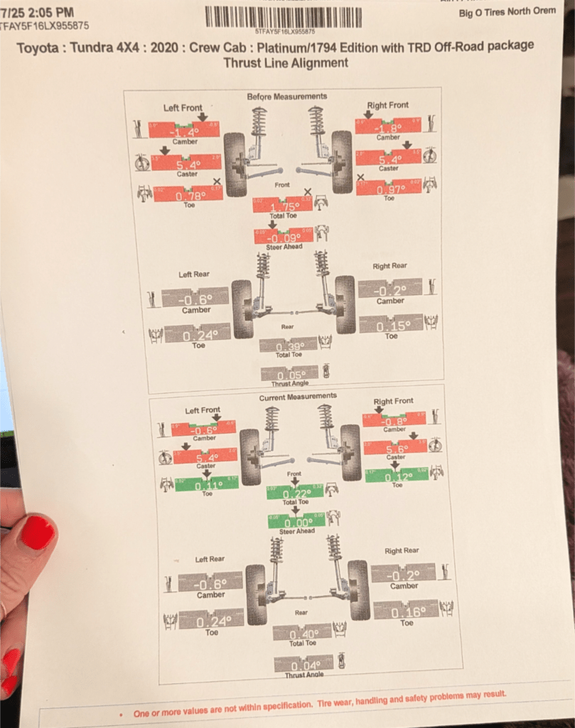

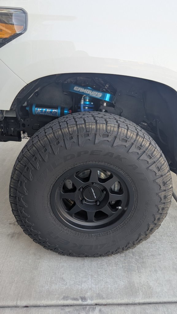

    2020 Tundra, 4.5 BDS lift with camburg UCA and King suspension. 37inch Falken AT/4s
    I have tried to get it aligned 4 times, the first 2 by myself, and the second two by my off road shop. They even made adjustments to the UCAs.
    This is the BEST alignment I could get, it was way worse before..
    Obviously I have negative camber which I did not want but this is the lowest they could get it.

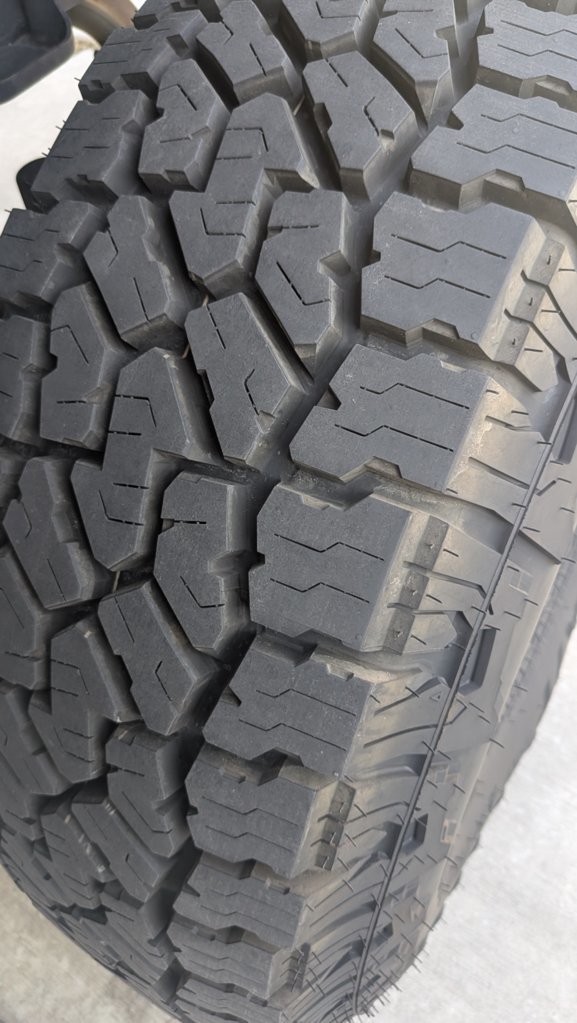

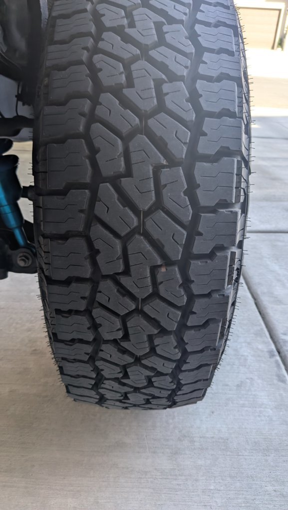

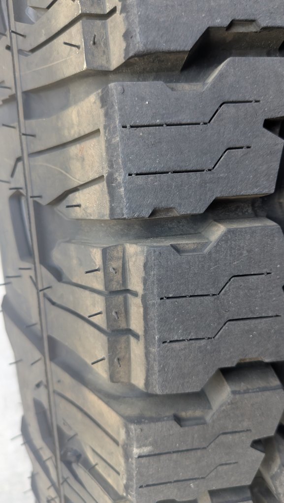

    Only have a few thousands miles on the tires and it's eating the outside edges of the fronts. The insides and rear have no issues.
    Any suggestions or should I just live with it ?
    If I am going to have tire wear, is the outside edge better or worse than other places?

    With that much negative camber, I don’t think that’s causing any outer tread wear. And more caster is never a bad thing, doesn’t affect tire wear either.
    You might try lowering the toe by about half the current amount. Aim for 0.05 or 0.06 and report back.

    Toe is too high. Lifted trucks should have no higher than .15 total toe. Also, there is no reason they shouldn’t be able to get your camber to 0.

    Thanks! I'll try the toe!
    I'm starting to think that maybe even the short week that I had the really bad alignment it could have caused the wear that quickly and that is what I am seeing. I hardly drove it but it still could have done some damage.
