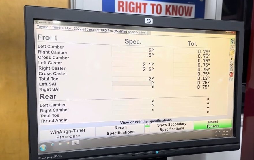

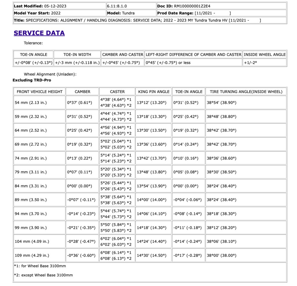

    Have a 2/1 Cornfed spacer lift on my 22 platinum 6.5box. Are people using the Toyota updated alignment spec from 2023ish, or using the Westcott specs on their site https://westcottdesigns.net/wp-content/uploads/Tundra-PRO-Alignment-Specs-Rev.-1-1.pdf ? Filename references the PRO but I believe it is for any 22-25 correct? I'm swapping to rear Dobinson springs +1" instead of the spacer prior to a camping trip and pulling a trailer, so going to get a fresh alignment before I head out.
    Or this as below from Westcott youtube channel

    Or this from toyota
