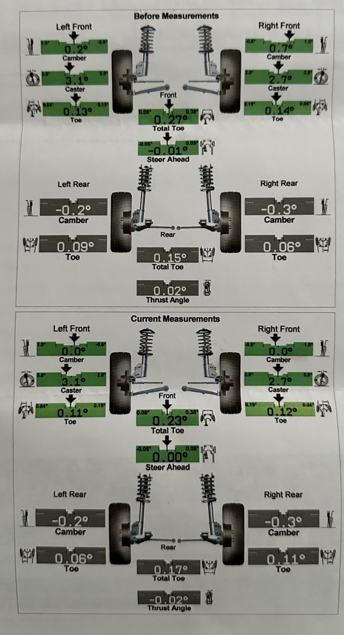

    Just wondering if my alignment specs look good after installing bilstein 5100 on middle setting? Just put 275/70/18 falken wildpeaks on. 2020 cm off-road. Thanks in advance!

    I’ll never understand why they always insist on positive camber. You want a degree of negative camber, one or one and a half degree of toe out.
    Looks “ok” but I’m picky.
    Problem is most people can’t drive and need the tire companies to sell them more products.

    Yep, get the camber closer to 0 or slightly negative.

    Too much positive camber. 0-.2 would be ideal. Caster could be a half degree higher on the right.

    I definitely don’t want my new tires wearing wrong. Will I be okay with this alignment or should I take it back?

    That much positive camber coupled with factory positive toe spec will wear the outsides faster than they should. Hopefully the shop isn’t a “green means good, so sorry” type.
    Does it pull at all? Typically more caster on left side will cause it to pull right.

    Camber close to zero or a bit negative. I had to take mine to a different shop to get it done, original shop was a "factory spec" only place.

    So I need to get it too a 0 degree camber? Anything else I need to change? Or everything else is okay.

    Match camber close to 0, and right caster should be a few tenths higher than the left.
    I have an ‘18 with 5100s on middle setting and set mine at 0.1° camber, left caster at 3.0°, right caster at 3.5°.

    Itll probably pull right

    It tracks fine as is.

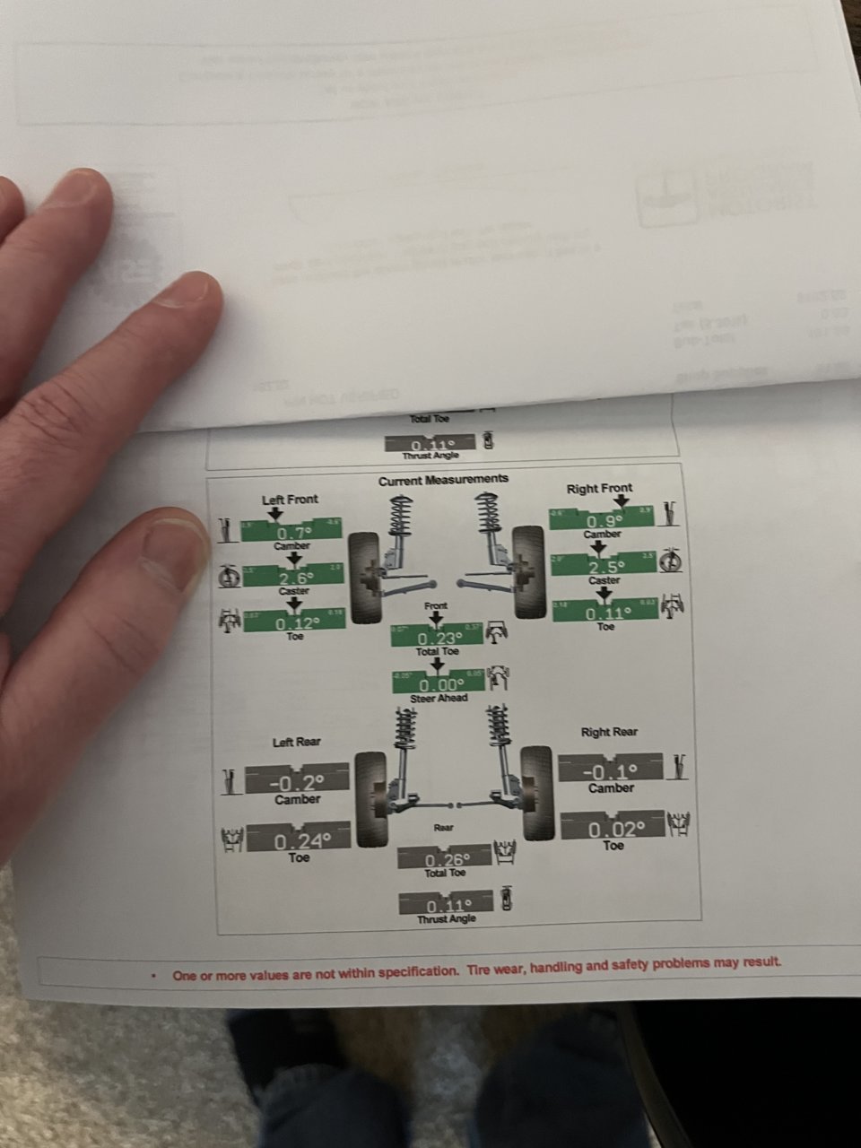

    Hi everyone. I saw this thread and wanted to get your opinion. When I look at my front tires it looks like the inside edge has zero contact. I took it to a shop and their response was “it’s within spec”. Any thoughts on if I should find another shop based on this alignment? The truck tracks straight. 2021 crewmax w/ 5100 middle setting.
