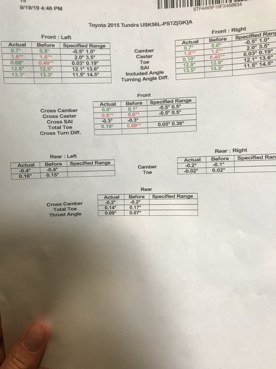

    Can anyone tell me if these alignment specs from Goodyear are good or bad? I have Bilstein 5100 on the highest setting and an add a leaf in the rear. Any help would be great! Thank you
