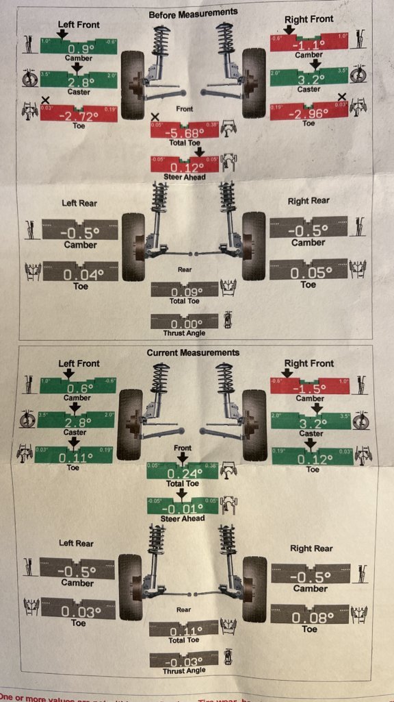

    This is my 2nd alignment in same amount of days.
    The steering wheel is barely off to right a fraction (much better than yesterday), seems to drive pretty straight (maybe a smidge pull to left, but maybe that’s the road crown.)
    Tech says the steering wheel can be straightened with a little toe adjustment. Also said getting it to Toyota specs wasn’t working (duh), so basically with some measurements he says he got it close. BTW, that’s a brand new MOOG Right Tie Rod End that they installed before the alignment.
    How do these final numbers look to someone much smarter than me?

    I'm not the smartest, but it doesn't look like they adjusted anything besides toe. Caster is the same as before, camber is barely different and maybe a side effect of changing the toe. The camber is still off on the front right and by a decent amount. To me it looks like they just threw a wrench on the tie rods and that was it.

    Oh man, I know this is posted everywhere on this site and others, but here we go again. You're vehicle may vary some, but these are proven starting points for good wear and handling:
    Camber: Between 0.0 and +0.1 (matching both sides)
    Caster: As mush as possible without sacrificing camber or causing cross caster pull
    Toe: +0.12 (matching both sides) for a total toe of +0.24
    I'd be going back and asking for everything to be aligned appropriately.

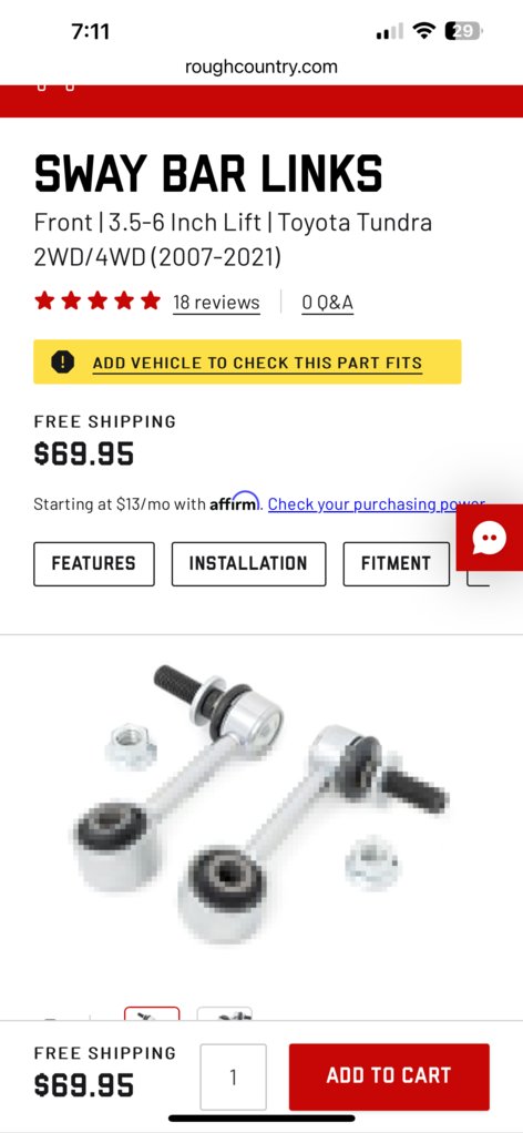

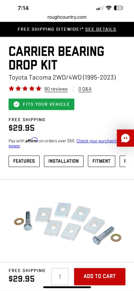

    I do have modified UCAs, extended sway bar links, a different drop and I am adding a carrier bearing drop tomorrow.

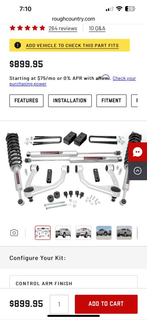

    what uppers do you have? Did you buy a whole rc lift kit that came with everything you have mentioned?

    Yes, plus the carrier bearing drop kit.

    Why don’t you send us the link to the lift kit or uppers, not much we can do with so little info

    FREEK
    FREEK [OP] New Member
    Jan 3, 2019
    #23916
    95
    Darren
    Olathe, KS
    2019 Tundra Limited Crewmax 4X4
    Here’s the whole shahbang!
  21. Apr 4, 2025 at 5:23 PM

    Hmm I have their old style steel tube uppers and if I remember right my alignment numbers are pretty decent, but I’m only running a 3” lift
    what alignment shops have you tried?
    from RC’s website the reviews seem to have positive view on their alignment numbers so I would try a different alignment shop; but that’s the hard part, they’re a diamond in the rough

    Looks like they did the "toe and go". Most alignment shops don't align anything but the toe. They might try to BS you and claim the cam bolts are seized, which is possible. Did you loosen the cam bolts on the lower control arms when you did the lift?
    The numbers arent terrible. Forget all the people saying you need a new lift and tie rods. You just need an alignment tech that isnt lazy, getting rushed by corporate, or knows what numbers would work for you without looking at the stupid screen to see if it's red or green. Rough country may have engineered some alignment into the new arms for the lift. Might be a good thing they arent adjustable. I took my adjustable SPC arms to the local alignment shop and showed him the directions. It was like trying to show rocket science to a dog. Complete waste of time and money. They fucked up my alignment and my tires.
