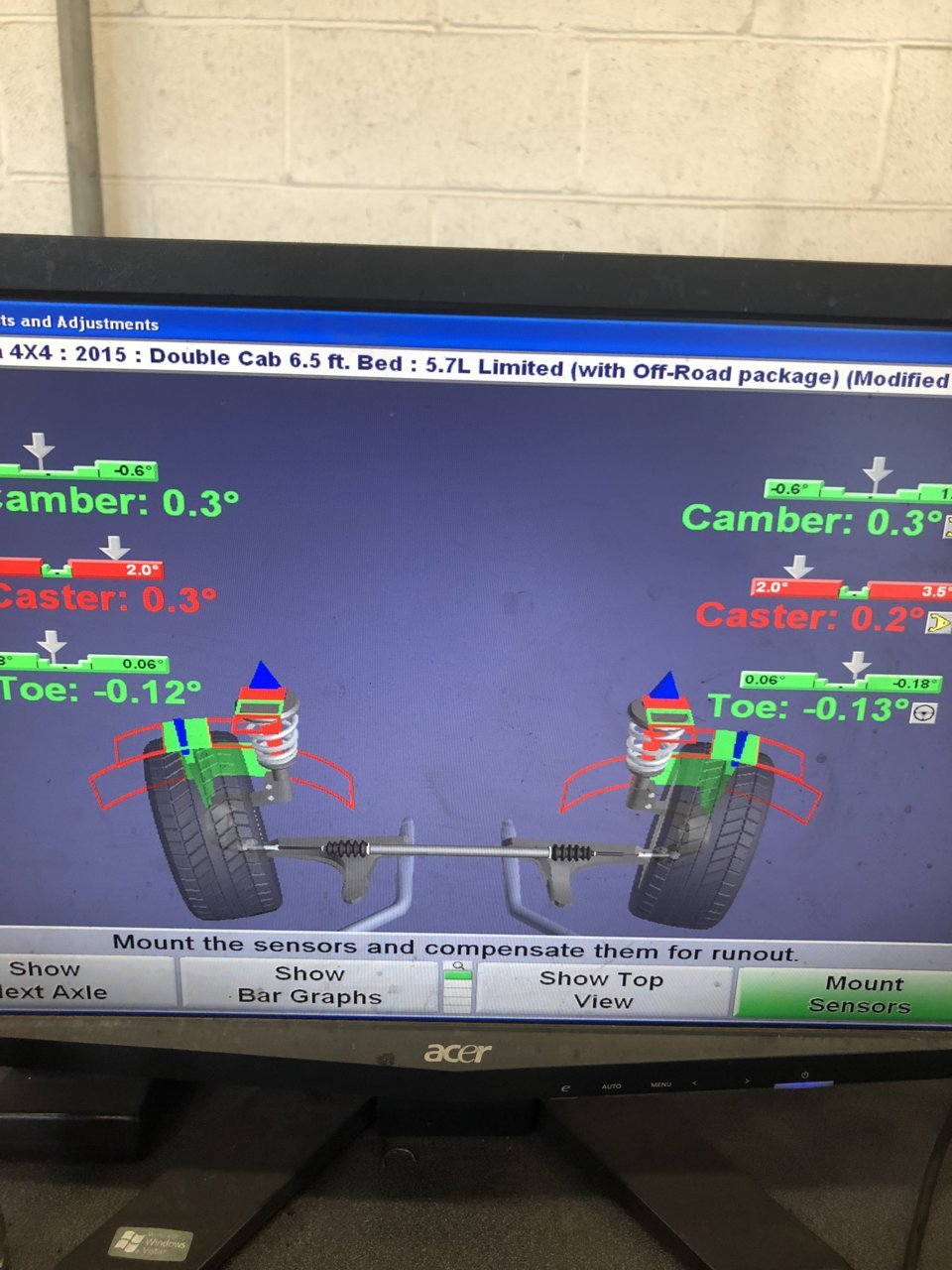

    Tech says this is the highest the caster will go. Is he doing something wrong or do I need UCA’s?

    Will I have tire wear issues if I leave it as is? Drives fine,straight

    Different shop. Opinions?

    Seems to drive good. What’s ideal numbers in a perfect world?

    Definitely looks better. I like higher caster and am experimenting with lower camber. My last adjustment put me at 0.0 degrees camber (I wanted to go slightly negative, but they couldn't get there). I was previously at 0.2 degrees camber and had outer tire wear over time - but, I don't run a sway bar and tend to drive more on the aggressive side. I have aftermarket UCAs and am at around 4.5 degrees caster.

    What’s your lift setup?

    3.25" up front. I run MCM UCAs.
  8. Sep 21, 2018 at 4:01 PM

    Anybody know why I’m showing a “toe” on the left rear of 0.39?
