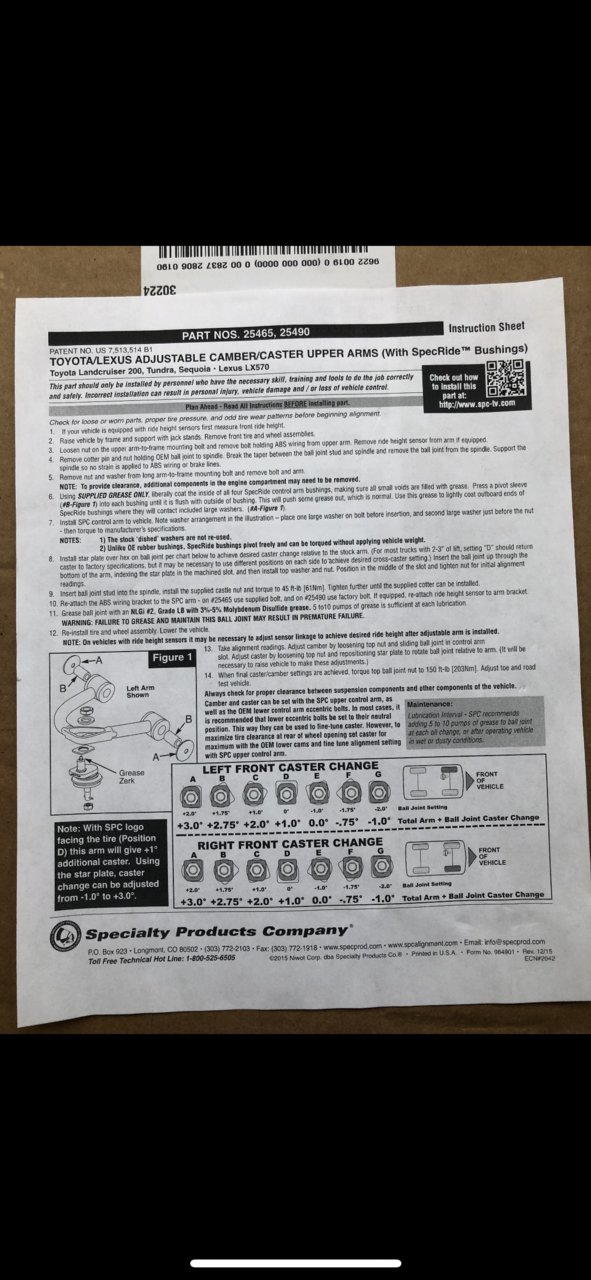

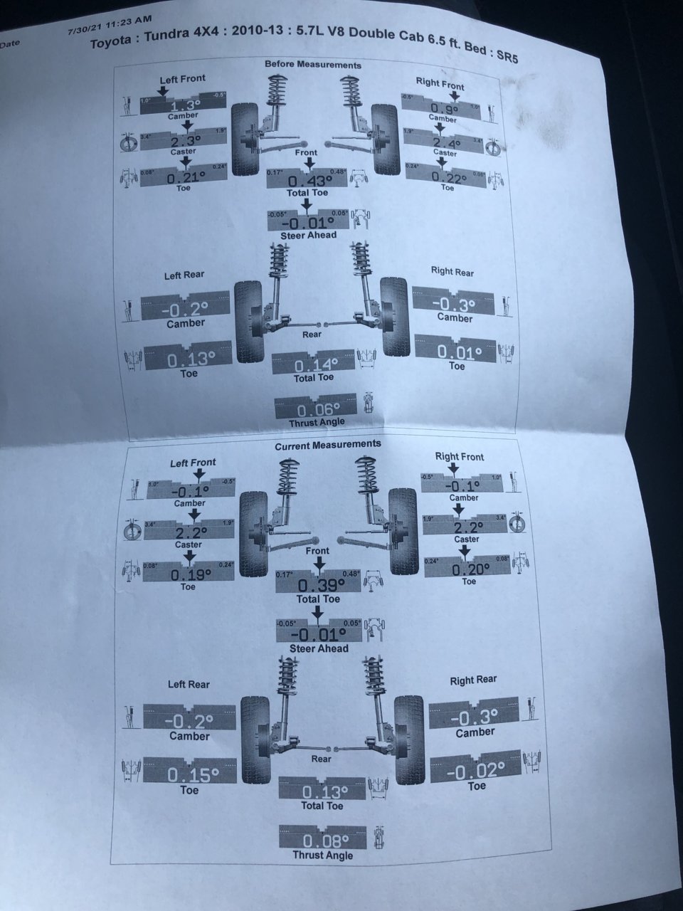

    Sorry to hijack post but was wondering if anyone could give me input on my alignment? Sorry its not in color. I asked shop to give me max +castor on my UCAs to allow for bigger tires later. How’s this look?
    trucks riding and driving better than ever now with 2.5 ome lift and spc UCAs with even tire wear.

    Pretty good. Toe is a little high. May see some outer edge wear. Just keep an eye on it.

    Thanks!! What’s the ideal spec for total toe?

    Everything I’ve seen suggests a total of .15-.2.

    ToyTec advised I should be able to get 4° +Caster on Left and Right front.
    I specifically asked my shop for Max Fwd Caster on the SPC UCAs to accommodate for larger tires.
    My castor appears to be the same as my original alignment was with factory UCAs on the alignment sheet I attached.
    looking at SPC’s instructions and my truck — My right front arm is currently set to either level E (0.00°) or F -0.75°)
    looks like they didn’t set any positive caster with the UCAs like I asked..
    Am I missing something?

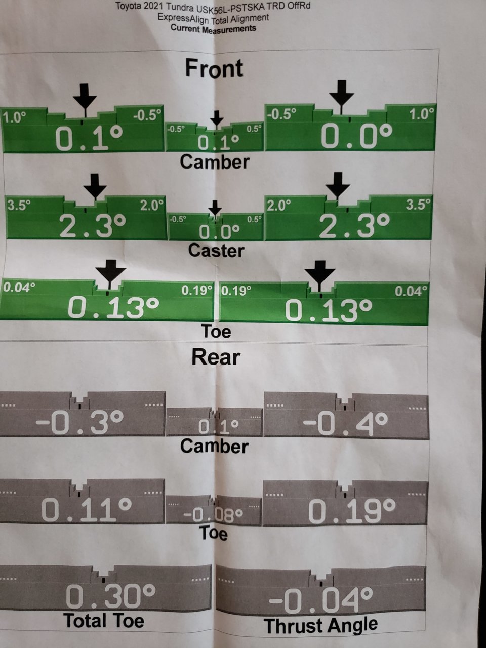

    I was able to get the alignment sheet. Shop said there is nothing they can do about the slight pull to the right. They recommended me to another shop where they can do it the old school way with a string.

    Are you sure it's not the crown in the road? Most roads the truck will drift to the right so water won't pool up. That alignment spec looks pretty good if it actually came off your truck. Sounds like they told you to fuck off nicely :rofl:

    That is correct. I have been told you can get at least 4 degrees with the help of the SPCs or more. I have SPCs too though and I only settled for 2.3 degrees caster. I had them max my caster out at LCA cam bolts which pushed my wheels forward towards front bumper (to accompany larger tires soon)
    I have been told that if more caster was now applied with my SPCs then it would push my wheel back towards cab, which I don't want.
