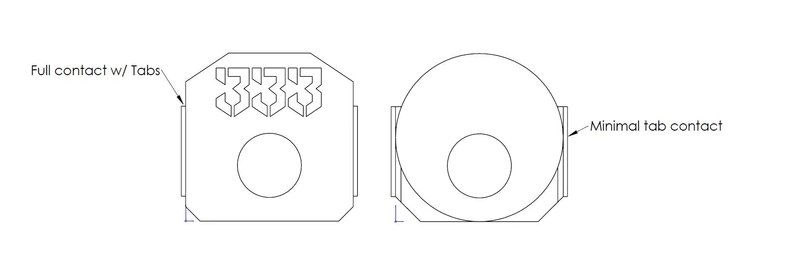

    Did some reading, I understand that these and the Bison octagonal cam bolt kits require aftermarket adjustable UCAs to get full precise adjustability. Ended up ordering from McGeorge Toyota for $109.29 on 2 of each bolts.

    Requires an adjustable UCA? Works fine on my truck and other yotas my friends have, neither of us have an adjustable UCA. But these are really of value if you wheel enough to knock out your alignment and taking it to the alignment shop is straining your wallet.
