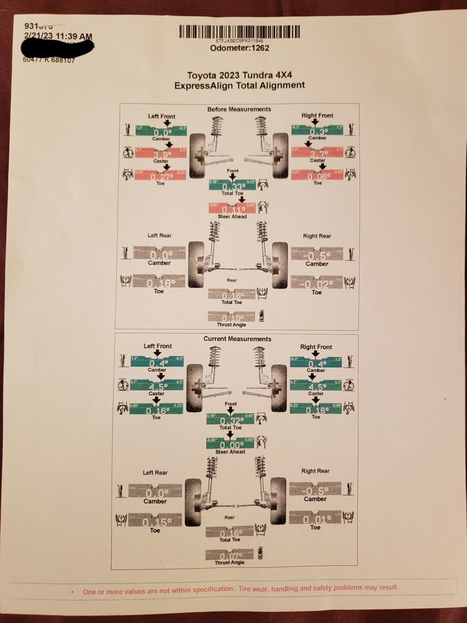

    Sitting at about 1300 miles, my OCD finally got the better of me and I took the truck in for alignment as I can't stand an off-center steering wheel. I don't have the before/after printout in front of me, but I'll post it later. Almost everything was out of spec.
    Anyway, everything was brought back into spec, wheel is centered, and truck drives straight. Great. Several days later, I actually get a chance to drive on the highway and experience a shudder or buffetting at 65+. I Originally attributed it to wind because we had 20-30 mph cross winds that day. Unfortunately, I got out on the highway again this morning and it's still there, maybe even worse. I rotated the tires front to back to see if it might be a wheel balance issue, but that changed nothing - still shuddering.
    Anyone dealt with similar? Could it be an unbalanced prop shaft? Maybe they didn't torque something appropriately with the alignment?
    We were planning a road trip down to Wyoming this week, the timing couldn't be better.

    Good thought. The shudder only dissipates when the speed gets down to the low 60s, though. It looks like the steering wheel isn't straight anymore, either, which is surprising because I've really been babying the truck.

    I wasn't charged for the original alignment. The service advisor remarked on the printout that they confirmed the wheel off center before the alignment. The truck didn't pull before the alignment, either, but I'm planning to keep the tires as summer highway tires and didn't want them to wear unevenly.
    I dropped the truck off at the dealership again this morning, so I wasn't able to check for play in the steering. That was a great idea, and I wish I'd thought of that when I had the truck up in my garage.
    Finally, I drove more than 50 miles on different highway and the shudder was always present, even on roads I know to be straight and even.
    I'll update the thread with whatever resolution the dealer comes to, if any.
