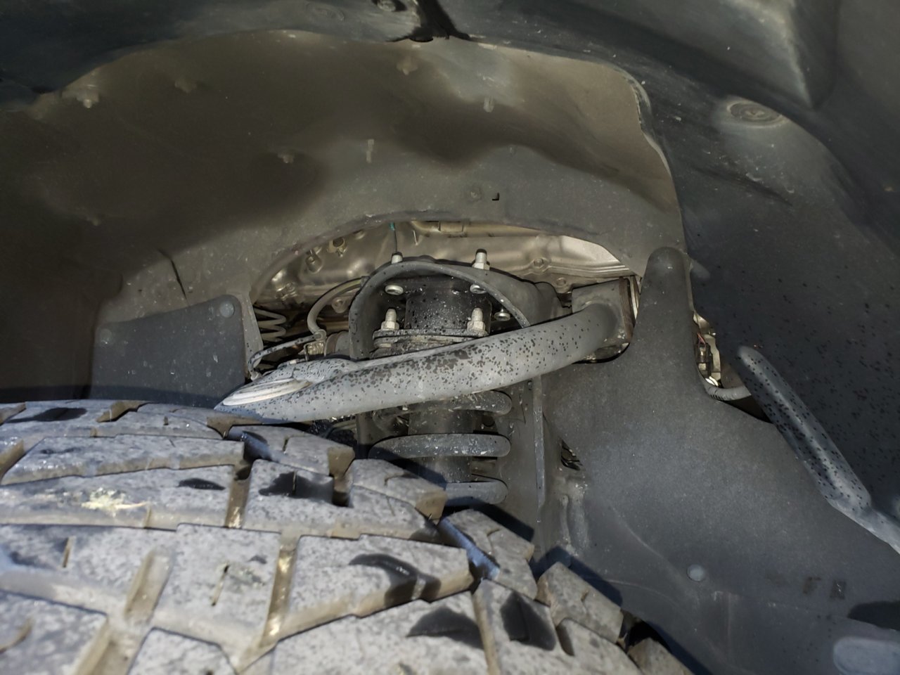

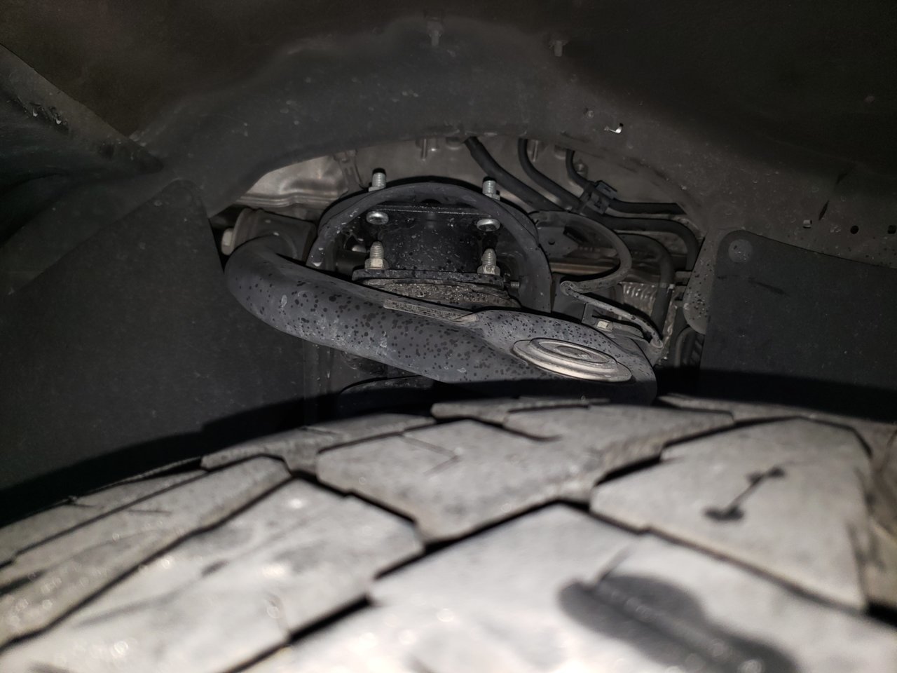

    Do you have a current picture of the UCA’s? Let’s how angled they are

    I can snap a pic shortly. I just wasnt sure numbers wise where it should be.

    The UCA angle isn’t that severe. I’d say try another shop before you drop money on new ones. I had a stripped cam bolt on my 2018 that wasn’t allowing the alignment to get dialed in. Got new sps cam bolts for both sides and all was good. The OEM bolts are crap. Aftermarket bolts allow for more adjustment.
