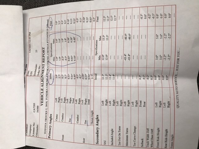

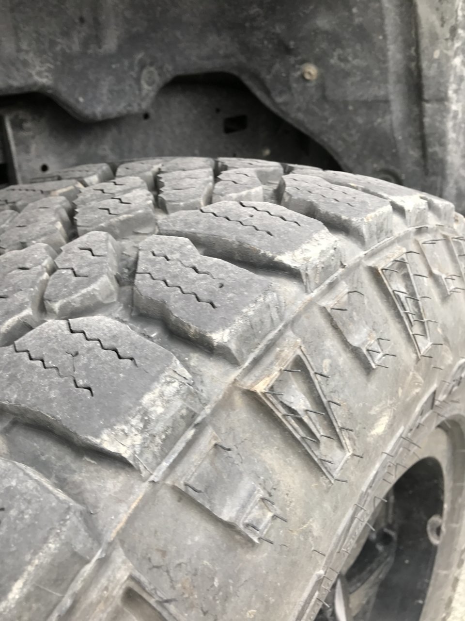

    I had my wheels aligned since this post and thought I was good. I have heavy feathering in the front. Specs attached. I’m wearing tires bad. Any advice is appreciated. Thanks

    The second sheet is very hard to read, but it looks like your toe was out of whack prior to that alignment, which could cause abnormal tire wear. Interesting that literally ever measurement was completely different between the "final" of the first, and the "initial" of the second.
    As for your visual camber, it's showing 0.5º positive camber on both fronts (after the fact), but that is within spec. The only alignment spec that is "ok" to be out of spec is caster, and only if it is higher than spec (as you lift the vehicle the amount of positive caster you an achieve decreases, which is one of the reasons UCAs add caster)

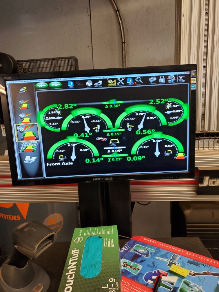

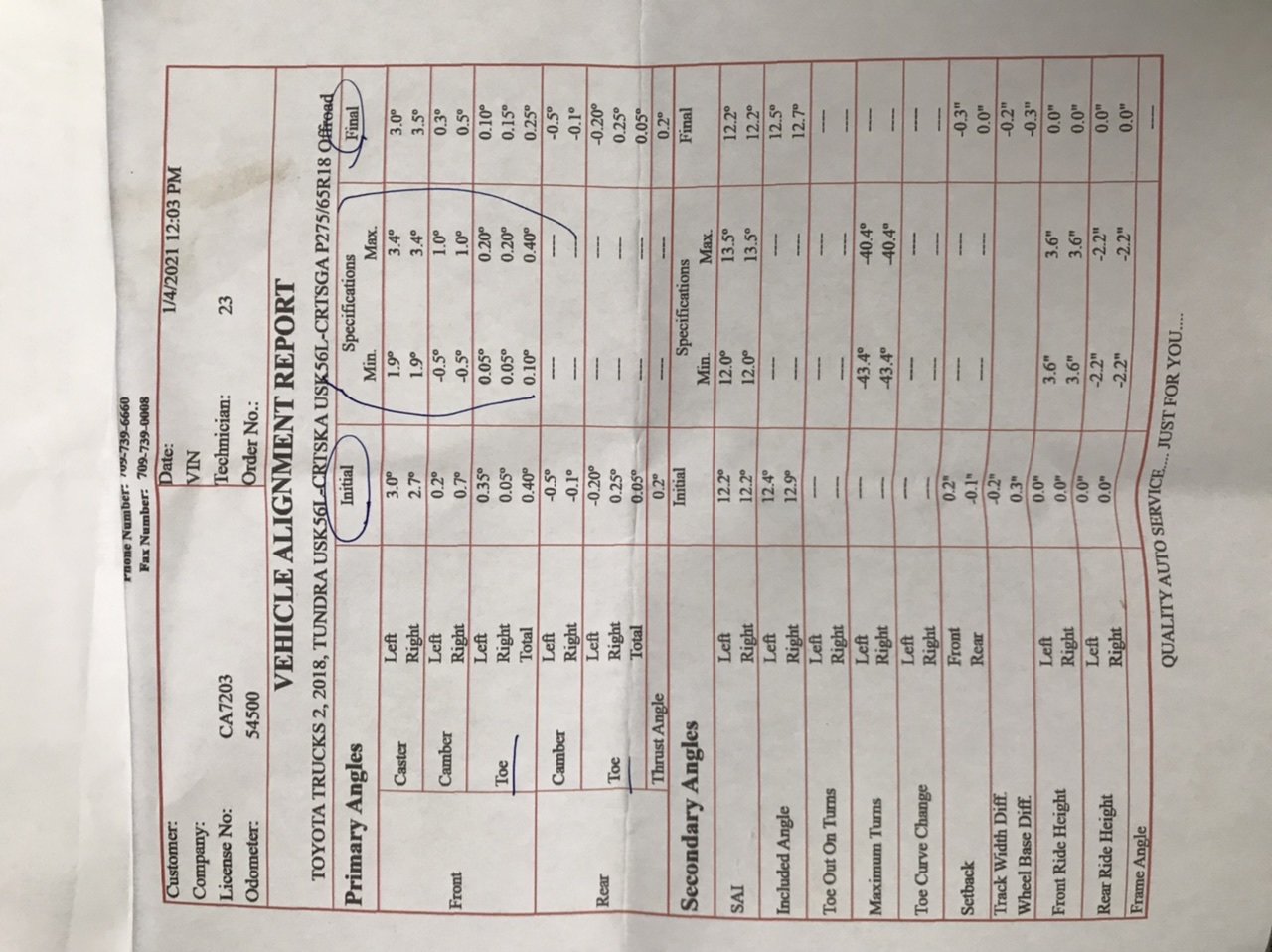

    Thanks for the response. Took another pic. Hopefully this is better. I can’t figure this out. The inside of the tires are perfect.

    Is there more wear on one side than the other (left vs right)? The Initial toe on the left is really out

    There is no noticeable difference. Would the caster be a wear factor on turns. My BFGs KO2s wore perfectly flat. Then I lifted the truck and put new wheels and Duratracs on the truck. I would have thought its my driving but the BFG have zero feathering. I have had a second alignment done but it’s not far from these specs. I’ll see if I can find it. Pic of tire attached. I just rotated them after $5k.

    Yeah it’s weird. Handling is fine but when turning sharp you can feel and hear the heavy lugs.

    That’s probably the high camber. And that will cause the outside of tires to wear faster. The camber should be closer to 0.
    My camber is at 0.12 and I can feel the lugs of the ridge grapplers on sharp turns.

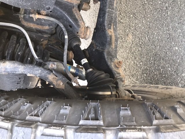

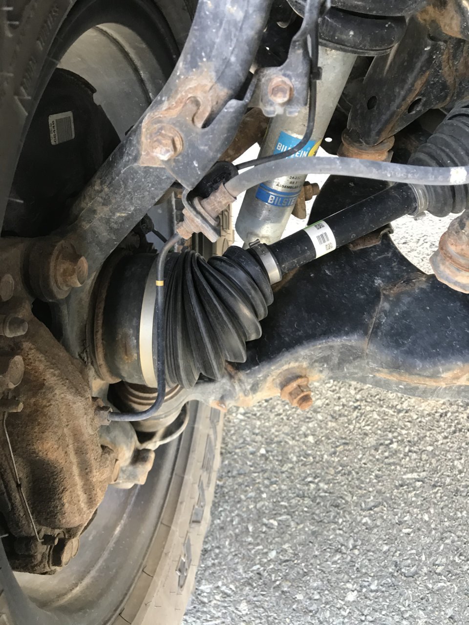

    I can’t figure it out. I’ve uploaded a few photos. The CV angle when the wheel is at full lock looks off and when the wheel is cut it is not level with the pavement at all.

    Looks normal to me in the turn pic.
