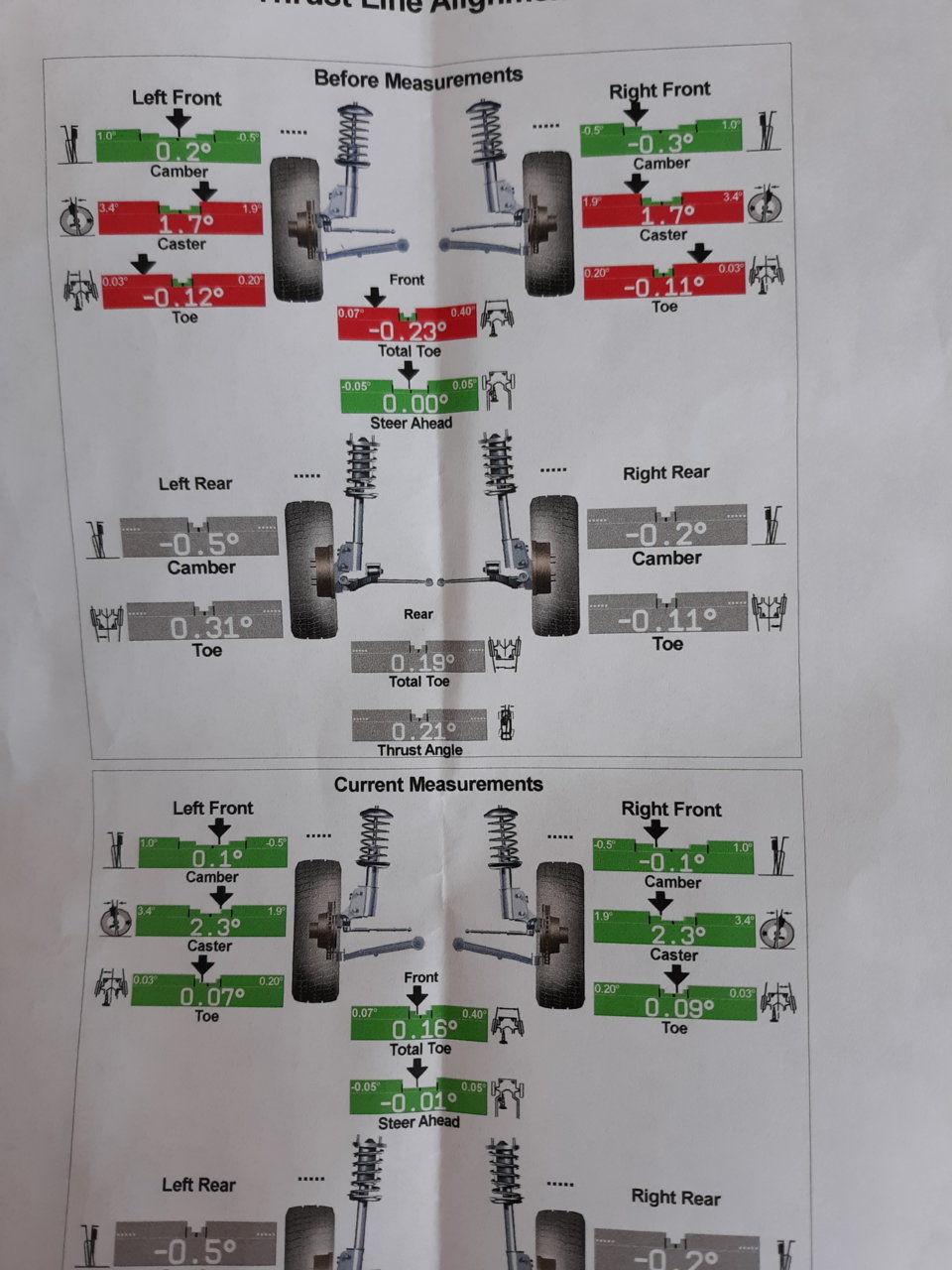

    Wondering how these numbers look to everyone?

    Green is good right...;) How’s the change in ride?

    100%. The latest/greatest machine might show all's good, but a veteran will know how to make it good in actuality. Just my experience....

    Your numbers are very close to mine. I have the same suspension setup. One thing after my alignment was the steering wheel was Very slightly off center after the alignment. Truck tracks straight, etc. so it was Not enough of a problem that I wanted to fool with taking it back to the shop.

    the camber is way too high. you are seriously going to wear the outside of your tires. the camber should be much closer to zero (-0.15 to +0.15).
    toe is fine. caster is ok. it could be a little higher, but if the truck drives fine, then it should be ok.

    So two people say good and one says camber is way off...alignments are a little like voodoo.

    Green does not mean go. Stock spec no longer applies on a lifted tundra.
    All you got was a “toe n go”.
    Your camber and caster didn’t change from initial to final. So they did nothing to actually adjust your alignment. They literally only set the toe, which any monkey with a wrench can do. It’s a simple adjustment on the tie rod. You got ripped off if you paid for an alignment.
    Camber is too high. Should be closer to 0.
    caster is ok. Though it’s going to change once the camber is set properly. So if the technician doesn’t know what he’s doing he will say he can’t get in “in spec”
    Toe is a little high. Ideally, total toe should be around 0.15.

    These 2 guys are correct. Camber too high, caster too low. Green goes out the window after lifted, especially on caster. All they did was a “toe and go” alignment. You got ripped off.

    So I should be asking for:
    Camber - +0.15
    Caster - As a high as possible while still keeping camber near +0.15
    Toe - +0.07 per side or +0.15 total toe
    Dumb question - is the rear adjustable at all? What's up with a positive toe on one side and a negative toe on the other?

    That would work. Also, read this
    https://www.tundratalk.net/threads/...read-w-links-and-shop-recommendations.112656/
    Rear is not adjustable.

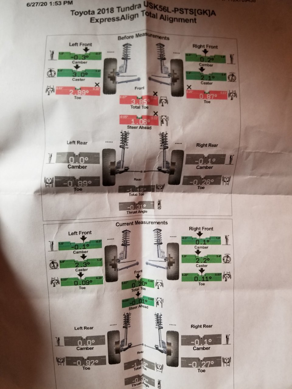

    Here's mine from yesterday after getting 295/70r18s installed. 6112's @ 1.9 setting with a driverside shim. Seems good so far.20200914_084217.jpg

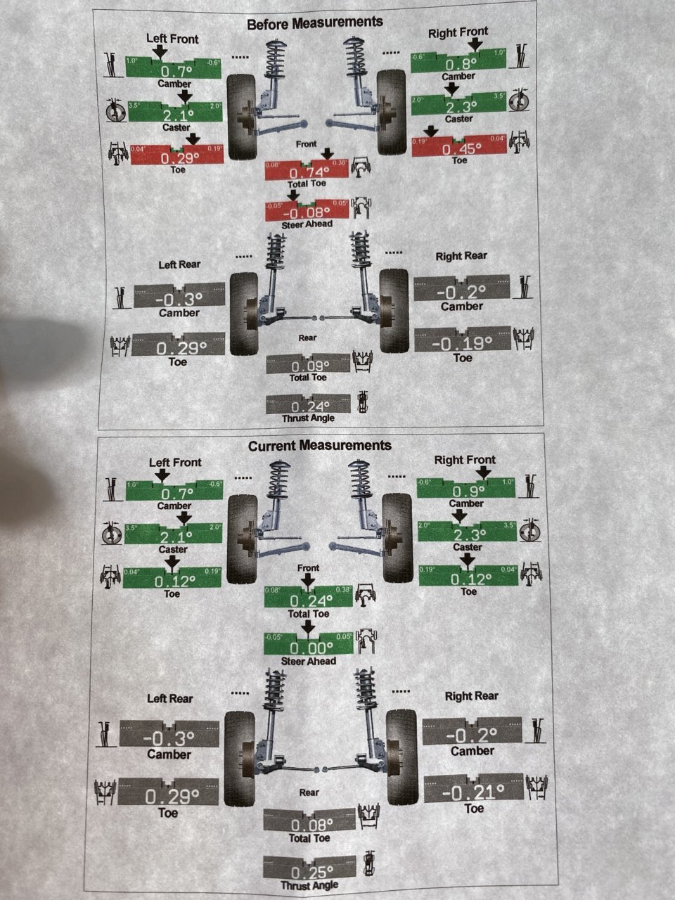

    Jumping in. How does this look? I have staggered - 1.9 drivers side/ 1.3 Passenger.

    Do you have a before and after photo you could share?
