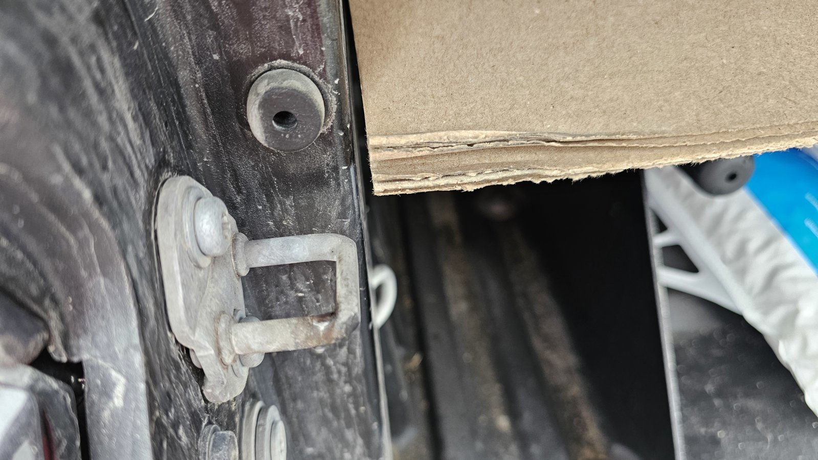

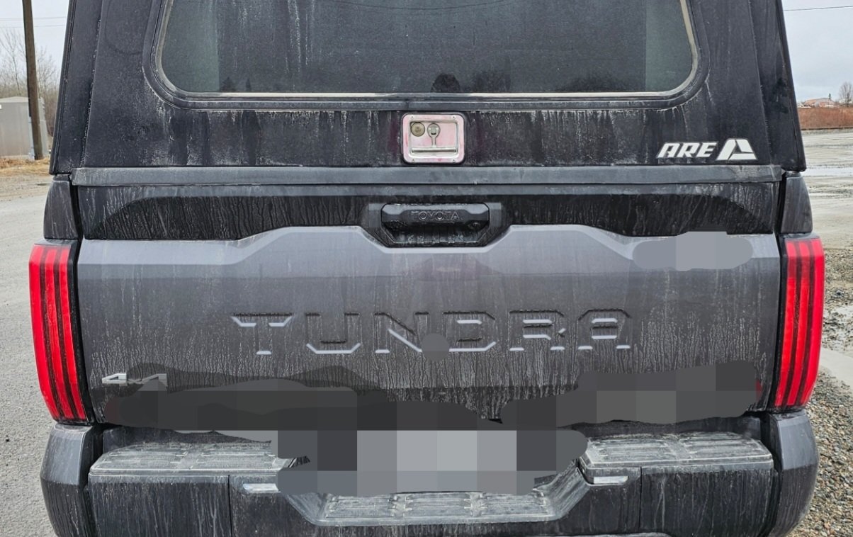

    Heres the photos you can see if it wasnt for the tail gate, the panels would split. Please note that i did not have gaps before. I am trying to get my day 1 picked up photos from the company teams platform but i dont remember exactly when i posted them Screenshot_20240501_022900_Gallery.jpg 20240430_165459.jpg

    Are you sure you only loaded one extension ladder on top of the rack and one 8ft ladder? That kind of weight wouldn't do anything to your side bed panels

    Yes I got one Louisville 24ft and 1 Louisville 8 foot
