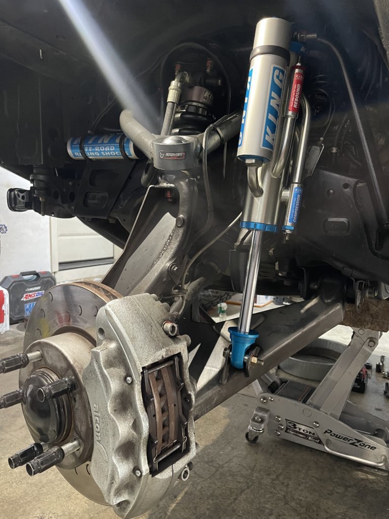

    Should be much longer than the OEM setup- We've run these hard over the last few years with hardly any wear.

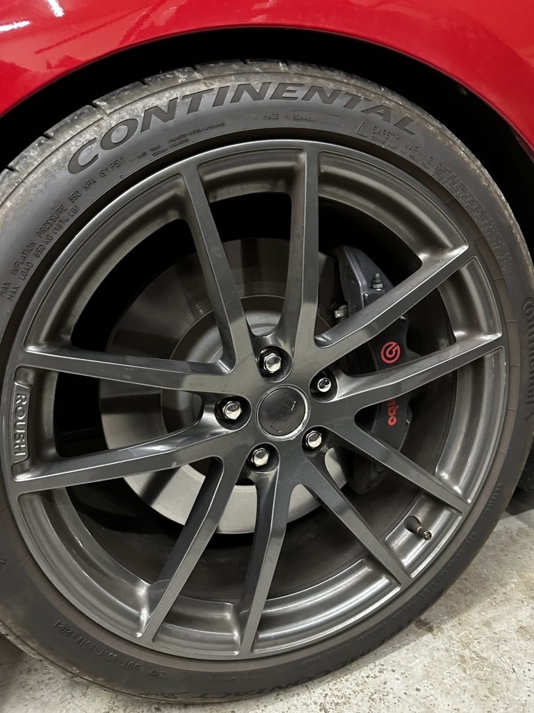

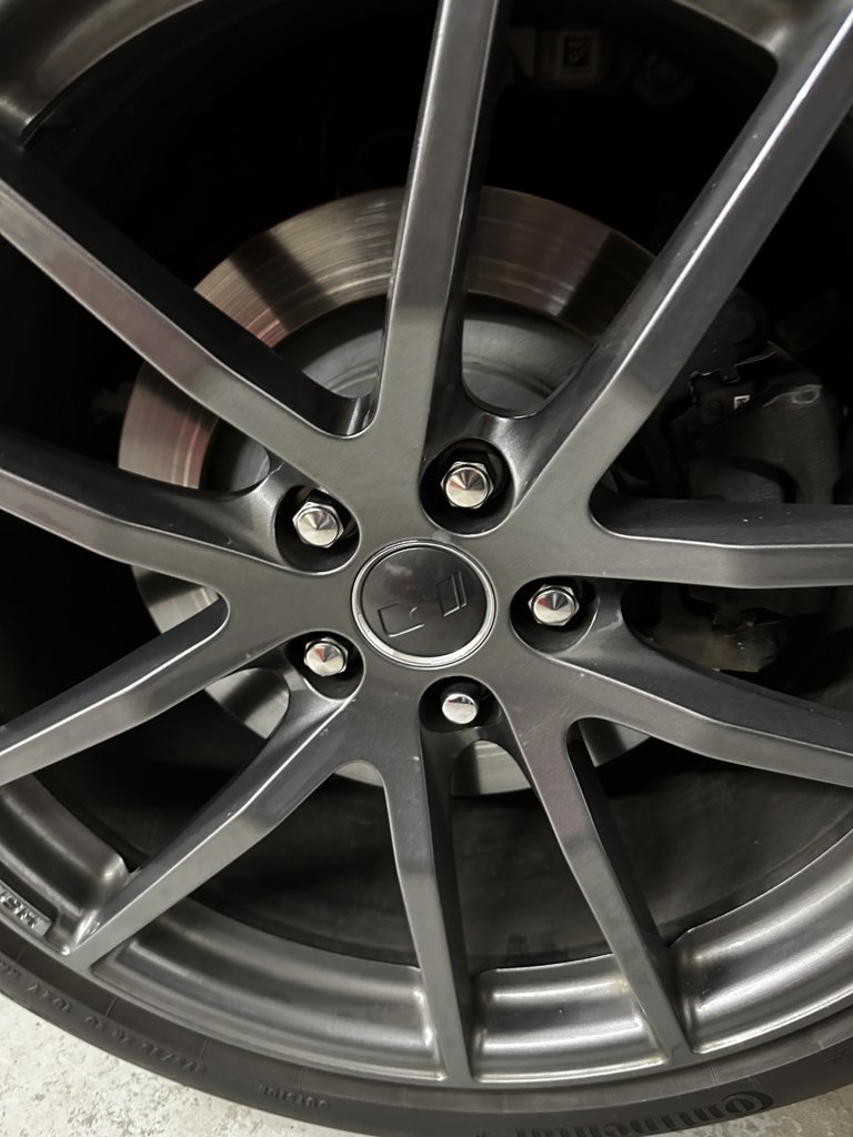

    I have a 6 piston BBK up front on my Roush, factory GT rears. I never drive this car with traction control on.
    front at 10k miles
    Rears
    You be the judge. I am currently looking for a rear GT350 rears brake system. It's about 4500.00 for the conversion.

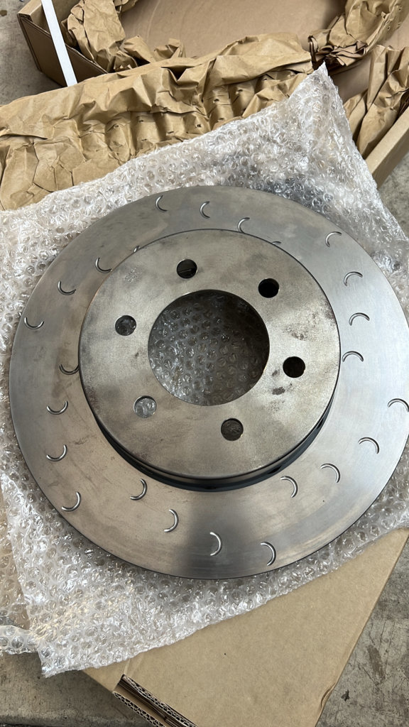

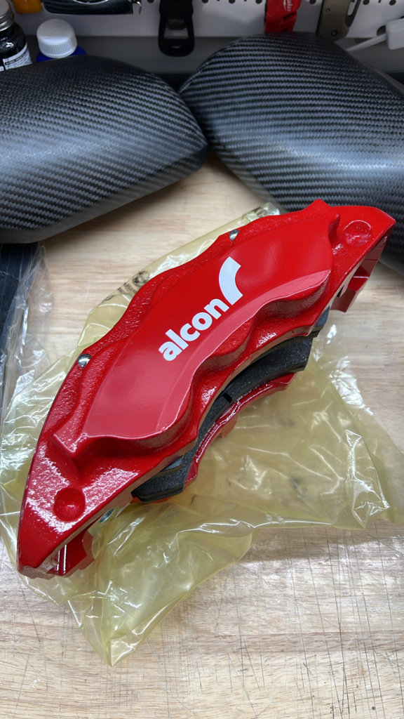

    This gave me a good laugh. No pad out there that I’d bet any money on that provides more braking torque and shorter stopping distance than a BBK. Then there’s also the issue of brake fade. No pad is gonna help resist that with factory caliper and rotors. It’s also childish to think that these top BBK companies aren’t developing high performance compounds for their pads as well.
    I’ve also used EBC pads and cryo rotors, albeit on my old FJ. Suffice to say, I was very underwhelmed and experienced little to no improvement over stock.
    Anyway, got my alcons yesterday and aiming to get these on in the next couple of weeks when I have some time. Unfortunately, no rear kit from Alcon yet, but they don’t have any plans of offering one when I asked. Gonna have to be stock rears until I figure something out. Note, I’m currently on wilwood’s BBK, so I’ll be able to experience first hand the difference from one 3rd gen BBK to another.
