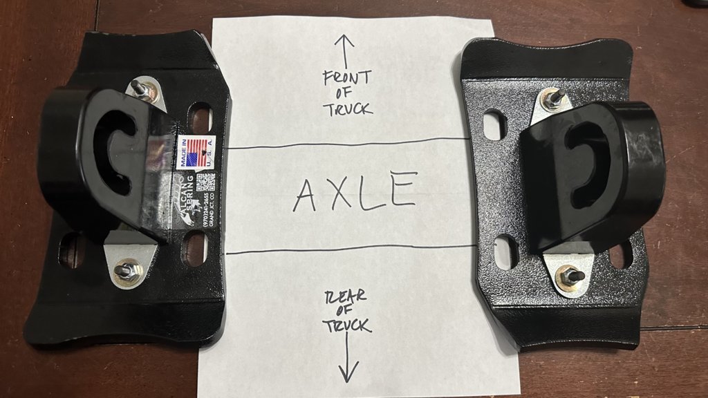

    I searched all over the interweb trying to find installation instructions for these, to no avail. Alcan's site says their "instructions" are easy to follow...if they even send instructions (I didn't get any). After talking with Lew at Alcan, he said they are not side-specific, HOWEVER, they are tapered on one end to allow shock clearance during articulation, so the direction you place them front to rear matters since the Tundra's rear shocks are offset. So since the driver rear shock is in front of the axle and the passenger rear shock is behind the axle, here is the orientation:
    Installation was simple enough, though to get to 90 lbs of torque to tighten the u-bolt nuts with the limited space under the truck, be patient, and bring all of your might!! Otherwise, save some hassle at the beginning and remove the tires.
    Driver side looking from rear bumper:
    Passenger side looking from rear bumper:
