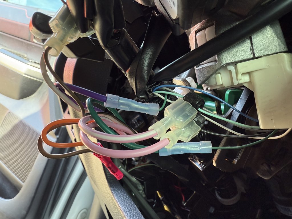

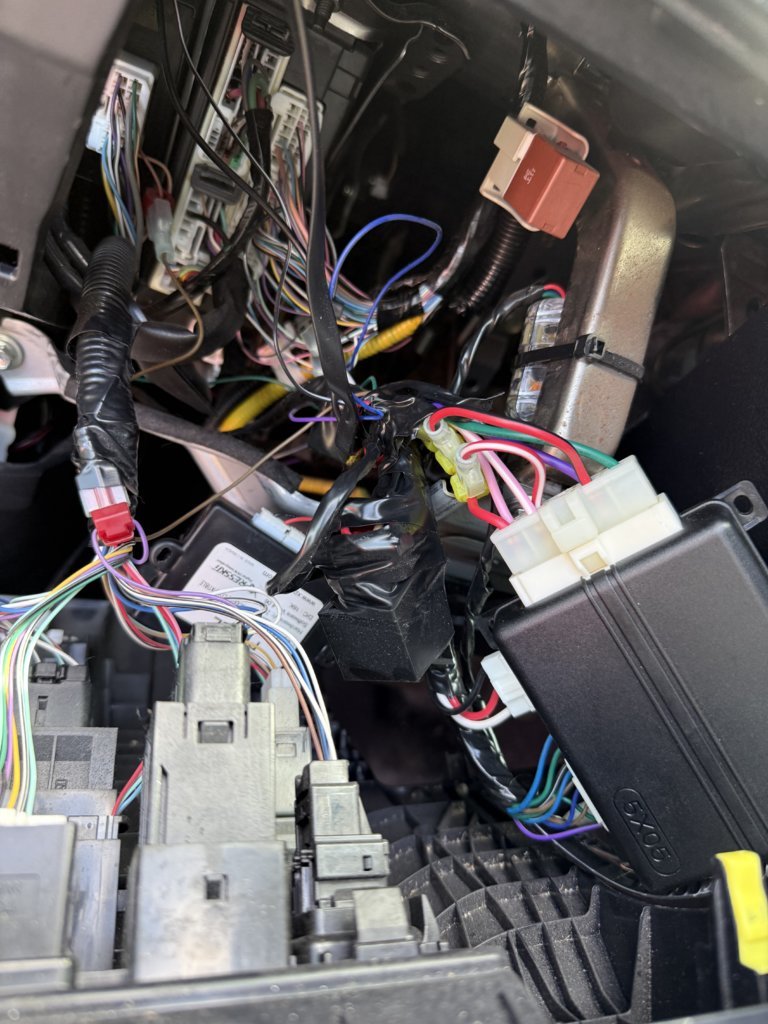

    My tundra came with an alarm system and remote start installed when I first got it. Though it has been fine over the years it’s overly sensitive and I just want it gone. I traced all the wires coming from the brain and the only two sections I noticed they cut my factory harness was
    a. Under the steering column. The thicker aftermarket purple and green wires are connected to my factory skinny green wires. Do I need to reconnect the two factory skinny green wires pictured?

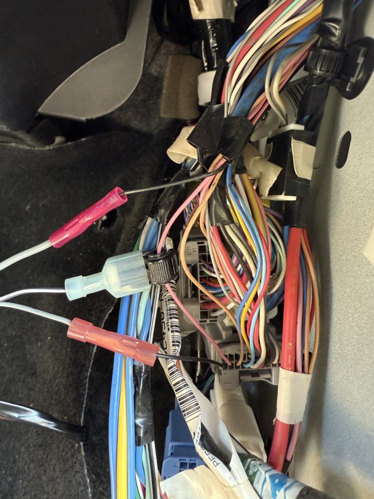

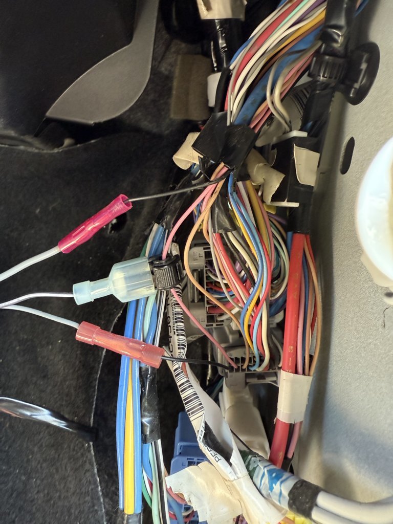

    b. Passenger side underneath dash same thing they cut the factory black wire and connected aftermarket two grey wires. I’m gonna assume I need to reconnect the factory black wires?
    Every other connection from the aftermarket wiring was just T’d off and is easy removal.

    Thank you, I had a hard time finding a diagram. Not only is the sensitivity an issue but even if I press the lock button one too many times the alarm just starts going off. The alarm system kind of just freaks out on random things.
    I brought up the two spots where the factory harness was cut because I wasn’t sure if I should reconnect the wires as I didn’t want to fry my harness. I know there is a lot smarter people on here that can chime in ha. The one downside to where they cut the green wire under the steering column is they didn’t leave my a lot of room to splice and reconnect them.

    It shouldn’t be that difficult to remove everything.. unhook the battery first and foremost..
    Going wire by wire, unhook or cut.. reconnect the factory wire of the same color that they cut. Solder and heatshrink..
    Take your time. One wire at a time.. you’ll have it out in no time..

    If I need to add wire because there factory wire is cut too short, do I just need the same gauge wire? For example in the picture the little green wire doesn’t have a lot of extra wire to reconnect.

    Just looking at some wires that were cut or tapped doesn’t give me the warm fuzzy to really provide much input… though it looks fairly straightforward.
    The right thing to do is trace back the wire in question both directions to determine the connector number and terminal (pin) number it is, and then search the EWDs to find that connector and terminal and confirm the wires are indeed the same wire that has been cut.
    From there, use a good means of splicing and you’re all set.

    Thanks to everyone that responded. I was able to take it all out and reconnect those two factory wires. The factory fob works again and now I won’t have that annoying viper alarm anymore. Lost remote start for now, but I did save $180 on having a shop do it.
